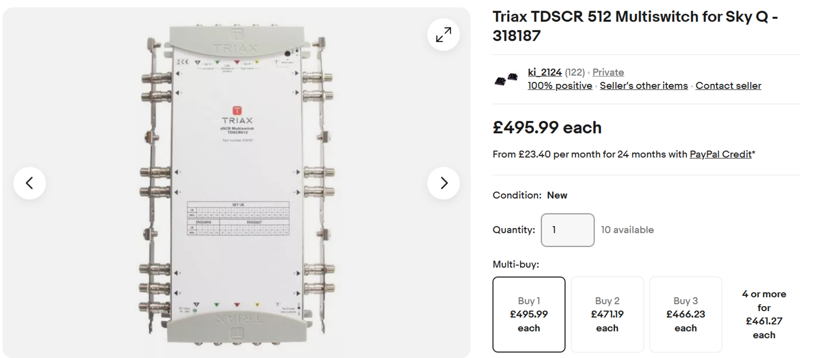

The answer to all of this is a thing called a multiswitch. There are versions of these that also solve the 'Legacy + SkyQ' combined system issue. The catch is that they're a whole lot more expensive than a simple Octo LNB.
Yep, it's £500. You can shop around of course, but you'll still be looking at north of £400~450 in a lot of cases.
You're probably wondering why so expensive. The answer is that this is a smart switch. You can hang a mix of legacy receivers and a Q receiver off the outputs and the multiswitch will sort out getting the correct signal to each, and it does it all in one box. This one has 12 outputs, so you can have recorders in some rooms. This includes the new generation Freesat 4K boxes where they'll take a wideband signal and allow watching one channel wile three recordings overlap.
The LNB for this system isn't the standard 'Sky' Quad. For a multiswitch you need a Quattro LNB. It's about the same price as a good Quad, but instead of four tunable outputs it has outputs fixed in the four states. This is how it's able to mix and match its outputs to meet the needs of any receiver.

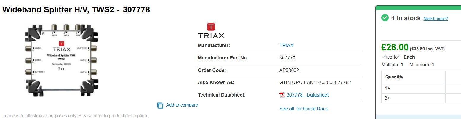

What's different about WB is that it can be split. So long as the power is blocked from a second recorder, then splitting the two outputs to create four (2x H, 2x V) isn't the problem it would be with a legacy LNB. It would just take a bit more care than passive splitting an aerial signal because the attenuation losses increase with frequency.
At this point I'm sure someone will pop up with a link to a multi output WB LNB :ROFLMAO: That's okay. Satellite stuff is something that I don't do a lot of, particularly since Q arrived and the gear remains on rental rather than ownership transferring to the homeowner like it did with legacy Sky systems. This is all on the periphery of my knowledge range.

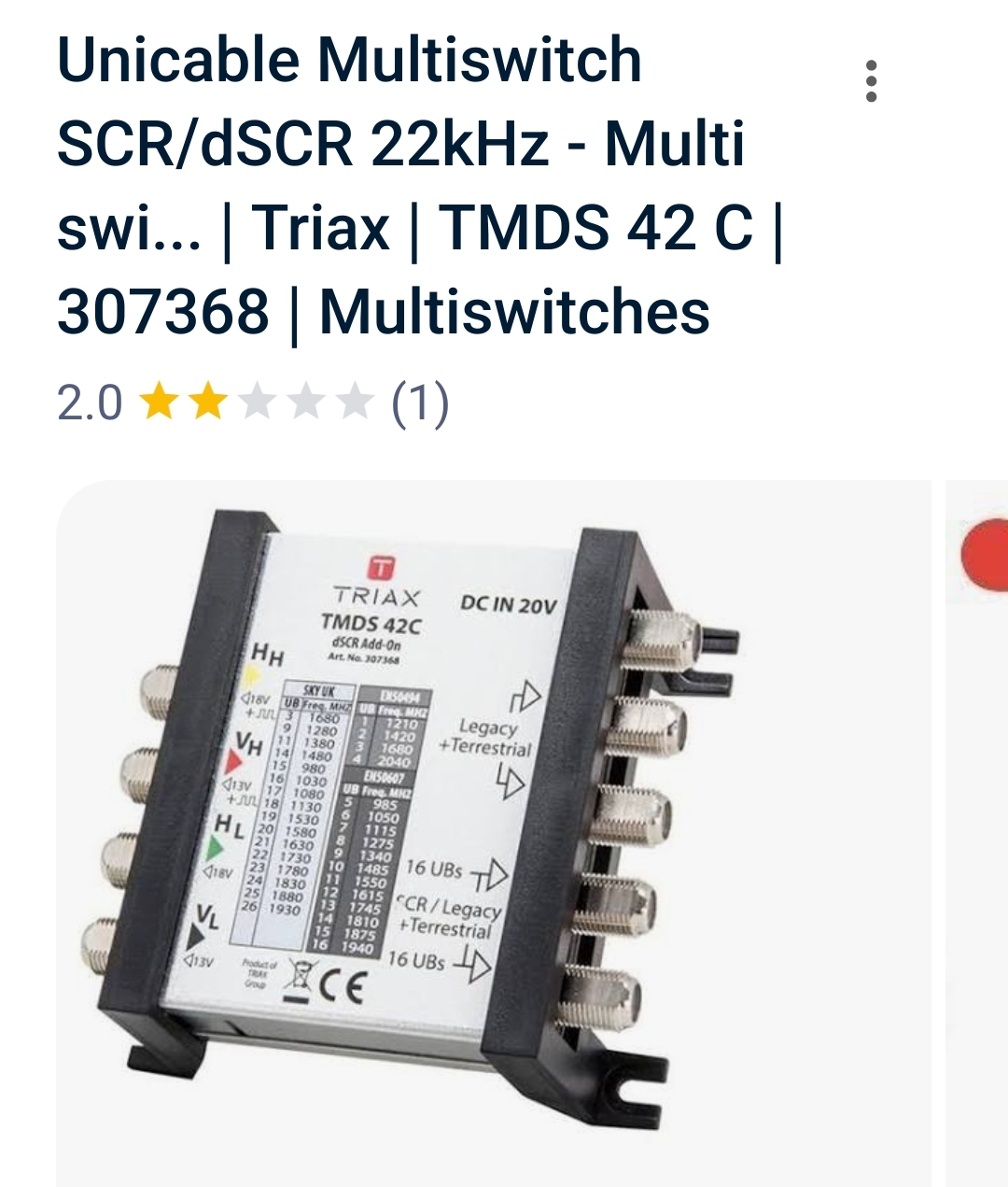

Triax also make the TMDS 42 C "dSCR add-on" which takes 4 feeds from a legacy system, and provides four feeds two of which can be used to feed either legacy or dSCR receivers and two of which are Legacy only.
You're correct. There are a few solutions like this. Different ways to skin a cat.
This one needs the signal from a Quattro LNB, or its pass-through via an older multiswitch installation. If the idea is to add a couple of feeds for a Q box onto an existing system without changing the main switch then I think this is a good solution.
Whether it would work out cheaper for the OP to buy this plus a legacy 8-way switch, I don't know. It wouldn't be as flexible though.
It's probably all academic in the context of what the OP wants.
At least the documentation I can find suggests it can work with four regular feeds. The legend on the front panel of the unit also suggests that.
I haven't studied the documentation. The inputs look like those from Quattro to me. HH, HV, and so on. Like I said in an earlier post, satellite stuff is now on the periphery of what I do.
Maybe you could advise @platforminc how he would connect this to feed 8 rooms with legacy signals? If he can get what he wants a cheaper way than a full-blown 8 way or 12-way matrix then I'm sure he'd appreciate it. This would be handy for me to know as well. :giggle:
Yup, but they are marked with different voltages, and the high band inputs are marked with a symbol that I presume indicates 22khz tone. The datasheet also says "quad/quattro support".
I wouldn't buy it unless I actually wanted a dSCR feed.
I guess then it directs a quad in a way that emulates a quattro.
I wouldn't buy it unless I actually wanted a dSCR ffeed.
So then, not that useful for @platforminc and his application.
Was there another reason why you brought it up?
That is my understanding, yes.

I brought it up because afaict it provides a way to add a Q box to an existing legacy system with relatively minimal changes (my understanding is that Q boxes can be fed with either "wideband" or "dscr").

I suppose if @platforminc had an existing multiswitch switch installation then it would be a viable solution. As he's starting from scratch though it's less relevant
