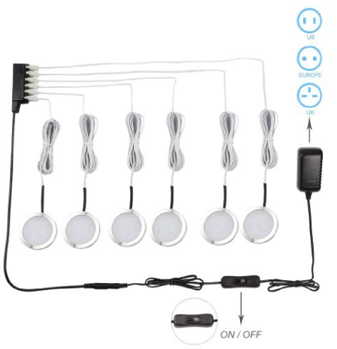

I am looking for some downlights to add to an alcove. I have found these. They are DC12V LEDs.
I want to have them wired to the ceiling light circuit, so I can turn them on/off via a switch at the wall.
Is this possible? If so, would I be correct that I'd need to buy a transformer and ask an electrician to splice this into the wire after the 6-way junction box, and then link this into the lighting switch?
Or is this setup simply not suitable for what I am trying to achieve?

They are not low voltage, they are extra low voltage. They seem to come with a power supply (not a transformer which is an AC device and unsuitable) but the problem is it is fitted to the back of a 13amp plug which is not suitable for a lighting circuit. You could perhaps source a wire ended power supply the same output voltage.

If one can only find 'wallwarts' but does not want to use a standard 13A socket (e.g. if it is to be connected to a lighting circuit, and one feels hesitant to wire a 13A socket to that), I suppose one could 'attach' the device to a socket (standard or trailing), using anything from cable ties to super glue or epoxy - to ensure that the socket can never be used for anything else..

CPC-Farnell have a number that have IEC inputs, which with an IEC mains lead can easily be wired in:
http://cpc.farnell.com/ideal-power/...y-12v-5a-level/dp/PW03997?MER=e-bb45-00001002
They are a mainstream supplier, returns and refunds are not a problem and they ship same day.
