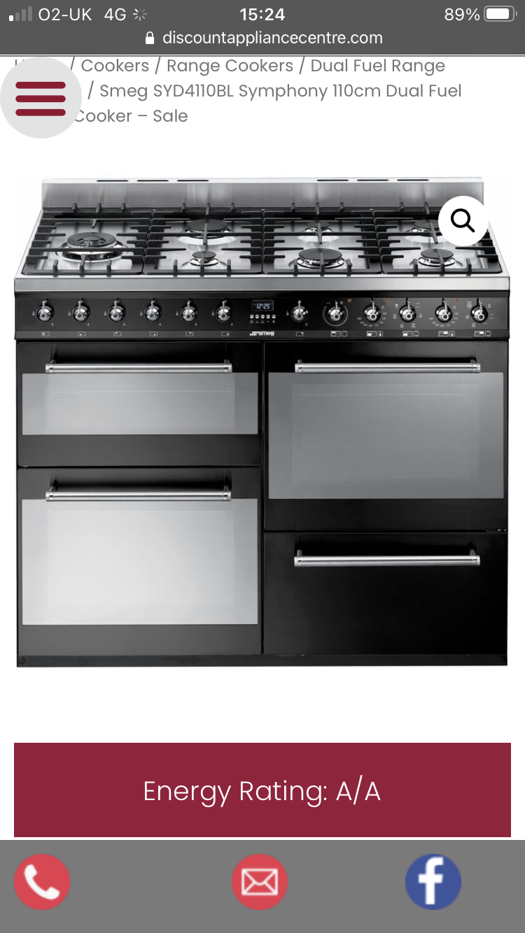

Smeg gas range cooker (oven electric)come with 13amp plug is this ok to use or does it need to go into cooker outlet thanks for your help

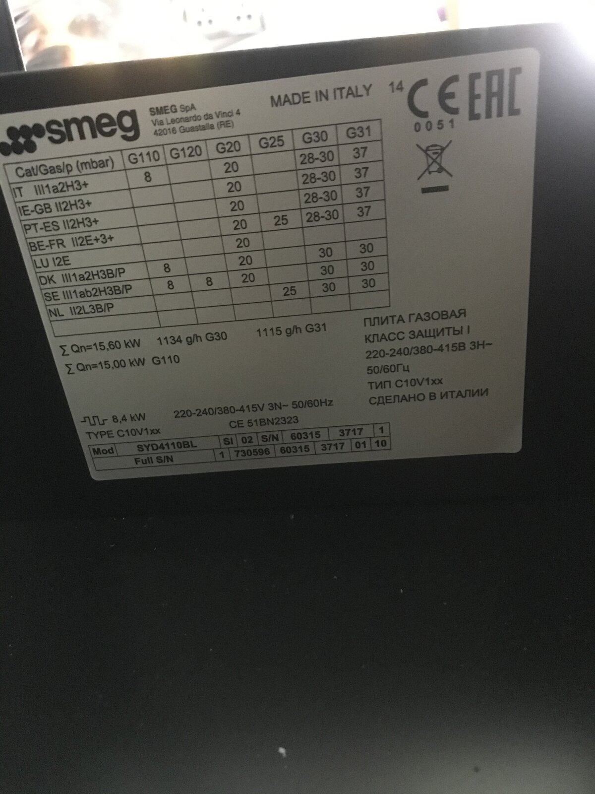

The OP has the dual-fuel model with gas hob and electric oven, so I don't think that can be the electrical load.
I've had dual-fuel cookers which only need a 13A plug.

Apparently these ovens are made for the European market where the fuse rating on a plug is higher. More recent ovens have been adapted to the UK market and 13A plugs, so it should in theory be fit for purpose.

Could be. How many electric ovens does it have? Can you post a pic?
yer I read somewhere that the number is a combination of both and just the oven is 8.4kw? Not sure tho it has two ovens and a grill
