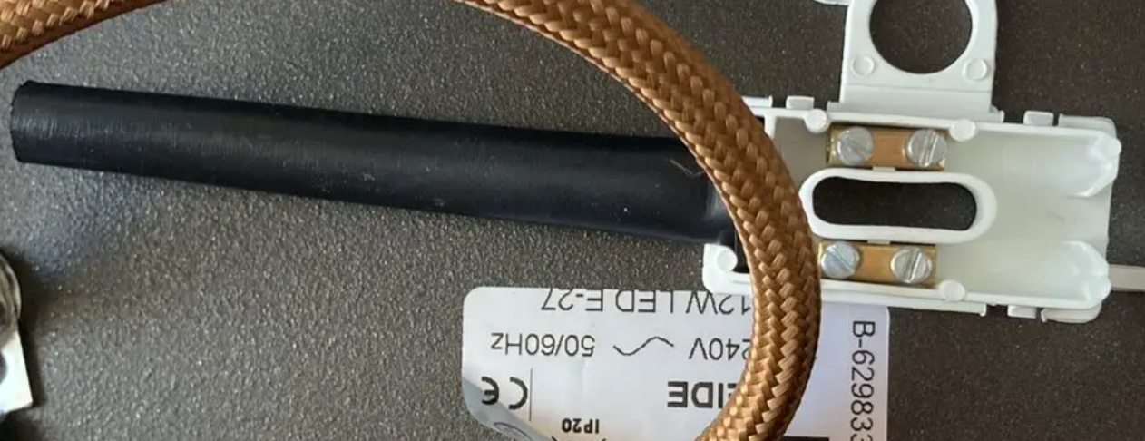

I would like to replace this 3 wire wall light with this other one which only comes with 2 wires. What do I do with the earth wire coming from the wall in the new fixture?
Just terminate the earth/ cpc into a single piece of chic block so it can be used later

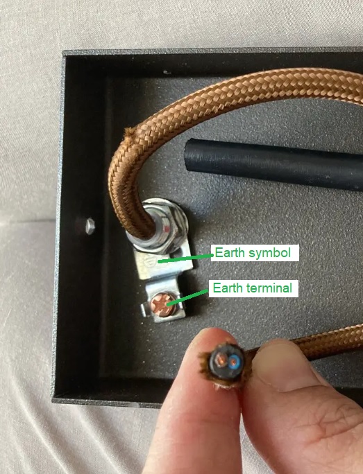

At the base of that wire, the metal connector looks like that is where the earth goes...
But it is not class II it is class I the earth terminal is here 1694424086405.png and there is a sign here
showing it needs earthing. Please look before you answer, hope @Naydnay has seen the answers after yours?
IMO, It could still be Class II - the connections for the cable are made within a reinforced insulation box, with a gland and cable restraints.
The 2 core cord, possibly drops down to a double insulated pendant (even though it's a wall light, why have a decorative flex if not)?
If the incoming flex were 2 core and double insulated, with the connections made within the double insulated connection box, the light fitting could legitimately be a Class II fitting.
The metal cover is purely decorative and wouldn't require an earth.
However, as the incoming cable is T&E, the earth cable with sleeve would not be double insulated, and could not be terminated properly within the connection box - the connections would not have reinforced insulation, and the metal fitting should be earthed.
