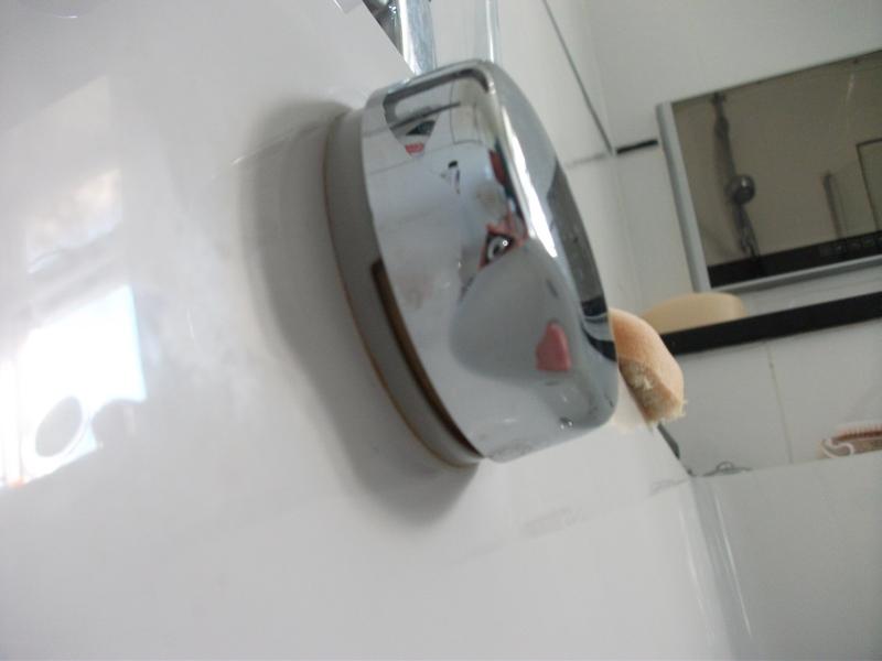

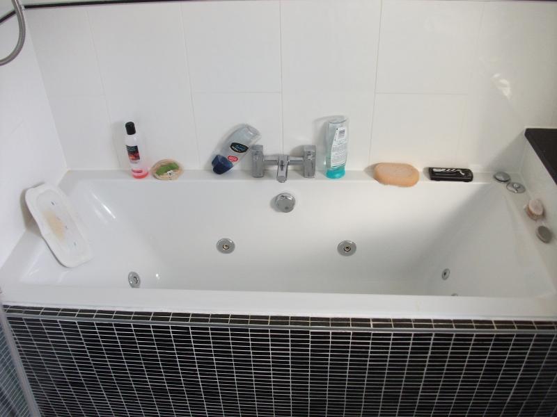

Hi all,
Probably a strange question this and I'm not hopeful that there is an answer to it but I thought I'd ask the experts just in case.
We discovered that our bath is leaking through the overflow. Whenever the bath is too full then we get water dripping through the kitchen ceiling downstairs.
I'm assuming that the overflow isn't connected as the kitchen sink has been plumbed in by the same guy (the previous occupier of the house) and that didn't have an overflow connected to it either.
It's very difficult to keep the level of the water below the overflow because we have a teenage daughter who, despite being told about the height of the bath water, needs re-training every couple of hours or so.... :LOL:
So... I wondered if there is some way of permanently blocking / sealing the overflow?
To get the bath out would destroy half of the bathroom (see pics). The overflow is also rotated in order to lift the plug up and down (see pics).
I'm not sure if the chrome front bit would just pull off and allow me to get behind it to seal it with something or whether it, by sealing it, would stop it rotating and therefore knacker up the mechanism that lifts the plug up to drain the bath.?
I've taken a couple of pics to show you what I mean...
Any ideas would be greatly appreciated?
Cheers
John :D

I can't really get the bath panels off. The front of the bath has been tiled so I'd have to break all the tiles to get to the front of the bath. Something I really don't want to do...

I think the chrome waste may have a grub screw holding it on, not sure on that.

The tiling and everything looks good, therefore are you sure the tiler has not secretly incorporated an access panel to get under the bath. I'm sure you've looked, any cracking in vertical grout? Or has an access hatch been put in other side of wall, taps are on! Or is that the outside wall onto your neighbours :LOL:

TryIt, unfortunately there's no access hatch and beyond the wall is the en-suite bathroom from our bedroom so no access from that side either.
I'm not going to break all the tiling to plumb a drain on because I'm not confident doing the tiling and, at the moment, I can't justify the spend to get someone in to do the work.

The easiest way would be take off the Chrome cap from overflow, to see if you could find the leaking place or block the overflow.

There will be a smal hole in the overflow handle, undo the screw and the handle slides off.
