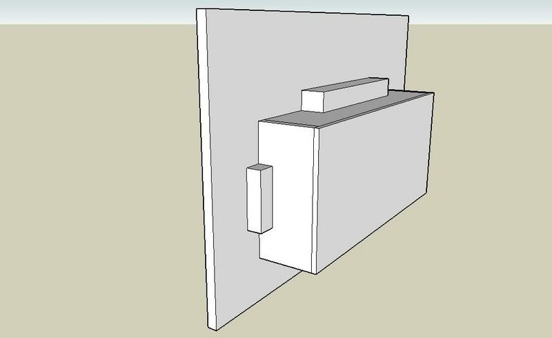

I've just been doing a bath end panel in a similar vein today - oak veneered MDF panel with t6hick solid lippings and an inset shelf unit beneath the bath end (good use of space, too). The cut-out was made by plunging-in a jigsaw then a box with a back was made-up to fit in the rectangular hole. When installed the box will be screwed into four battens secured around the rear of the opening, thus:

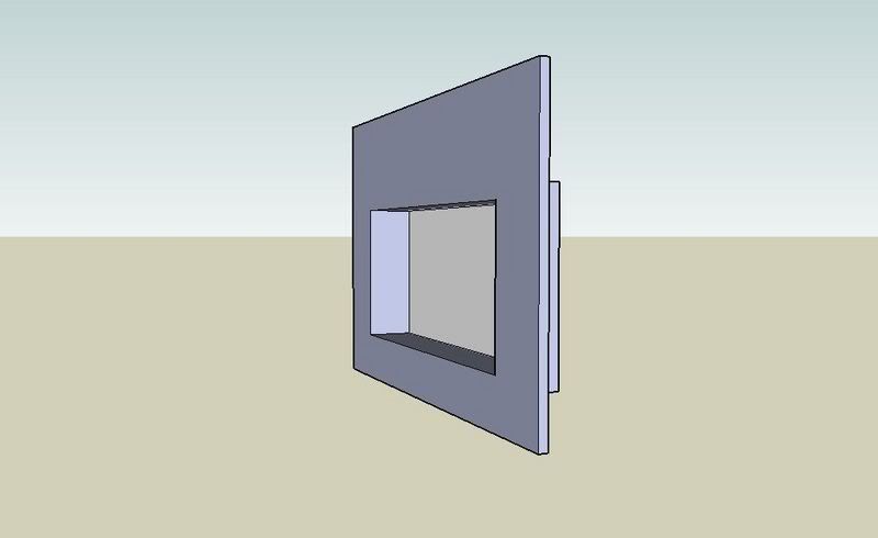

whilst the front is basically like this
It would be relatively simple to adapt the idea to have a light box built-into the top of the box.
