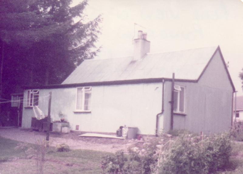

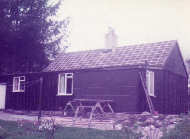

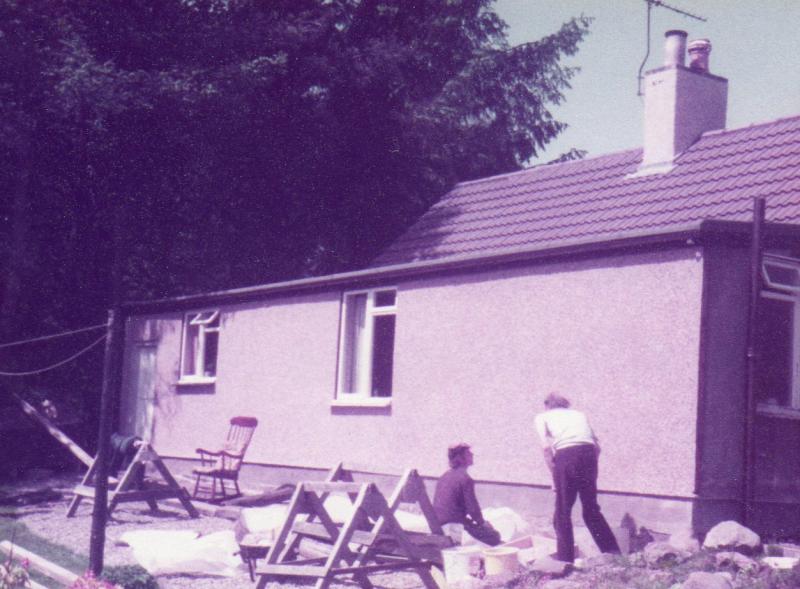

The photo's included in this post show an old, single storey wooden house with all the external walls/gable ends made entirely out of railway sleepers cladded with corrugated iron. The old roof was also corrugated iron, with no lead flashing around the chimney, only a small fillet of cement enough to keep the worst of the rain out. The owner got a grant at that time (1986) towards the cost of a new roof. He asked me if it was possible to remove the corrugated iron and roughcast onto the wooden front, including the porch (which was not made from sleepers). I took the job on. Myself, and my sadly missed labourer, (the brother of the owner), we removed all the c/iron, felted and battened the wall, fitted EML (expanded wire lath),scratched and roughcasted the front with Canterbury chips (Durite), onto a white Snowcrete coating. A bellcast bead was also fitted, and the plinth underneath it was cement rendered. The following year,(1987) the new tiled roof was installed by the contractor. The walls on rest of the house were again, stripped of the c/iron, felted, battened, wire lathed and roughcasted. The end result was amazing. To the passer by it was just a little roughcasted bungalow, unaware that underneath were the railway sleepers and the mesh. I don't know if this would be allowed today. It's great what you can do with wire lath, sand and cement etc, and shows there are many sides to plastering, and a lot of them have nothing to do with plaster.
Front walls finished incl. porch,old leaky roof still in place.
All to be done.View of back with old c/iron/roof still in place.
Work in progress to roof and walls the following year.
Total transformation on the way.I'd just finished hitting (roughcasting) the back wall. Talking with the owner of the property.
Happy days.
