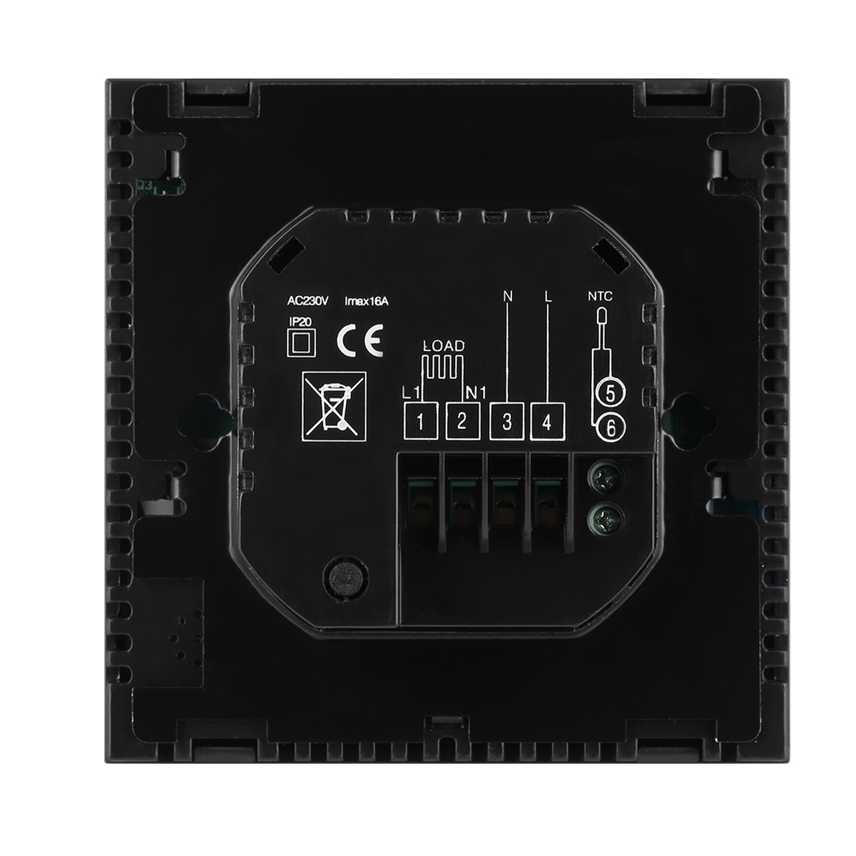

Hi all, confused again!
I have a Danfoss RMT230 room thermostat with three wires. Presume switched live, switched live and a neutral for use with the little heater thing in thermostat (?).

The listing states it can be used for all sorts or purposes but I can't see how. To me it just looks like an under floor heating therostat. So;
1) Has anyone heard of this company or used these thermostats?
2) How would I wire it up in place of my RMT230 if I went for it?
3) Would anyone have any other suggestions? (I'm after something in silver or black, that I can programme and would be simple to fit).

This eBay linky is a rip off of the heatmiser. Possibly made in the same factory. With a different screen.
The heatmiser us ok, but the user interface is awful. The app is actually quite good once you get your head around it, but again, not the most intuitive.

I would have to agree, that new programmable stat will need a 230V live and neutral feed from either the fused spur or the boiler to 3 & 4, the old mechanical thermostat didn't have one, just a neutral for the anticipator. Then the switched boiler feed would run through 1& 2.
The picture of the rear of stat would be used on an underfloor heating element. Same back as a flexel flooring stat front different though.
NTC floor sensor, 1-2 element and LN self explanitory
No assumptions. I just looked at the wiring diagram for both stats.
The wiring diagram for the new stat doesn't show how the load is switched. We also don't know if the original stat is still switching mains or whether it's now ELV
