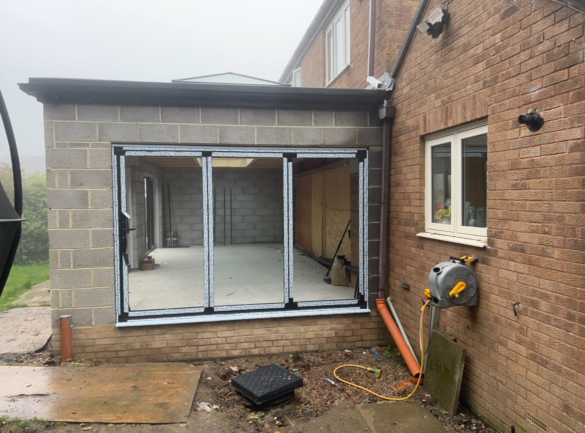

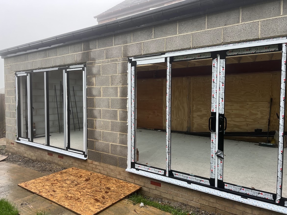

Hi all, can you advise how best to add steps on either side please of this extension. Air vents will need to be extended as part of the step.

Could you not deck it out to create a patio area with steps beyond. The base would be designed to allow space for the vents to continue working, or be extended. Is it block and beam inside?
First tell us what you want it to look like, then we can engineer a solution
