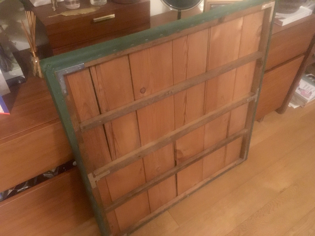

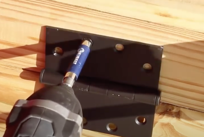

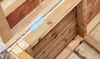

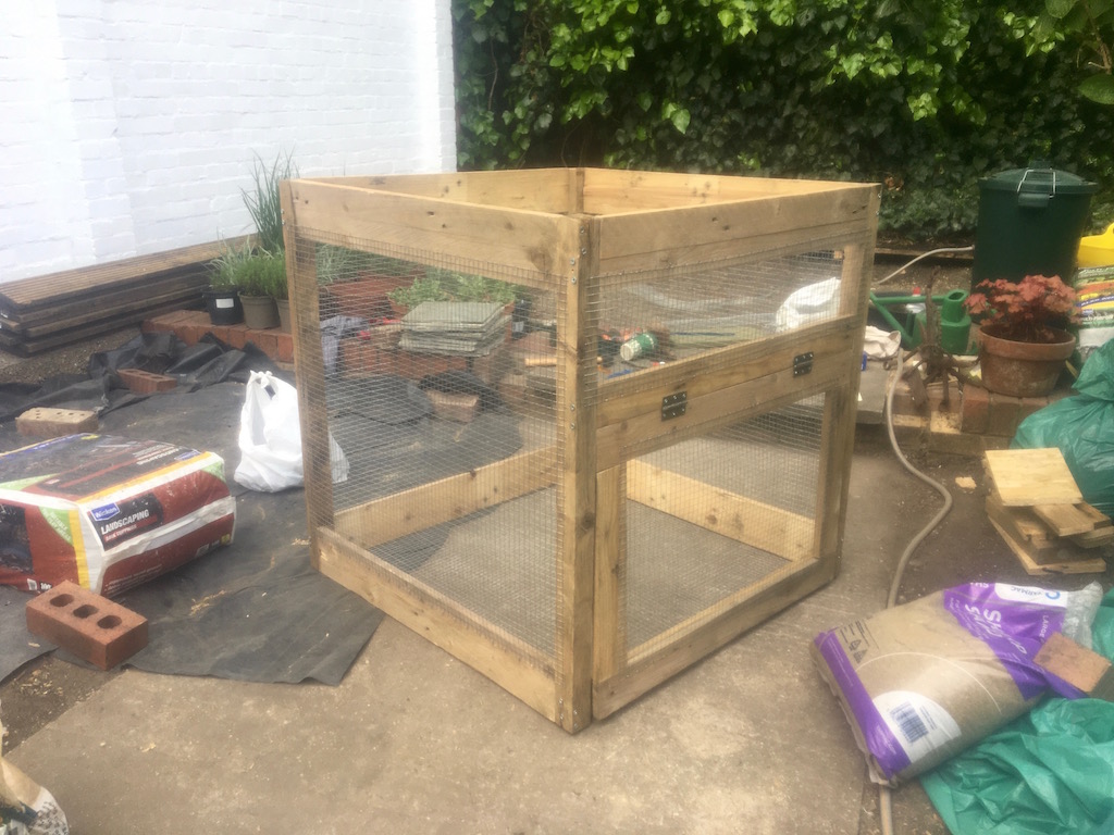

New to DIY but getting to grips with it thanks to Covid. I’ve built a leaf mould cage out of pallet wood and it’s time to attach the lid with butt hinges. But I don’t get the difference between the two hinge positionings in the pictures - down the back, or inside so to speak.
It will sit flush from end to end - there’s no raised back batten. I don’t have tools to mortice so simply want to screw the hinges in to the frameworks. I want the lid to open more than 90º.
Any help with which of the hinge positionings I should use and why much appreciated.

If you want it to open past 90 Degrees then fit the hinges on the outside as shown in the pics. Butt hinges are fine for this project.

Very useful, thanks @conny. I’ll trial and error before final fixing as you say. While I’ve got you, no-one has been able to explain the difference between the two butt hinge positionings shown - any thoughts? They would both seem to open a lid to the same extent. I guess the ‘inner sandwiched’ option creates a small gap between the underside of the back of the lid and the top of the back of the box, which doesn’t matter for this project.
Yes, the inner sandwich method can produce a small gap at the back edge but you stop this happening by chiselling out a recess in each piece of wood so the inner surface of the hinge is flush with the surface of the wood. As it's for outside use I wouldn't bother, hence my suggestion to put them on the outside, but if it was a 'class' project where everything needed to look professional then I would use that method.
Ah, thanks - I’d misread and thought you were talking about putting the chain support mechanism on the outside rather than the hinges. One day I’ll do the proper recess thing but as you say, for this project it doesn’t matter if there’s a gap.
