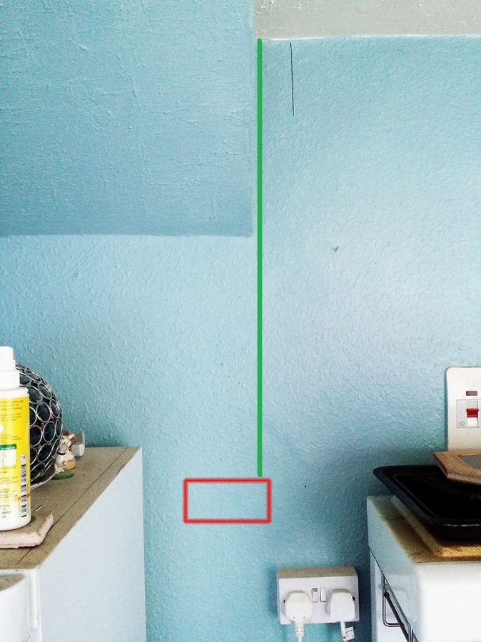

A good amount of this wall will be removed but there is an annoying cable in conduit leading to a double socket next to the fridge.
Black line near ceiling shows the end of the yellow wall (first pic), so the conduit is slightly to the right of the black line.
I need to get the cable to the corner where the stairs are (about 10cm to the left of the black line - second pic) so I can chase down to where the plug socket will be (red rectangle - might change a bit).
Of course the easiest way would be to drill diagonally right at the top of the wall and fish it through - is this permitted and is there an easier way to do it? Thanks.

I'm assuming you don't have the skills or specialist tools to install steel conduit. The rule for this situation is that flush cable is vertical and straight from socket into the ceiling above.

If cable is ran outside of safe zones and not 50mm deep it needs mechanical protection to comply with the current regualtions
One sec... so the only "unsafe zone" here is the bit at the top of the wall - or the whole route? And yes the cable will be chased vertically above the double socket.

There is nothing wrong with chasing the wall down to the socket like this...
It doesn't have to be dead centre of the the socket, the whole width of the socket is the 'safe zone'.
And if you look at a double gang galvanised back box, you'll see there isn't a knockout in the middle anyway.

Thanks Gaz, that's what I meant - I just spent 10 mins reading EFL's link getting confused as I designed this route to be IN the safe zone. The only part I was unsure of is the bit right at the top of the wall (which is outside of the safe zone) since I've never had to push cable through like this. So from what I can see I only need steel conduit at the top then plastic conduit down to the socket :confused:
The bit about the plasterboard... the ceiling was plaster boarded before the wall was put up. So on top of the brick wall is a layer of plaster which obviously helps when drilling the cable through.
The top 150mm of a wall IS a safe zone, all the way round, in any room. I personally don't like it though, someone in the future could get a nasty surprise when drilling there.
The steel conduit idea doesn't work for your situation, it has to be earthed steel conduit, so scrap that idea, it's just getting over-complicated for what you need.
Pull up a floorboard upstairs, pull the cables(s) up from the wrong side and feed them back down on the correct side into the new chase you'll be cutting.

Nope it's all going to be inside the wall. I mean the plastic oval conduit which you would normally use for chases but with metal conduit right at the top (since someone brought up mechanical protection).
I did pull up a floor board but I still think I'll have to weave the cable around a bit hence the question. It's probably unlikely anyone would even drill up there in the future TBH.
It's just that there's a mishmash of materials in that corner (brick walls off-center to each other, wooden panels for staircase, ceiling plaster etc...).
Originally I was asking if I can drill diagonally at the top of the wall to run the cable to the chase location (green line you drew). Metal conduit only came into the discussion as someone above mentioned it.
