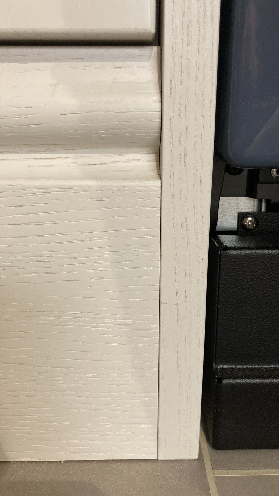

Hi, how did you get on with these plinths? I’m currently fitting them in my own kitchen. But I wondered how you did it when running into the end of a base end panel? I want to butt it up to the end panel but all the instruction say to return it around the panel but I’d have to buy another length to do that? Or does it sit flush with the doors? Cheers!
Hi, the kitchen fitting manual and also the instruction sheet within the plinth pack does not account for fitting between or up to decor end panels. The answer is that the you will need to trim the rail that screws to the underside of the cabinets else the decor plinth will sit proud of the decor end panels. What this does mean though is that the top of the decor plinth sits back a little under the door. Your only other alternative is to adopt the regular fitting method but as you say you’ll need to purchase more lengths of plinth. Hope this helps, never straightforward is it?
Yes I thought as much! And at just over £100 a length I don’t fancy buying anymore! Do you have any photos you can show me please of how yours looks under the doors etc? Never straightforward with howdens instructions
