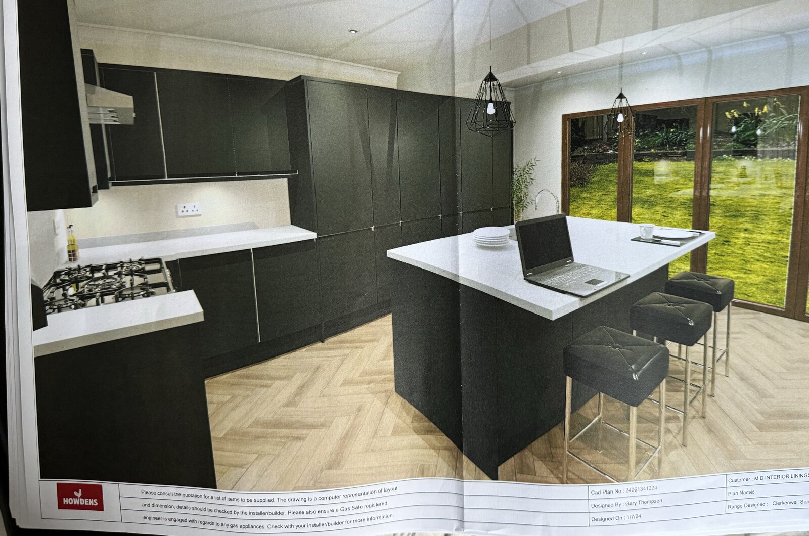

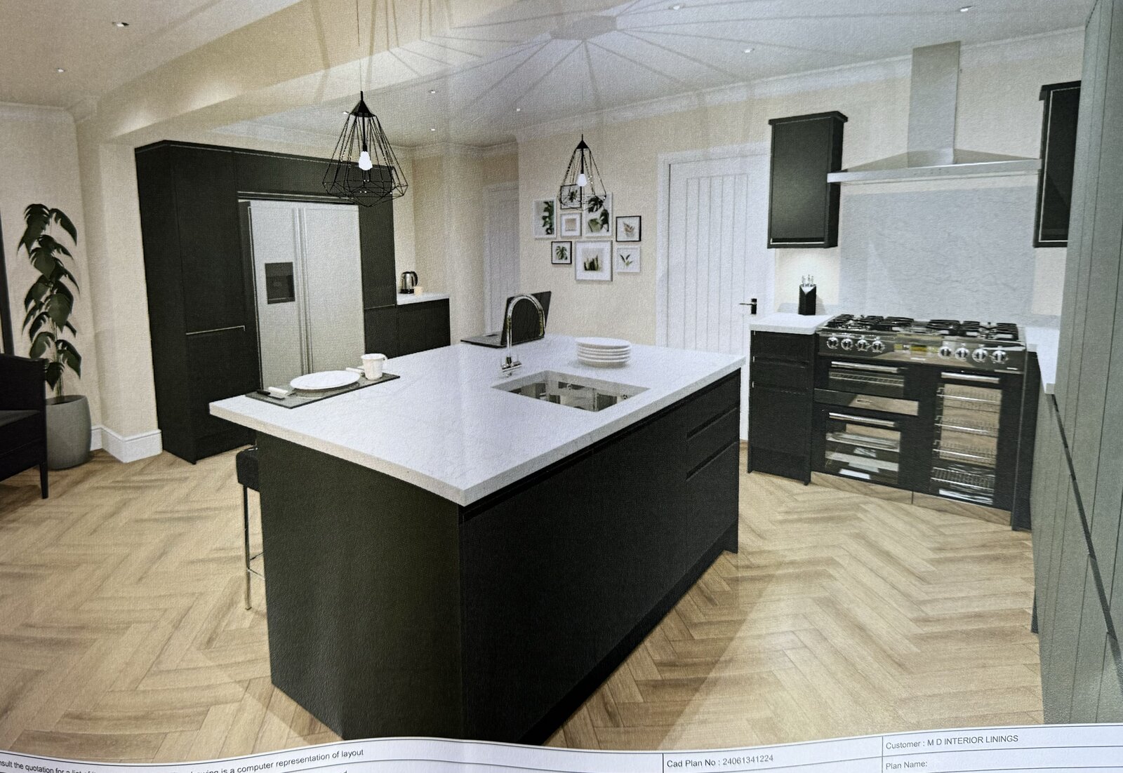

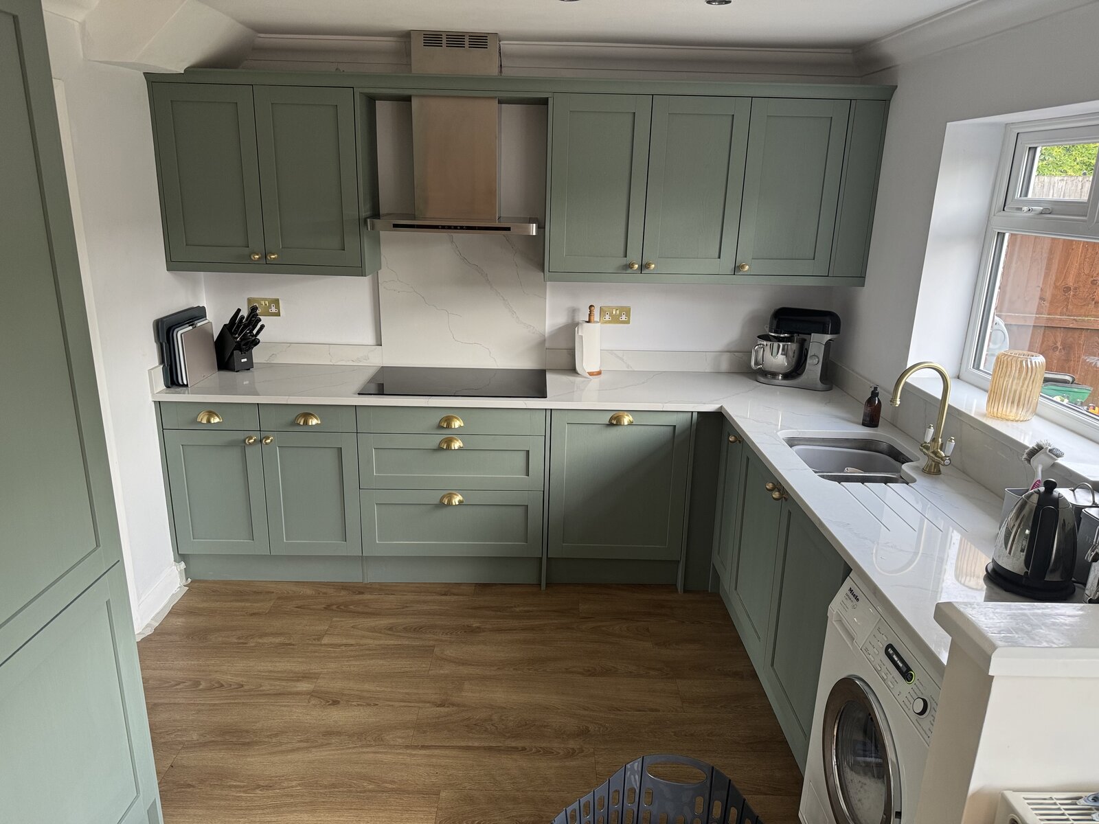

Wondered if somebody can give me a ball park figure of what I should expect to pay for a joiner to install a Howdens kitchen. I’m based in the North East of England. All electrics and plumbing have been done including flooring. No kitchen to take out it’s basically a freshly plastered shell. No tiling or work surfaces as they are being fitted by someone else. See pics attached
Many thanks
When I fit a kitchen, I run the number of items through a pricing grid, linear metres of kick panels, cornice etc.., how many worktop joints, cut outs, and the type of worktop. For example, I double the labour cost for 12mm compact laminate worktops because it just wrecks blades.
My guessimate looking at your pictures, about £2,500 labour. (North England price)
Thanks for the reply, the work surfaces are being fitted by someone else, how much would you take off for that ?
Presuming no plumbing or rubbish disposal and it's not a flat pack kitchen, then it's termed as a "Dry Fit" I'd say between £1800 and £2100.

Run what's on plan and deduct that. Without the plans, the £2,500 is purely a guess. Adapting units around pipes adds more on.

We were quoted £4K for a dry fit from Magnet. The salesman advised against it and said if he was paying that, he'd expect a liveried company van to turn up with fitters wearing Magnet company clothing but said I’d just get a couple of subbies in their own van. He also told us to get our own quartz worktops as that would work out cheaper too. I fitted it myself and got someone in to supply and fit the worktop, backsplash, window sill and upstand. Saved at least £7k doing it that way.

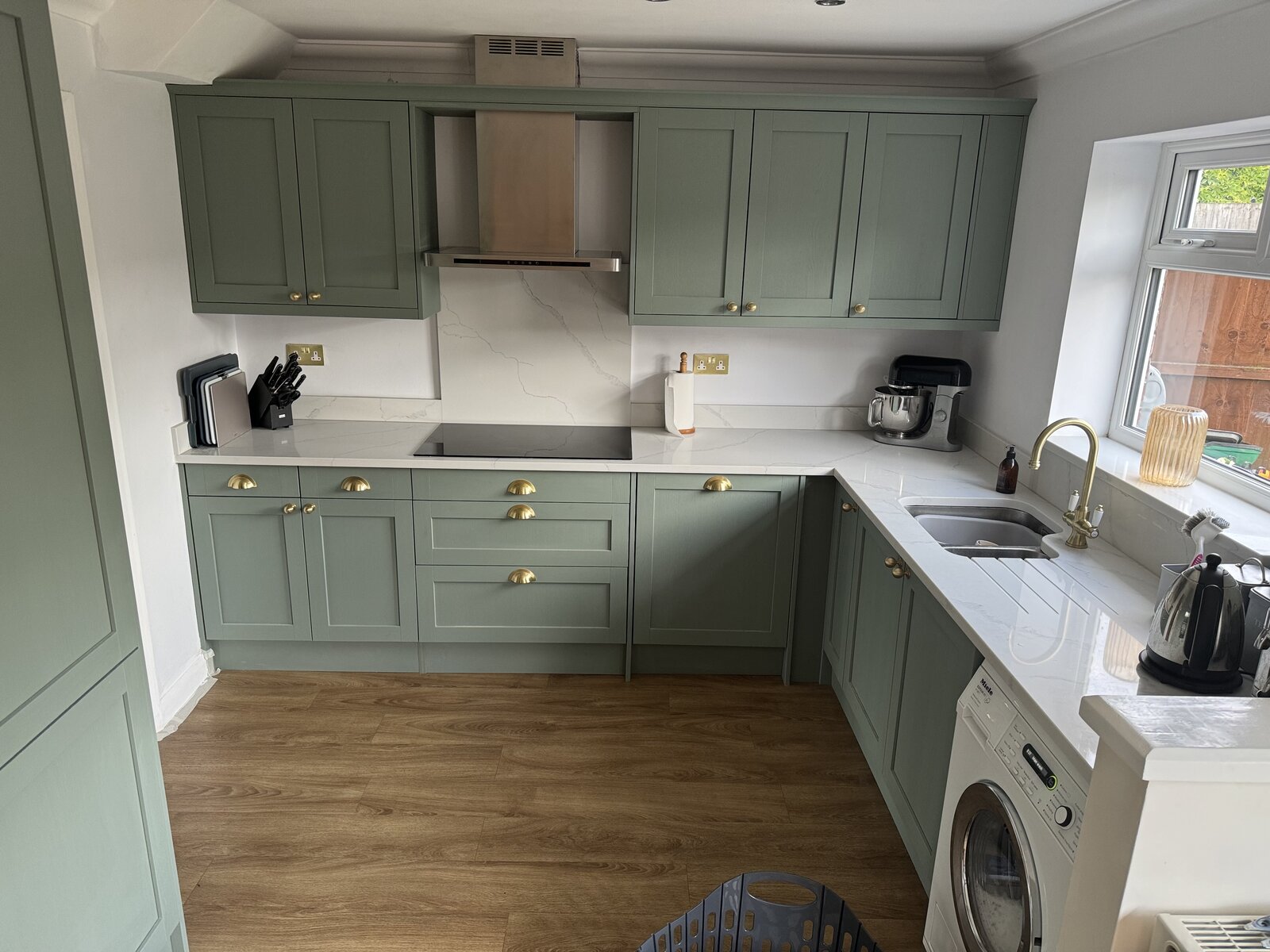

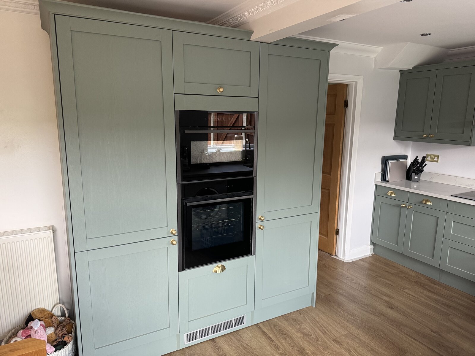

The Cornice finish is Top Top and the fit is good. Kitchen fitting isn't rocket science, but it also isn't as easy as some think it is.
Supplier quotes on fitting are always ridiculous £4k for yours affirms this. I reckon atleast £1k of that fitting cost goes straight to Magnet.
I'm not cheap, I think I'm fair, but I run my own business, self employed, overheads etc etc, don't like working, body is failing :LOL:, make hay.
lol. Thanks but I got a mate round with some kind of angled saw table to do the cornicing and cut out the hole in the flyover for the extract chimney for me. I’d have made a complete mess of that!

So based on my plans at the top what would you charge in your opinion for a dry fit ? Thanks
