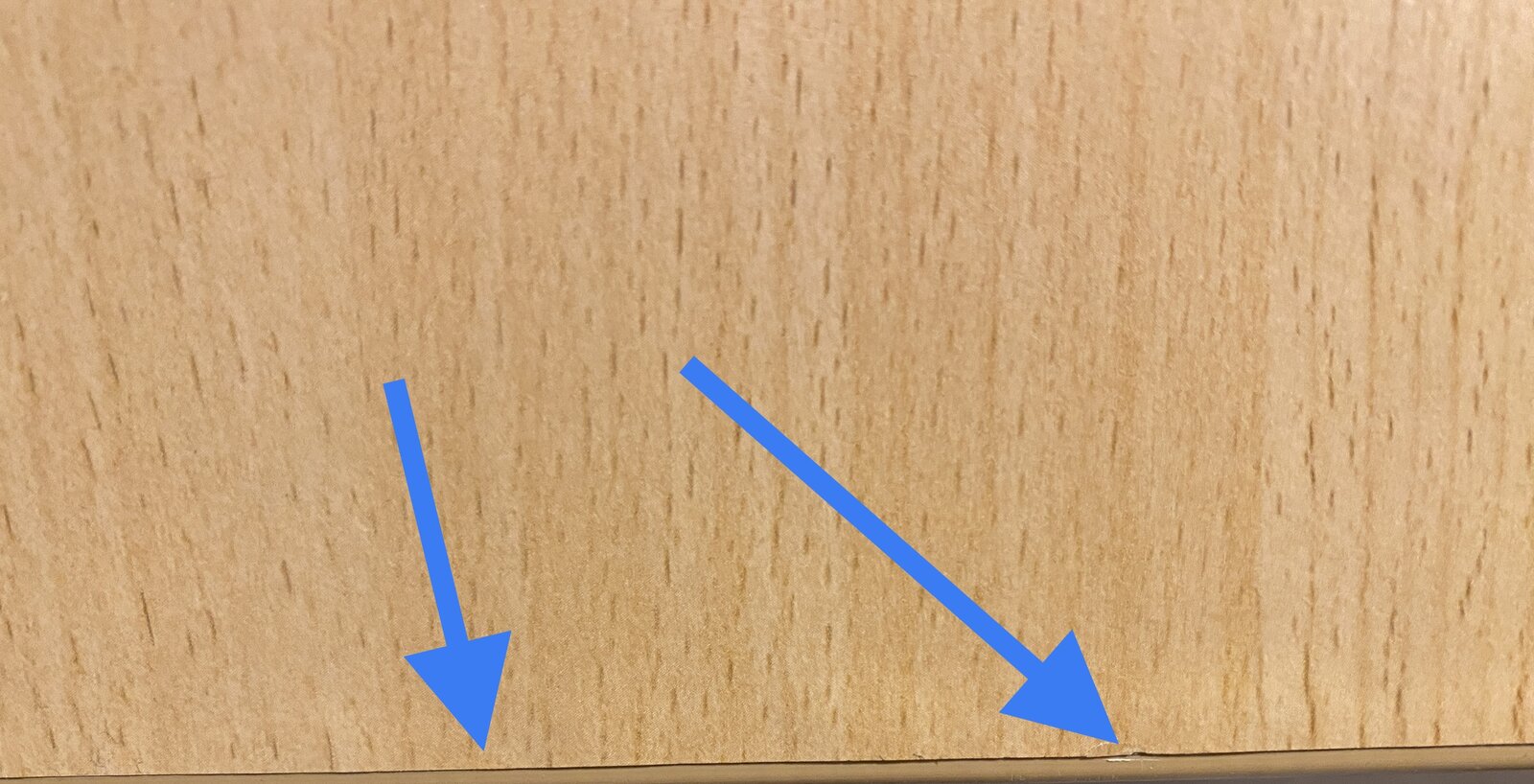

Peeling on Vinyl Faced MDF.
Light oak look.
The Vinyl is showing signs of lifting on the front doors of a couple of cupboards. Looking a for method, if any, to seal the cupboard doors before peeling takes hold. Cheers.
You could try spray contact adhesive and a soft rubber wallpaper seam roller, but it has maybe only a 30% chance of success.
One thing I would do us move my kettle, etc so that it isn't beneath upper cabinets. I had the self same problem with a kitchen I built for my MIL - she used to.position her kettle directly below the doors on one of the upper cabinets. I eventually ended up having to replace the doors because the original style/colour were no longer in production
