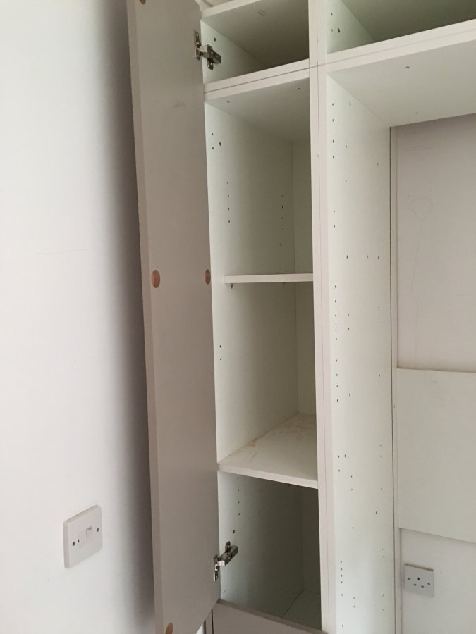

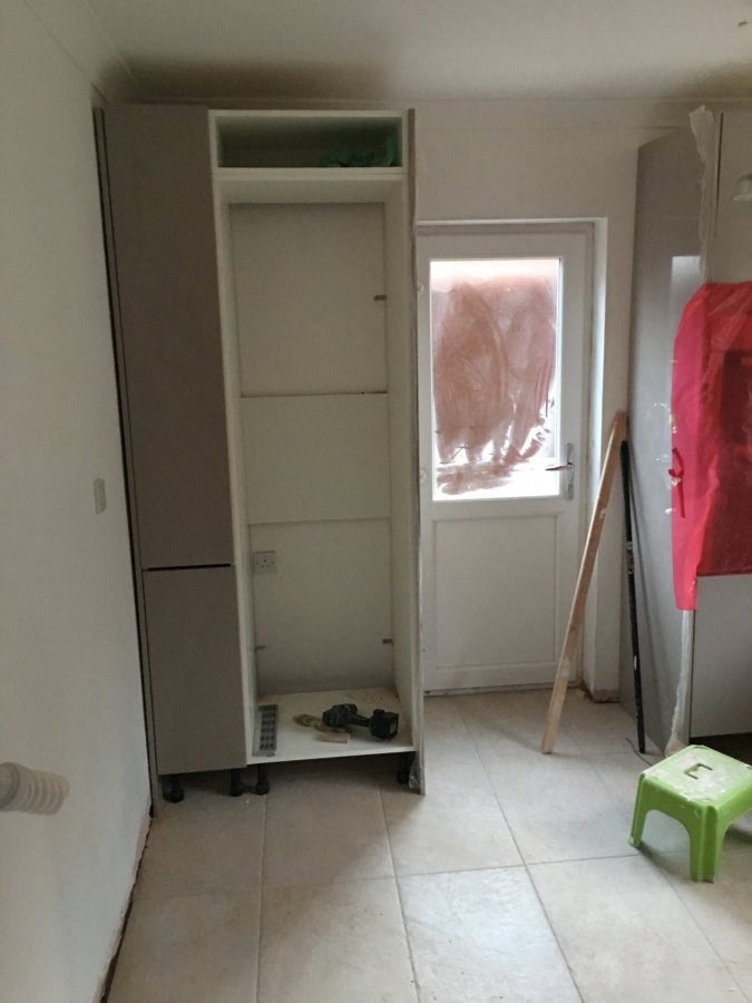

Hi I have a 300 larder (tall as it has a top box) the bottom 300 door fits well. But the 600 door which goes on top is out of line (1inch too high) despite me using the pilot holes in cabinet and pre cut hinge hole in door. I asked howdens why this isn't working and they are investigating .

Because the hinge rebates are not symmetrical - there's about 10 mm difference between them and it's an easy mistake to make.
