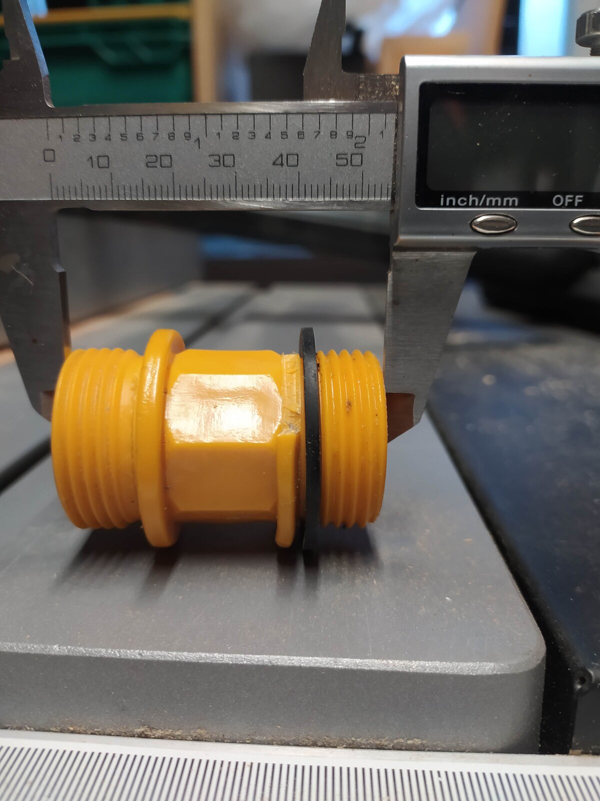

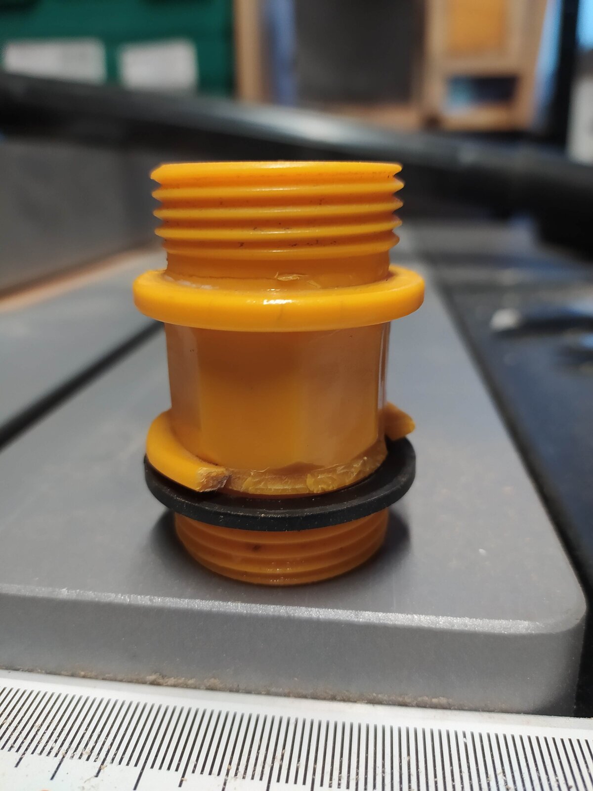

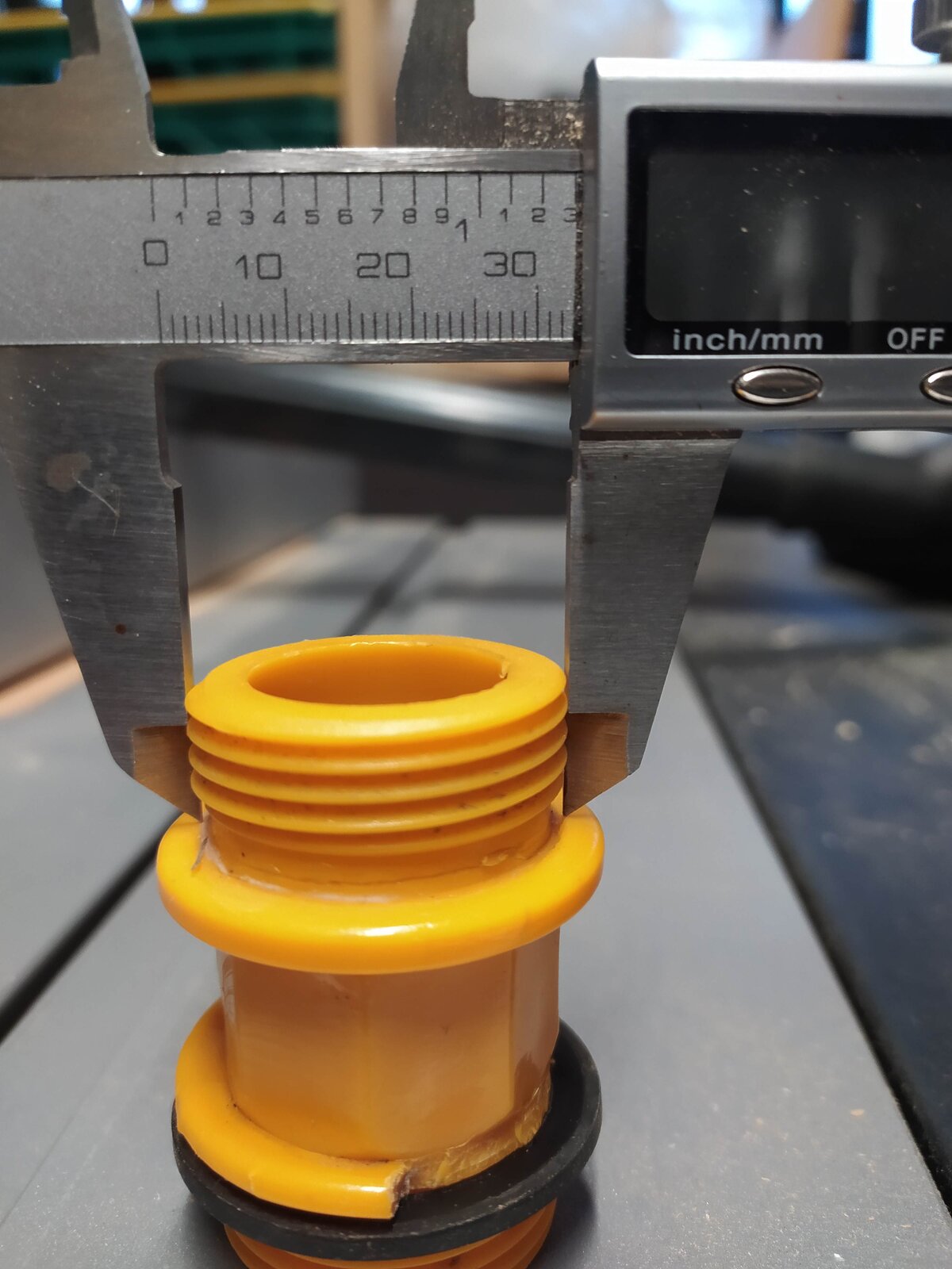

Was wondering if anyone knows of where I could buy connectors for the hozelock 7819 ultra metal garden pump. I have searched the hozelock spares website and its been discontinued so no parts available there. Also tried the usual Google searches and eBay and Amazon but can't find anything.
The connectors look the same for the hozelock 7816 pump but again it has been discontinued as well so having the same issues trying to find parts.
Here are a few pictures of the part I was looking.
That looks like 1" BSP male, which has a 32.5mm outer diameter (noted that you have measured 33mm outer diameter).
Is the length critical?
As i found this searching for '1" BSP to 1" BSP male to male connector'
Or this (60mm long)
Went for the Amazon one as the eBay seller didn't deliver to NI and then postal strikes as well. The one from Amazon was a perfect fit and done the job. Thanks again.
