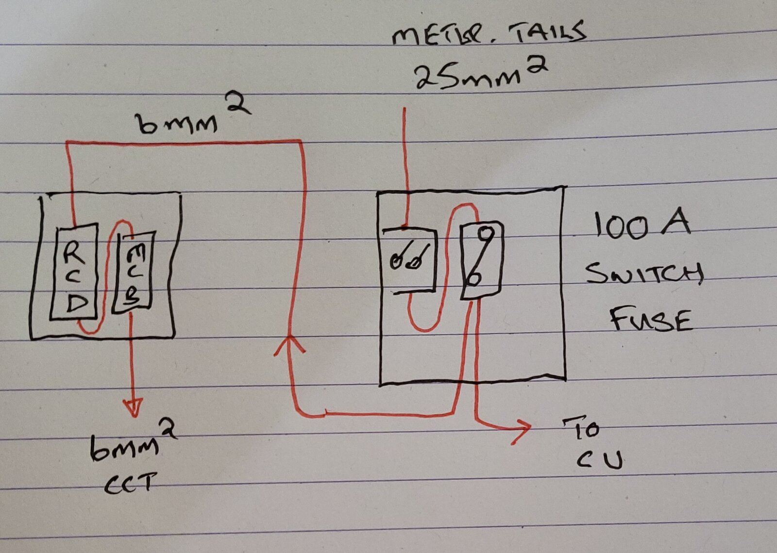

I had an electrician come to site for another job, he pointed out that a circuit off the switch fuse to an enclosure with 80A RCD and a single circuit via 40 MCB (all via 6mm2) was fine from the RCD onwards, but the 1/2m link between the enclosure and Switch Fuse was incorrect as 6mm2 could not handle the 100A capacity of switch fuse.
The supply authority fuse as mentioned above is 80A, thinking that I would (should) increase the link from SwichFuse to 16mm2. (87A rated)
sketch attached. (Not on sketch but cables to CU are 25mm2)
It will never have to as it is limited by the supply authority fuse as I said in post 6.
The Electrician agreed downstream of the RCD/MCB was fine, but had the view that the the link to Switch fuse was in 6mm2 under a fault on cct between RCD and 100A fuse then the cable was not sufficiently rated as a full 100A could flow.
RCD prevented downstream but 6mm cable not correct.
I used 6mm as it was a 40A circuit.
I did point out supply authority fuse was 60A, he advised fuses can be changed.
(Right in the point as Western Power updated it to 89A when they switched to PME last week)
He would not include it in the Part P certification … he certified downstream portion only.
In a fault condition much more than 100A would flow but it will disconnect the supply "instantaneously".
In an overload condition the 40A MCB will protect the cable.

As has been said, electricity knows nothing about 'ownership' of fuses, so the DNOs 80A one will protect the cables to exactly the same extent as your downstream 80A one would.
Kind Regards, John
The Electrician agreed downstream of the RCD/MCB was fine, but had the view that the the link to Switch fuse was in 6mm2 under a fault on cct between RCD and 100A fuse then the cable was not sufficiently rated as a full 100A could flow. ... RCD prevented downstream but 6mm cable not correct. ... I used 6mm as it was a 40A circuit.
As implied, it sounds as if you need a different electrician - one who has some understanding of what he is talking about.
As has been said, the 40A downstream protection (by MCB) for the 6 mm² cable is perfectly adequate, and would be even if there were NO upstream fuse at all.
