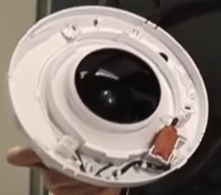

I have a larger Icon 60 in my downstairs bathroom, it has the PIR and humidistat module. It is noisy. The extraction rate is impressive though. The humidity level is no longer adjustable, the screwdriver just spins when you try to adjust it. (from memory, the module alone was £75)
On warm summer evenings, it will kick in randomly, which given the noise, it is a bit annoying.
My biggest gripe is that it is virtually impossible to clean the blades. The outer sections of the blades are inaccessible because of the fixed sub cover.
A minor gripe is that the front cover takes a couple of minutes to open. They use a wax piston to open the cover. The wax has to heat up before it pushes the arm to open the grill.
We paid about £200 8 years ago. One day when trying to clean it, I stoopidly tried to prize the sub cover off, NEVER DO THAT. I had to buy a replacement but kept the module.
I honestly don't know if I would recommend them to anyone else.
Aesthetically, I am happy, longevity wise, other than my breaking one, I have no significant complaints. That said, my humidistat only extractor fan in the upstairs bathroom was less than half the price and has been easier to keep clean.
If it were possible to clean the dust laden blades, which eventually result in greater noise, I would happily big them up.

I have cleaned these several times. It is possible to completely disassemble the blades and clean the whole thing separately. It is a while, but I recall that the only metal piece is the return spring and it was fiddly (but possible) to remove and replace.
The other alternative is to wash the whole outer assembly in a bowl of soapy water and then dry with a hairdrier (or leave in the sun if we ever get any!). This is not quite as effective as the inner portion of the blades is difficult to access

Sorry, I don't think I explained myself clearly. I didn't mean the shutter blades, I was referring to the blades that suck the air out.
The raised section over the blades is plastic welded on.
Apologies - I understand
In my experience I only ever hoovered out the black blades with the help of a paintbrush
