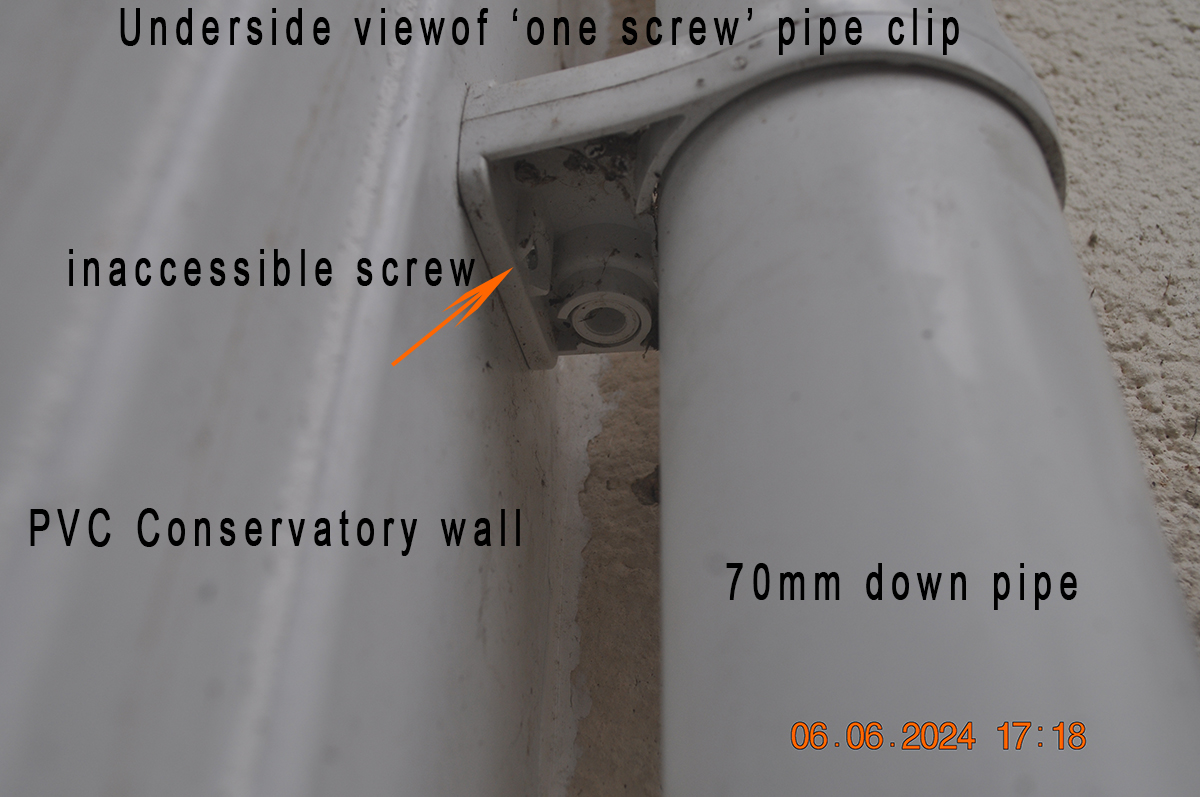

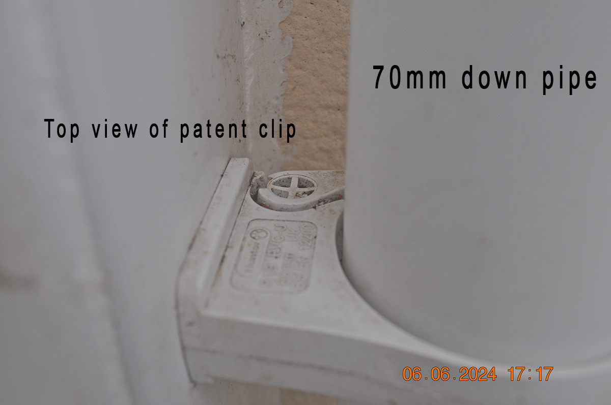

'Hunter' brand one screw pvc pipe clip - how to remove?
13 Feb 2013
60
Essex
I'm trying to remove a downpipe from conservatory, but it is angled at top roof edge and also at bottom windowledge end: it is non moveable without removing the two Hunter branded pipe clips which secure the vertical pipe to the pvc wall. Unlike the 'normal' pipe clip I am used to which is basically a 'U' shape with two screw holes fixing, the Hunter version seems to be fixed with one screw to the wall, before the downpipe is clipped in: now it is insitu there is no access to the screw head.
Not wishing to waste the forum's time, I have already gone to the Hunter pvc pipes and fittings website, where literally thousands of items are on display, but nothing in the 'brackets' section apart from the usual 'U' shape and one 'open' bracket, that I could see.
If any of you professionals have come across this item and can tell me how to spring or twist or pop it open (without fumble-fingers here) snapping it off, I would, as always be grateful and click you helpful.
Thanks.

Yup, that did it - two taps with a mini hammer and it sprung apart, flexible enough to curl open and release the down pipe.!
Many thanks for your fast response.
