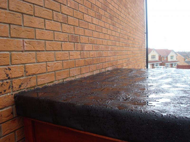

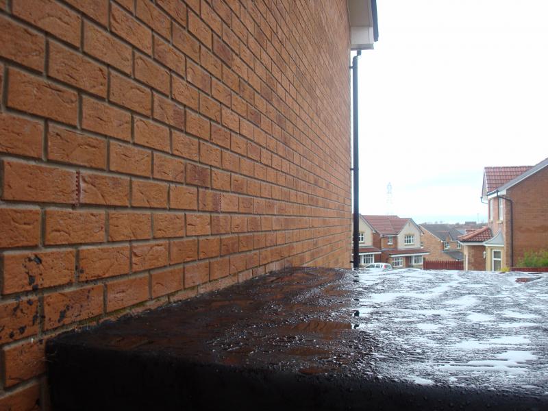

Looking to see if you could help. Had a hut built next to the outside wall of the house, however there is very little space between that and the wall and worrying about water ingress/dampness. Is there anything that can be placed along the hut against the wall that would stop the water. I have a length of angled plastic that I considered using the address the problem, however not sure what the correct practice is.

Yes it should have some type of flashing, typically lead. That is a pretty poor job to be honest. :(
What was where the "hut" is now? A set of doors, or window maybe? I can't work out why you have got 2 rows of weep vents 3 courses apart on the elevation just above that new flat roof :confused:
Just sitting on the stepped dpc in at 1st floor level surely?

This was the side of the house, no windows etc. Lead flashing is an option, however is there anything else.

Thanks for the suggestion. I understand how this would work, however are there any tricks to the application as it appears the cure/stick on contact so I would need to get it half and half and in a striaght line

get the 300mm f/band and give it a gentle heat with a torch, stick half on the wall with the rest sealed onto the roof.
Still don't understand exactly what you mean freddy? :confused:
OP I would go along with alastair's suggestion. I would be half inclined to run a length a tilt fillet down the junction prior to the flashband.
