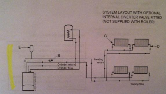

I have the following CH/HW setup:
Boiler:
WorsterBosch Greenstar 30DCi Boiler (60/100 Horizontal Flue)
DT20 Timer | Intergral Diverter Value
HW Cylinder:
GLEDHILL 1500X450 INDIRECT COPPER CYLINDER
POLYTANK LOFT TANK 64X24X19 70G
Stuart Turner Monsoon Standard 3.0 Bar Twin Pump
Installation Layout:
S-Plan:
When I walk down stairs in the morning (06:15), the boiler is on and is heating the HW Cylinder (readout displays 85 ish) but the radiators are cold, if I press the “advanced” button to turn off the HW, the readout goes straight down to 30-40 ish, then the boiler kicks in about 2 mins, then starts heading the radiators…
Is there a problem with the diverter value?, as I was under the impression that the boiler could heat the HW cylinder and CH at the same time?

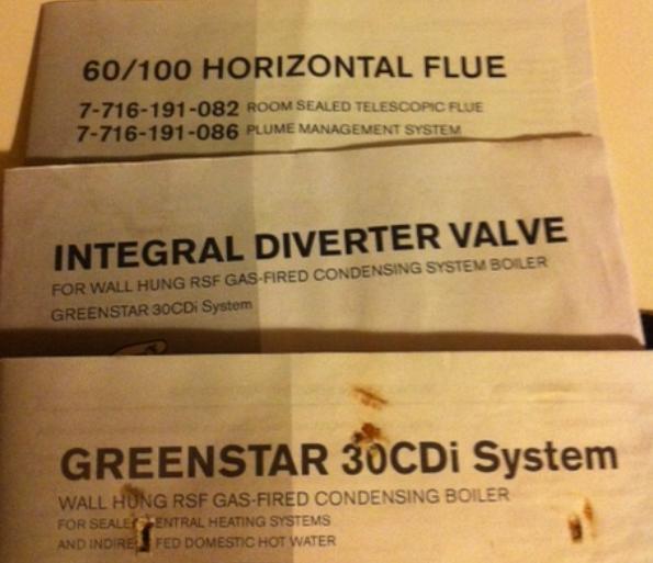

The Integral Diverter valve is what it says: it diverts the water to either the central heating or to the hot water. You can't have both at the same time.
The DT20 and the Diverter valve work as a pair; you can't have one without the other on a System boiler.

I do have the integral diverter value, as I have the following manuals:

The boiler manual in the link below, shows that it can be installed with a 3 port valve to give CH & HW simultaneously.
Click here for the manual. The 3 port valve is shown on page 10 "Y Plan Layout"
If yours is fitted with an internal diverter that only offers two positions, it looks like they are using the parts from the combi version and introducing combi disadvantages.
