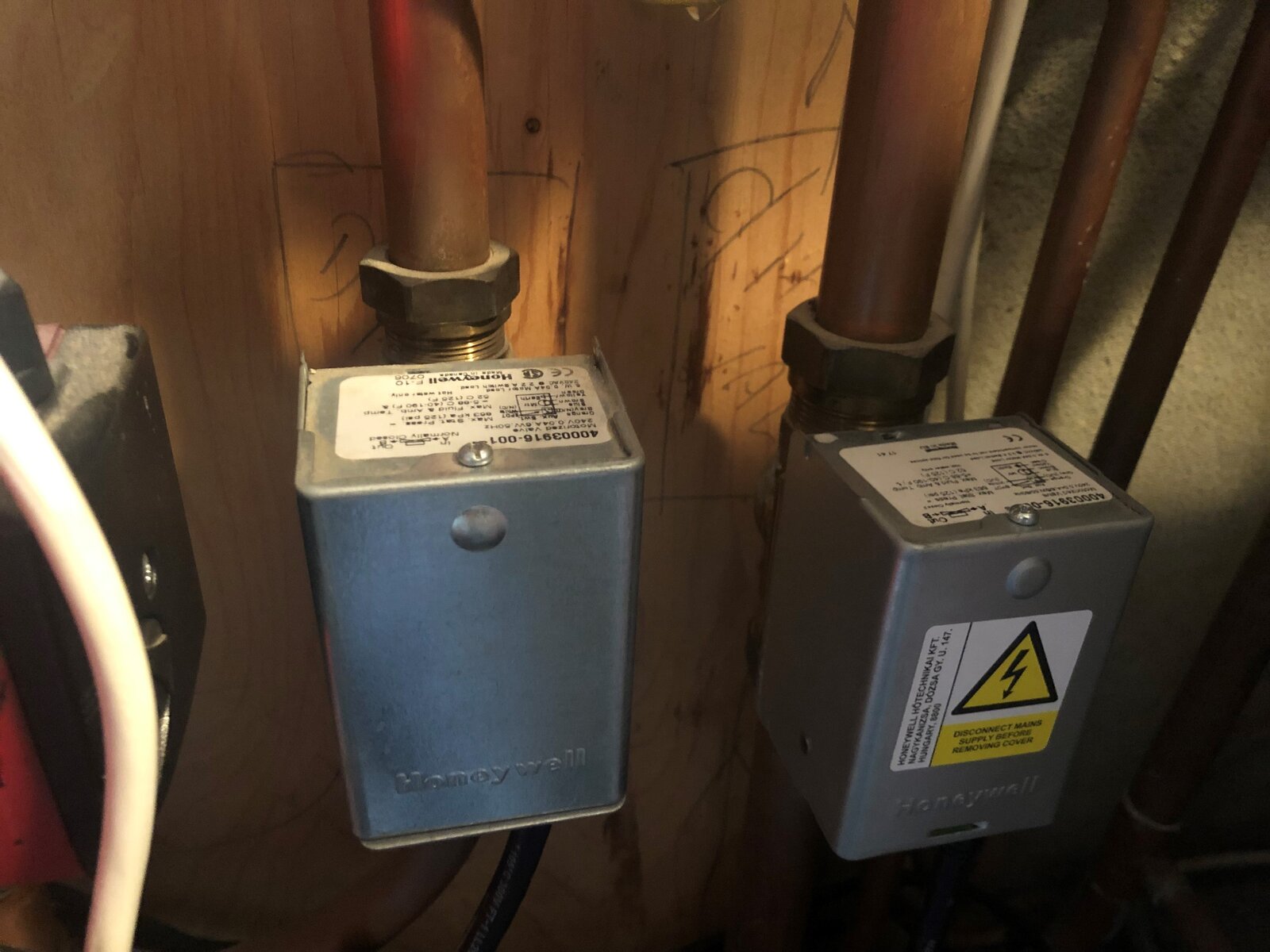

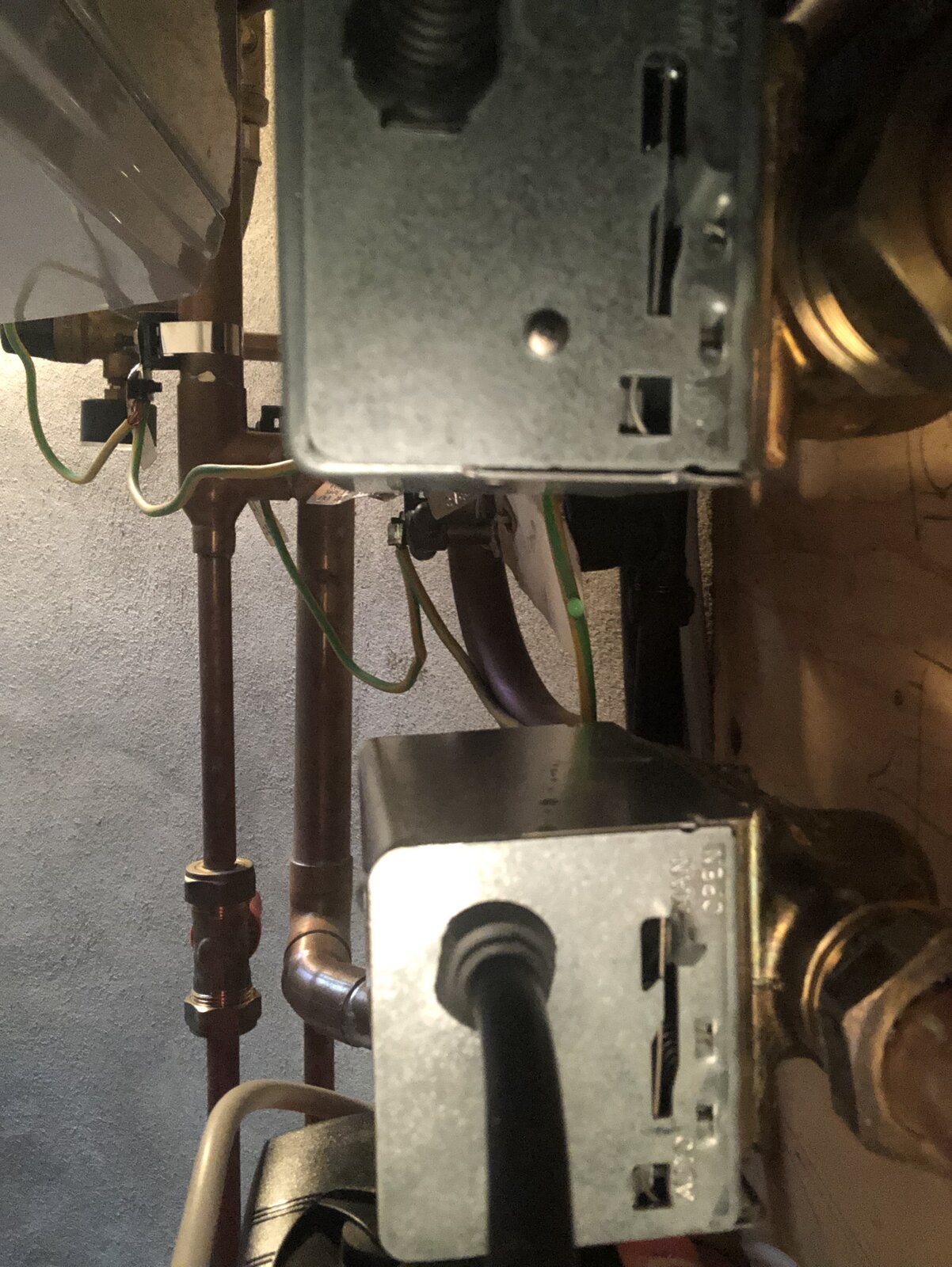

Here are photos; I believe they are the "dimpled" with accessible/removable synchronous?
The valves are as I found them. The sliders are both on "Open / Manual". At time of photo the CH was Off, which suggests the CH diverter valve incorrectly left in manual position, yes?

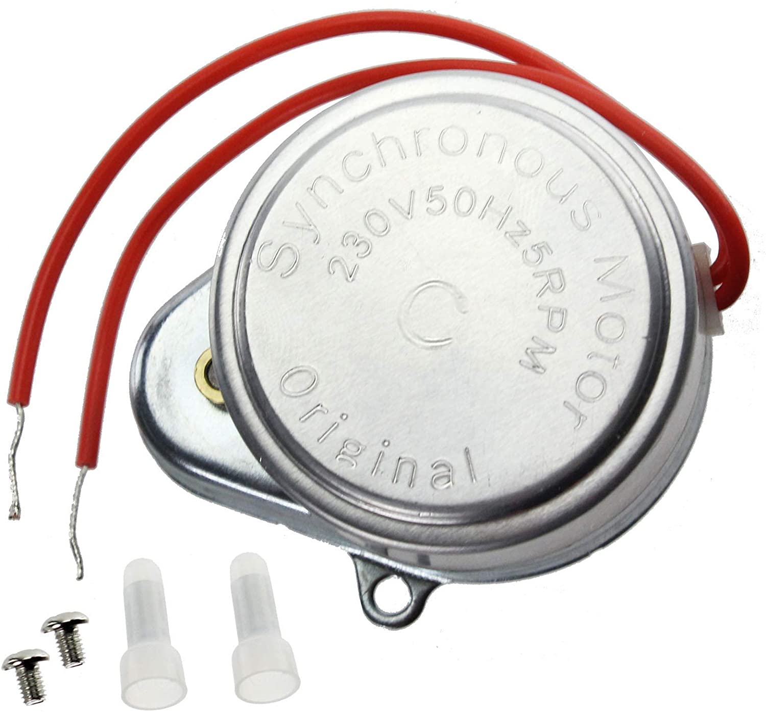

Thanks for the reply. Is it just replacing the synchronous motor, e.g. one of these?
It looks like one can also buy complete replacement motorized valve heads, which I assume include the electric switch in the valve that signals the boiler.
Is there a way to know if it is a bad motor, as opposed to a bad electrical switch in the valve?
Does it make more sense to replace the complete motorized valve head for an extra £20?

Neither valve is in the manual open position, once you manually open the valve , there is a small notch at the end , you lift the lever up till the spring pulls it baxk, and that little latch holds the valve in the manual position, this however will not fire the boiler, as the motor has not moved enough to make the micr switch that tells the boiler to fire, to test the synchron motor, turn oth CH &HW off and slide each lever over manually, you should feel a slight resistance, then turn both CH & HW on and do the same with the levers, this time there should be no resistace as the motors have opened, if one has a resistace then that is the faulty one , completely up to you if you change the whole actuator or just the motor, and yes you do indeed have the removeable actuators so no need to drain anything
