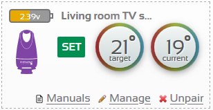

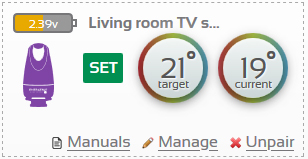

I tried to balance my radiators, tried using a point and read thermometer, but could not get a good reading, did find some lock shield valves needed more turns than others to start to pass water, so can't say if ¼ turn or more or less at a time, but I closed until cold then re-opened ¼ turn at a time until feed pipe had a little heat.
Once they were some where near, used the reading from computer Flat Battery TRV.jpg I moved the pair of TRV heads which were electronic radiator to radiator and if target not ever reached opened slightly and it current exceeded target closed a bit, once set the TRV heads did a good job.
This house have 9 electronic, but don't seem to work as well with on/off boiler to modulating boiler.
