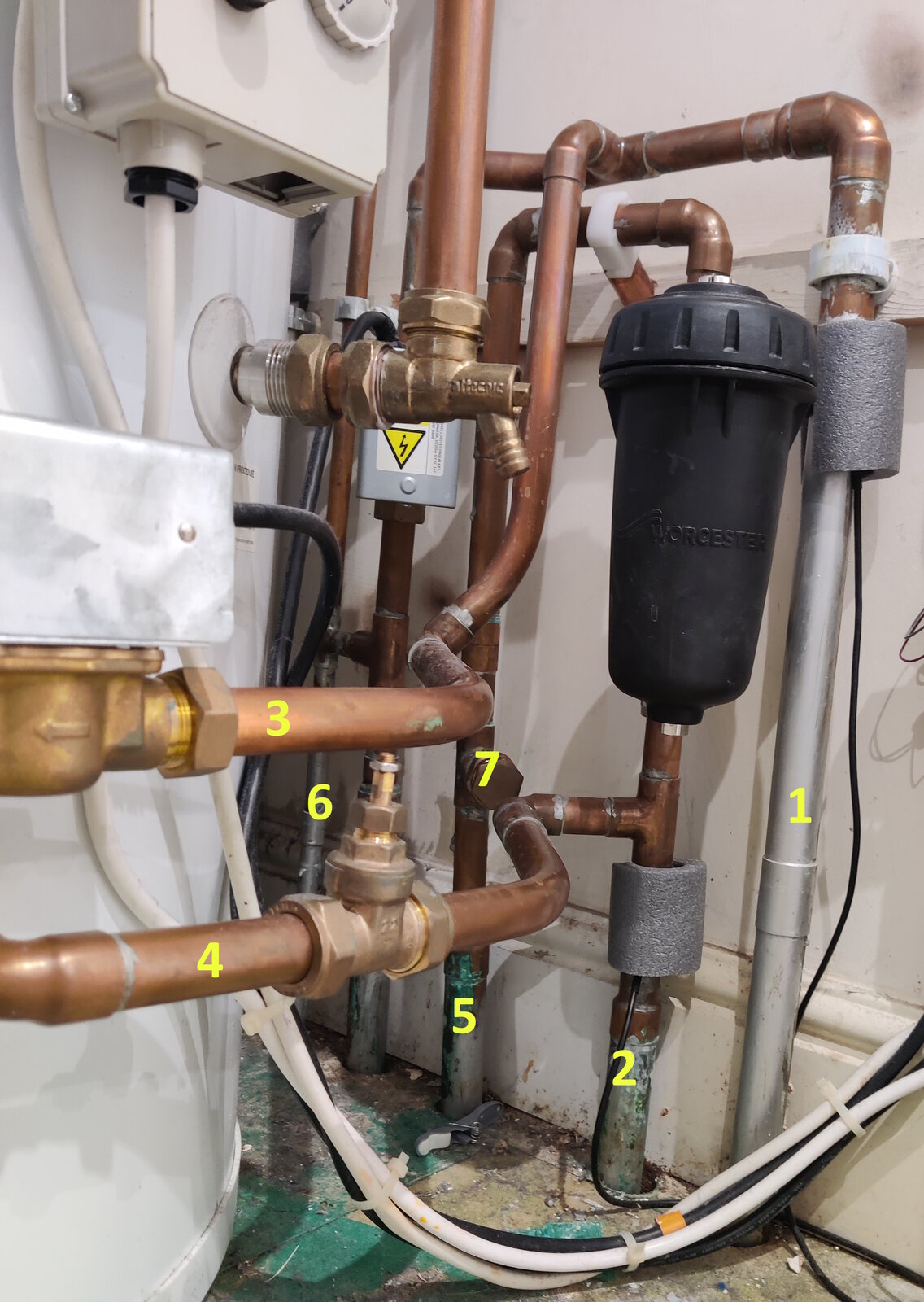

House has "Summer Radiators" in the batherooms that heat when the boiler is on - even for HW.
System boiler & unvented HW (boiler and HW tank swapped 3 years ago)
Asked plumber to remove Summer Heating as it's a waste of £ and I'm tight..
Nest thermostat
When install was finished, noticed that the rads were hot when the HW was on. Plumber came back and moved the return from the HW tank to the otherside of the magnet filter in the airing cupboard (as in the pic below). This seemed to solve it.
Since then, new rads in most rooms and balanced the CH system. After then, noticed that now some rads are getting hot with the HW on - checked the 2-ways, all working correctly. From feeling the pipes, what's happening is the return from the HW is flowing back to the boiler AND towards the rads (effectively reversing the return from the rads - in the pic, coming from 4, towards 2 (where it should be!) and also towards 7).
From what I can understand, the summer rads were fed from a sererate feed from the boiler F&R. This was changed by the plumber, but he could only get to the flow side, and not the return as it's either fed back to the return at the boiler, or more likely, each rad is back into the CH return. I didn't fancy him trashing my house to find this.
Having had a look at the pipework in the airing cupboard, I have boiler F&R, CH F (with 2-way) and R all on 22mm, and a 15mm pipe I guess is connected to the feed of the Summer rads.
My thinking is to add another 2-way on the return from the rads and wire this same as the 2-way on the flow to the rads so both close and open with eachother on when CH is called for. This would effectively isloate the rads.
This is the current pipework:
1) Flow from the boiler
2) Return to the boiler
3) HW flow
4) HW return
5) CH flow
6) Summer rad F or R
7) Inserver additional 2-way here, set to operate the same as the one in the background (with the flow set the right way)
Confident in my plumbing skills to drain down and fit the valve, but wanted a sanity check first
1) Can you wire 2* 2-way valves off the same feed to operate as I plan?
2) Is there something I'm missing as to why this is a bad idea?
If it turns out to be more complicated than this then I'll get a plumber in, but aprecieate any advise so I can understand.
