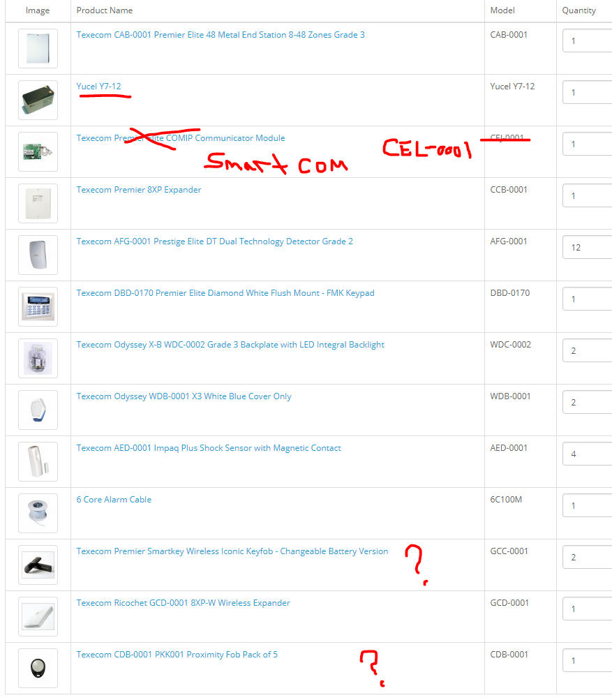

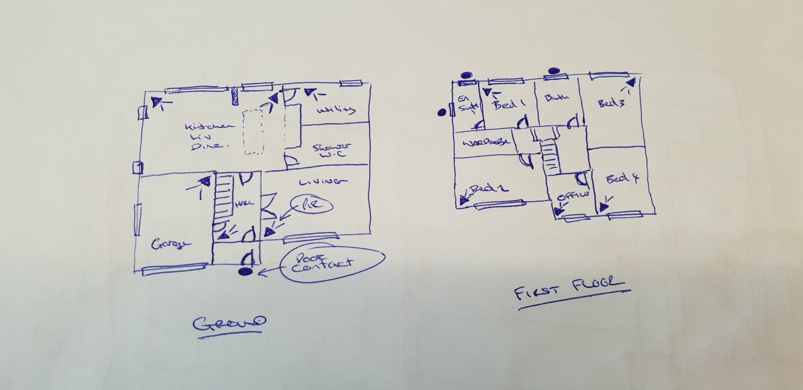

Anyway, I have specced up the following and have a few questions if you are able to help (thank you by the way)...
1. Do you see any issues on my plan with regards to where I have positions PIRs and used door/window contacts?
2. Are all the items listed on my procurement list compatible and is there anything I am missing or would be better recommended?
3. I am not keen on the proxy readers or smart keys as there is no protection on their use. Can the Texecom App be used as a replacement so as to Arm, Part Arm and Disarm etc. from within the app. As the phone is secure this to me seems a better option?
4. Can you recommend a good internal sounder (wired preferred but wireless accepted)?
5. Should I cable with 6 or 8 core cable. I know 6 is the only requirement for this but I can do 8 just as easy for any future requirement (House is currently a shell being refurbished).
6. Is the battery I have specified large enough?
I have downloaded the Elite 48 manual and now I am all set for a few nights of bedtime reading!
Thanks in advance guys.
okay, my first question would be how many wireless zones and how many wired zones.
struggling to read you picture file list.
I always use 8 core, 1 cable 1 device
The combinations of equipment can make a big difference to price and flexability and kits available can save money.
As for the right detectors, in general a DT is probably overkill for clean living areas, but for conservatories and garages they more suitable.
During a site survey an installer would look at best locations, avoiding drafts and heat sources etc and with wireless try and keep away form large metal objects including foiled plaster board.
Then it may work out better to look at the 64W (and or kits 1-4) and an 8XP
The 64W has 4 zones on board and the 8XP can take 8 zones obviously
