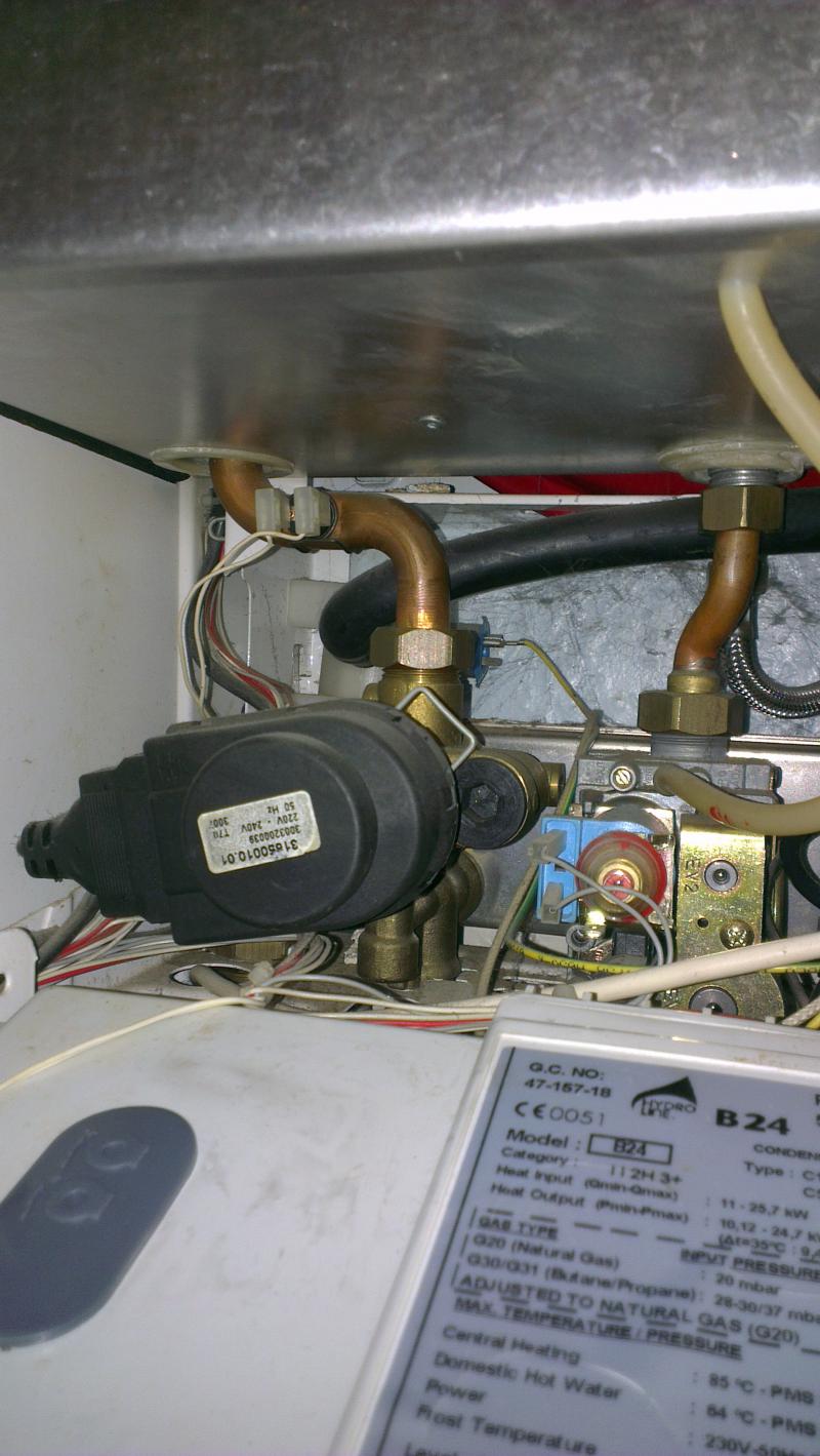

Hi guys, was hoping one of the boiler experts could advise.
A friends got a Hydro Line b24 combi boiler. Its build looks similar to the heatline range of boilers.
I've got a flashing red light on 40c (the 3rd light up from the bottom). On the label on the side of the boiler, it says if this light is flashing "if this LED is flashing, Check DHW sensor.

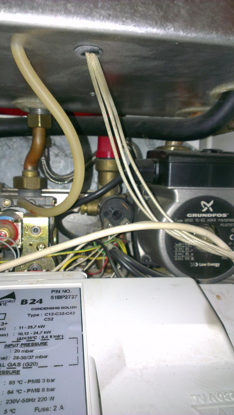

I'm not sure which one is the sensor. I've changed a couple of PRV's and heat exchangers, motorised valve heads etc so feel I am able to have a go at this if someone can point me in the right direction.
I've taken some pics, but not sure which one is the DHW sensor, and if changing this will resolve the problem.
Any advice will be greatly appreciated.
middle picture behind or obsured by that blk watsit
wet pocket ntc probably blue in colour ??
http://www.gas-spares.co.uk/m/Catalogue/HEATLINE-BOILER-SPARES/HEATLINE-Original-spares-HE/SENSOR-DHW-NTC-screw-in
Does it look like this? If so, do i change this part? Is their a particular procedure to follow, ie drain down system etc?
yep that is the correct one and it is a pain in the erse to replace, it is at the bottom left hand side of the boiler and best to use a 13mm ring spanner and a lot of patience, I drop the front panel down and move everything out of the way as much as I can then you just need to turn off the cold water supply and open a HW tap then place a bowl under the boiler to catch the residual water
Thanks for the advice, much appreciated. Ive tried srarching for the manual online, but nobody has it, seems impossible to get hold off.
This may seem a silly question, but could i use the DHW sensor from a heatline vizo 24? I got a scrap vizo boiler a while back and was wondering if this would work on the hydroline boiler?
