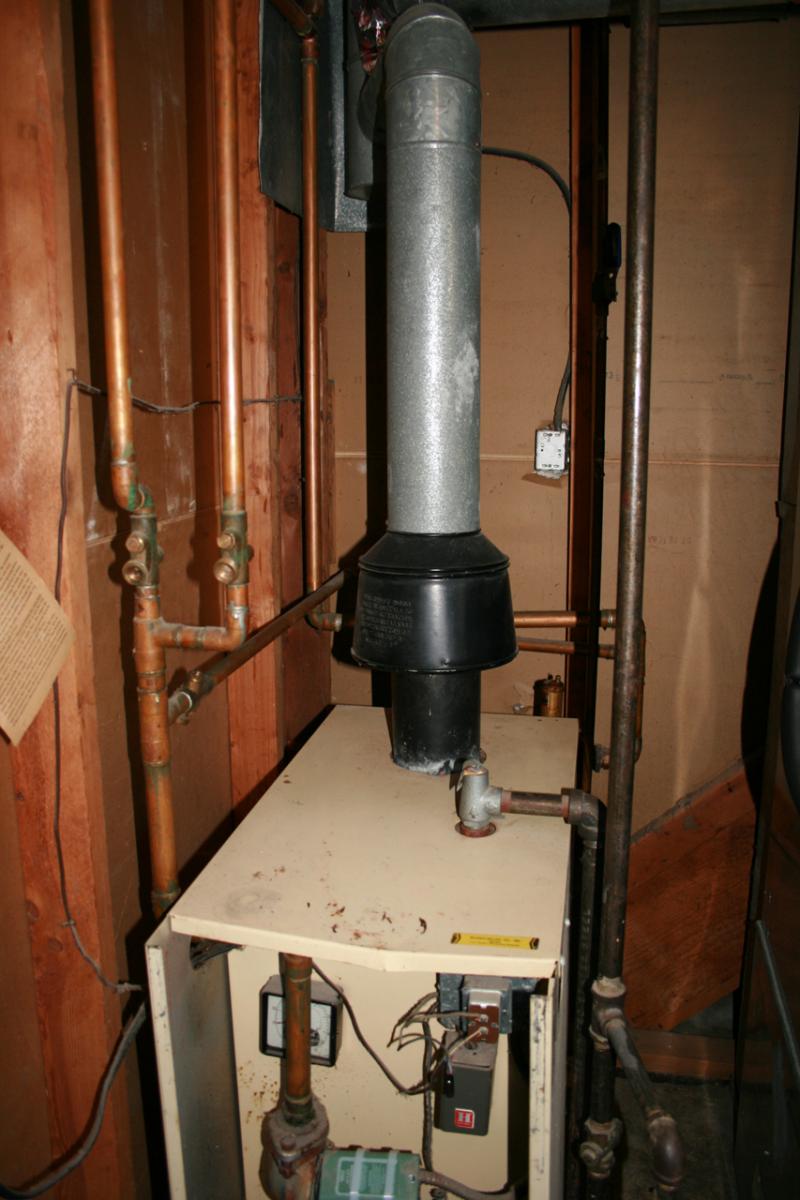

Hi everyone.
I recently purchased my first home, and now that winter is coming I am running into a bit of a problem - I have no heat!
I have a fairly old SolarLux G-105 boiler for my baseboard heating system.

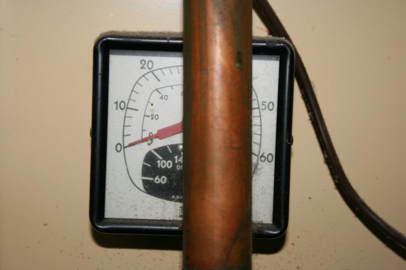

I have noticed that it shows 0 pounds of pressure on the gauge in front, though the temperature is showing as quite hot.
Now, I've read up and the recommendation seems to be re-pressurizing the system. Unfortunately, I am not entirely sure how to go about that, and unfortunately the boiler is so old I cant find much on it online.
So, I was hoping that you wonderful folks would be able to assist if I posted up some pictures.

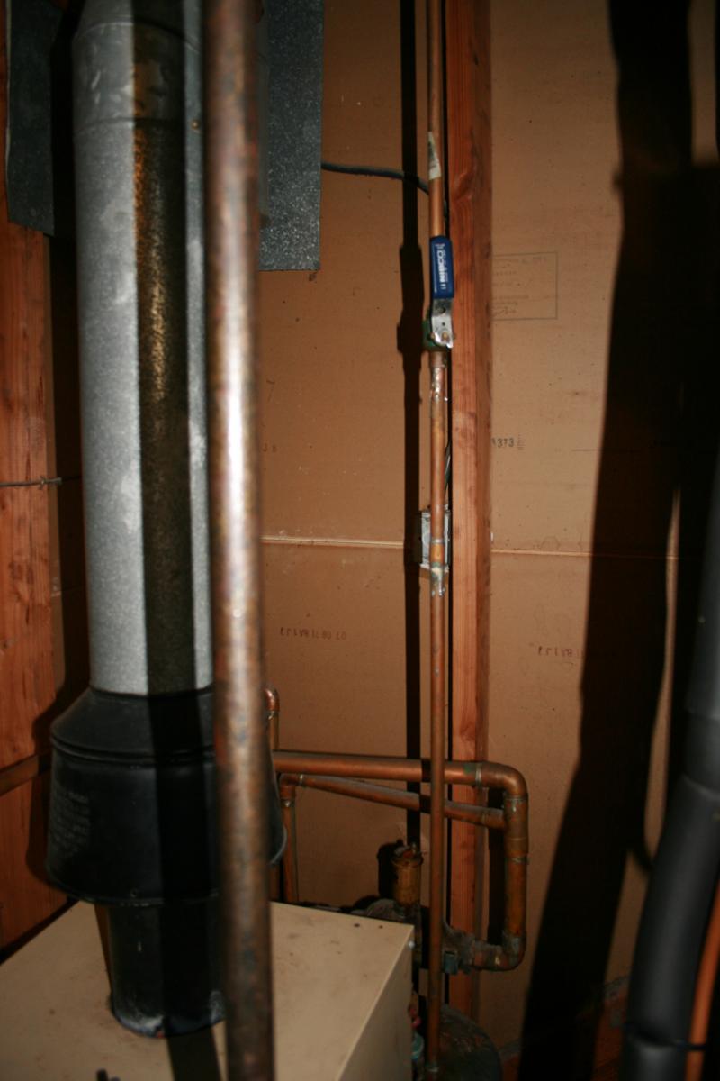

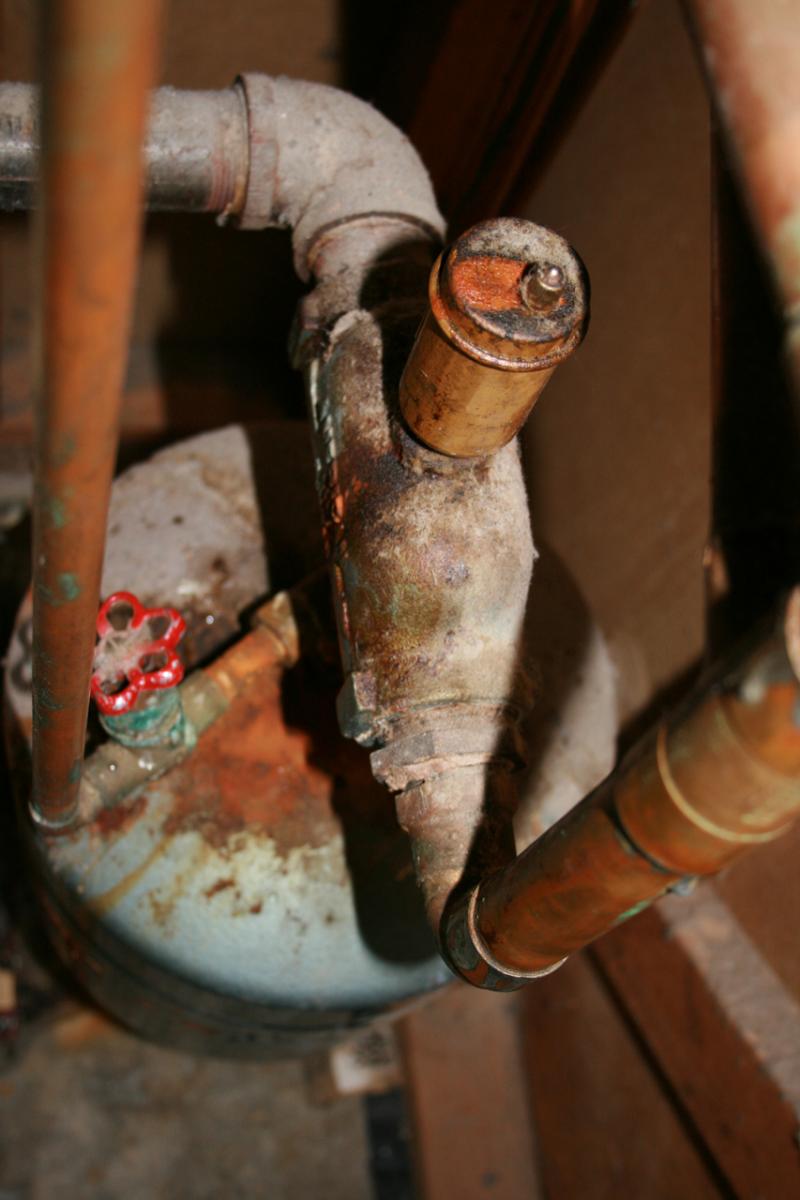

The blue handle and the red knob are both "open"
In the UK, all system filling loops are done with metal braided flexible connections - not sure if it's the same out there but i'd go looking for a flexi in the first instance
lol you're talking to an idiot here when it comes to this stuff, so I apologize if I ask dumb questions. my first home, and whatnot.
we have someone coming out to look at it next week (earliest we could get someone), but I'd love to be able to fix it in the meantime, as it's getting REALLY cold
have not been able to find any additional water source beyond what is in the pictures... and not sure how to fix that air vent problem
