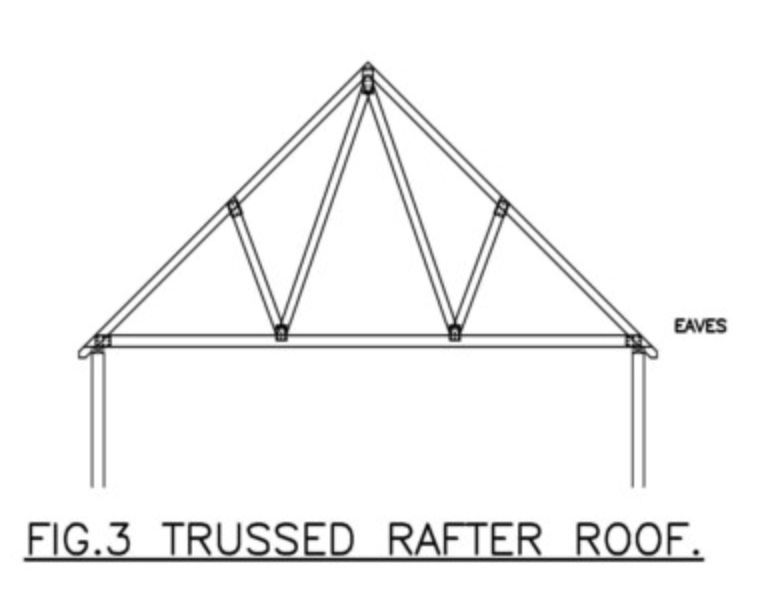

I intend to construct a cross joist loft floor for lightweight storage in my single storey home in France that has a trussed rafter roof (pls see attached figure). 1979 construction with no rot or damage. No water tanks creating additional loads.
The existing joists are 35wx95d on 600mm centres. The building is 8.4m wide, the maximum unsupported span is 4.3m in the region where the flooring will reach but this will stop at where the truss supports which are, a 2.80m central span.
I intend to make I-joists by grooving 10mm deep on 38wx47dx2400mm treated timber and 2400x120dx9mm OSB to obtain a joist depth of 175mm to provide a 270mm insulation void.
The floor will be Kronospan OSB3 16mm thick grooved and screwed to the I-joist.
What centres should my I-joists be please? 600mm seems appropriate, with diagonal cross bracing.
Thanks in advance.

My concern, apart from the obvious site gluing of structural parts, would be the excessive depth to width ratio. Are they going to be restrained? They'll need a lot of noggings to stop them twisting.
Thanks. I find it hard to believe I am working with excessive depth to width ratio. The numbers I offered are close that shown at https://www.jamesjones.co.uk/jji-joists/ where their ratio is even greater on depth. I understood OSB to be stable too. I agree the need of noggings; as I said, diagonal cross bracing. That is for lateral stability with the further benefit of preventing twist. The final element is the 2400x1200 OSB boarding screwed down to prevent buckling and creaks.
It is the spacing of the beams I need help with please.
For that flooring you'd normally need about 400 spacing, but if it's lightweight storage then you won't be sitting on a sofa up there, so 600 would be OK. But normally you'd consult the manufacturer of the joists also to confirm their suitability, or check the span tables for the grade of timber.
