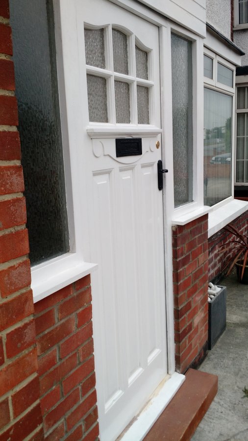

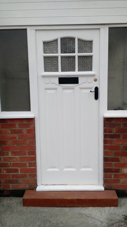

I decided to fit a nice new (old) front door to our house. It had a modern door on, and being a house that was built in the 920's I wanted a door to match.
I searched and found a suitable door that we loved the look of. I spent two weeks stripping and prepping the door, epoxying the cracks, replacing damaged wood work and extending the door.
So, after the painting and fitting of furniture was done I proceeded to fit the door tonight. And I messed up...

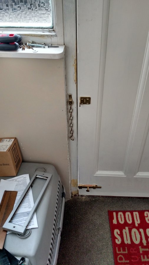

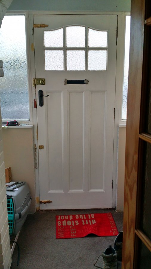

I was loosing the light and had to get the gap filled, so I had to chisel out the door step to get the door to close, a little gutted as I only replaced that recently, anyhow, that's not a major issue, and the door does close. The closing edge is perfect, fits a treat and has the same distance all the way, the level shows it to be perfect. But when shutting the door from the inside we now have an annoying wedge shape at the top where the door was obviously adjusted previously to fit a non-square frame, only just sitting inside the actual outer part of the frame by what must be 2 or 3mm.
I'm now wondering what exactly to do. What I should have done with the bottom is remove the door and plane the edge off so it fitted the existing step, but for some reason I was at that time convinced the step wasn't straight (even though it would appear it now was). So it's too late for the bottom of the door. It doesn't look uneven from the outside, but I am worried about water ingress or running to one side as the profile of the step is now slanted to the closing edge. Also I am not sure how to close the gap at the top. If I shim the bottom hinge it may lift it slightly, but at the detriment to the closing edge being perfectly even as it is now.
Basically I screwed up, I should have made sure the top was level and the surface I was using was level, and took additional measurements from the glass to the edges to make sure it was square, instead of relying on a few quick checks with the spirit level on one surface. As a result I have fitted a door that has a slanted top and bottom by approx 8mm into my square frame, and the result is an adjusted door step and a gap at the top closing edge :/ It does all work, and looks fine from the outside, but from the inside it looks shocking, the wedge gap at the top and the blatant slant at the bottom. I'm not sure on weather and water ingress either as it stands.
If anyone has any suggestions of how to rectify my cock up it would be appreciated. Right now though, I am not sure what to do, whether to take the door off, build the step back up and plane the bottom, or leave the bottom as it fits and carry on fitting a weather bar and sweeper. As for the top, I really don't know. I restored the door and the finish is perfect, adding a wedge to the top of the door, then trying to blend it in and repaint the top of the door will no doubt lead to an uneven finish. I could put a packer on the top of the door frame to close the gap but that is annoying, as the frame is perfectly straight :/
