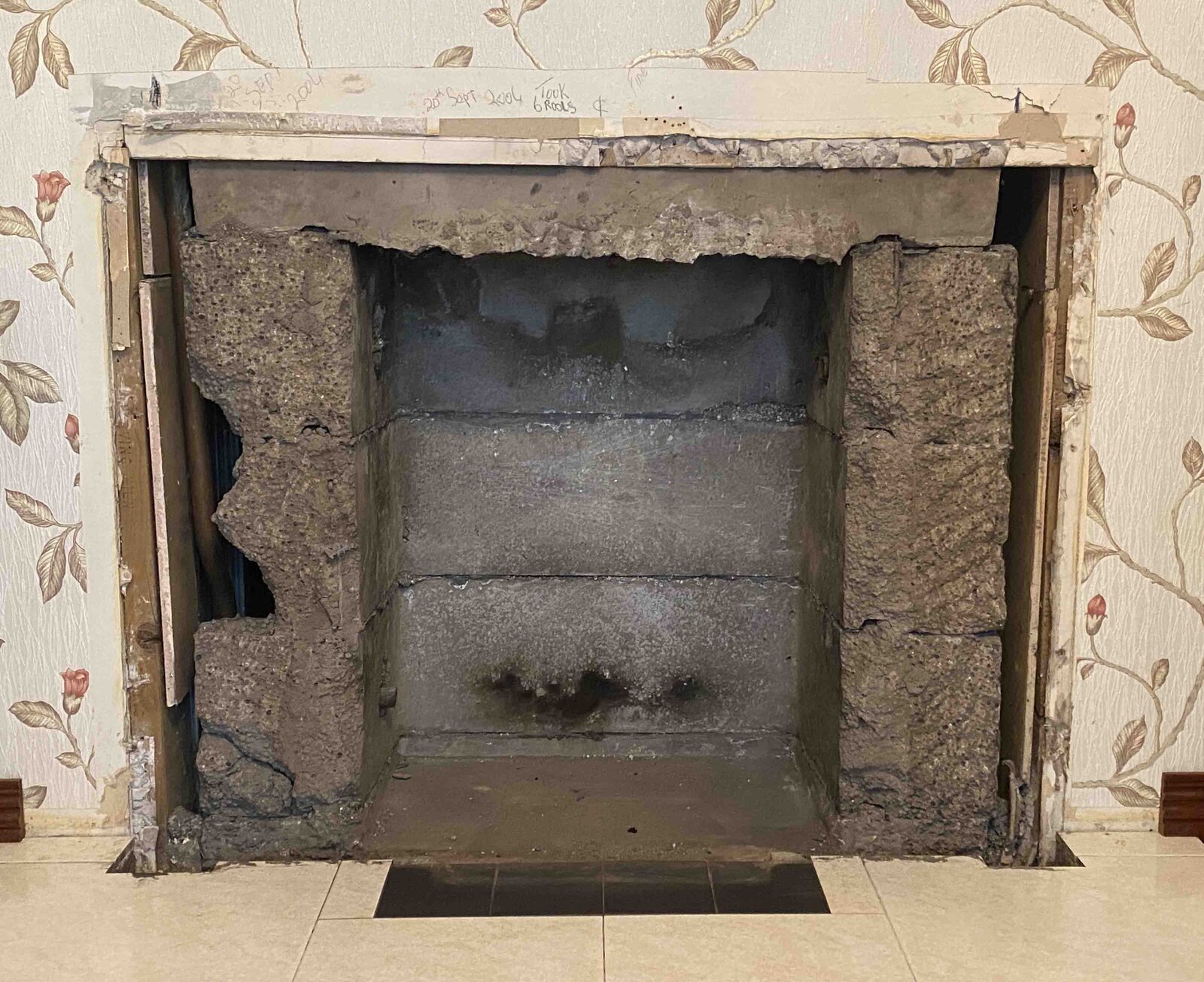

I have a timber frame house and the back boiler had these precast concrete slabs wrapped around it.
I'm wonder is this 600mm opening wide enough for a wood burner?
The smallest stove I see is 499 mm wide but I'd want to tile or put something on the inside

of the opening.
I see a tile affect that is stuck on the inside of the opening and that is about 20mm thick.
Your thoughts please.
Thanks.

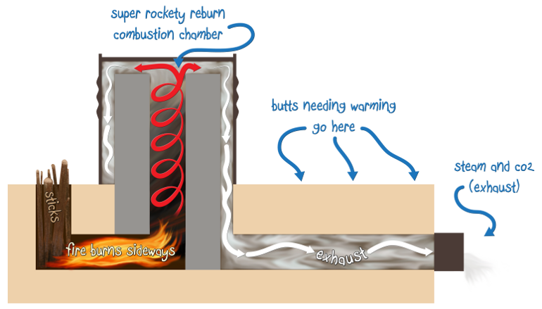

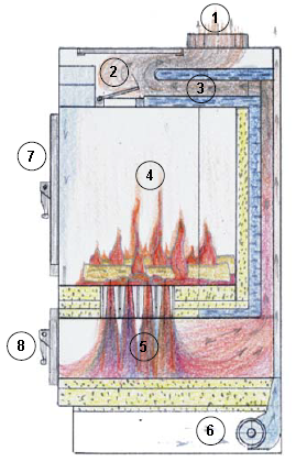

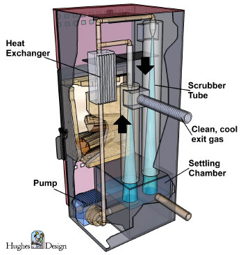

Wood burner covers a massive list of fires, these are all designed to have a very cool flue Hughes Condensing Stove 2 small.jpgrocket-mass-heater-diagram.pngwallnoefer.PNGthe first two are condensing, and the latter also burns super efficiently, but other than the rocket centre which is a DIY type the other two need electric to run, and my question which was not answered was what happens with a power cut?

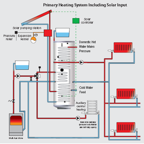

My dad looked after multi fuel boilers, it could run on blast furnace gas, town gas, oil, or solid fuel, however it never used solid fuel all the time he looked after it, but it was also rather inefficient, it was used as it basic burnt waste produces, when the coke ovens closed so did the power station, but to burn multi fuels the burner needs adjusting for each fuel, most woods and coal have around the same calorific value per unit weight, but the burner is restricted by volume not weight, so the volume needs adjusting to match the fuel.
Burning coke or charcoal is OK as all nastiness removed, but wood and coal need very careful temperature control to reduce emissions, too hot and waste heat, too cold and nasty stuff in flue gases, this means they have to burn at a set rate, so the normal is to have water heating so energy can be stored and released as required, these systems Torrent pipe example.PNG seem to be the bees knees, and my brother-in-law had one which did work very well, installed as the house was built, so no problem having a reinforced floor for the twin massive water tanks, however when he moved, and looked at fitting one in new house, well rather an old house, the cost of install was simply silly, with quotes in excess of £10,000 to install.

I spoke to my stove man and apparently the opening isn't wide enough, pity. I might have to go something electric instead.
