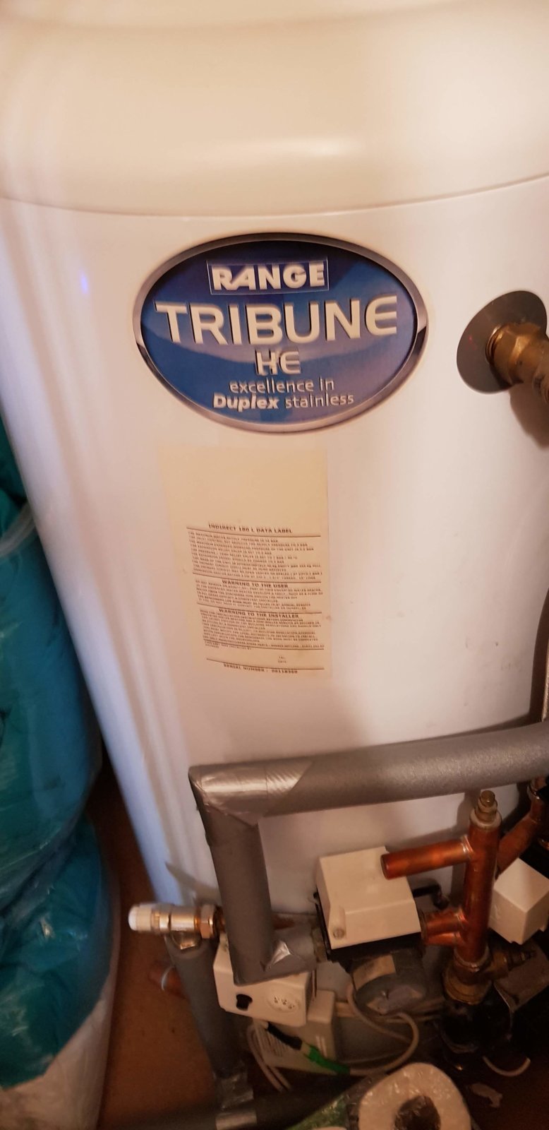

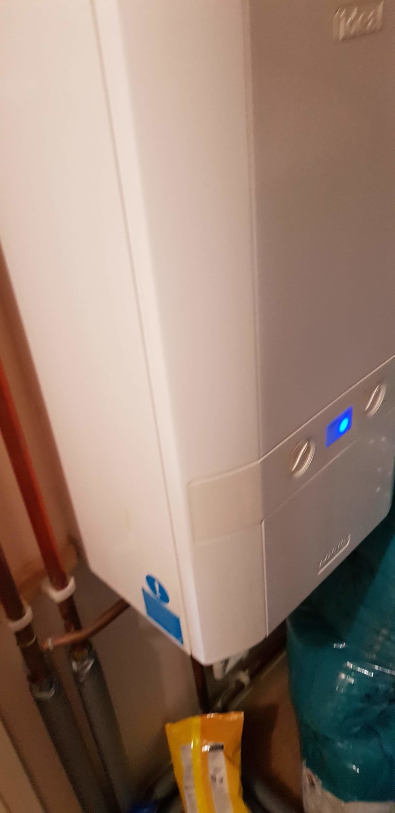

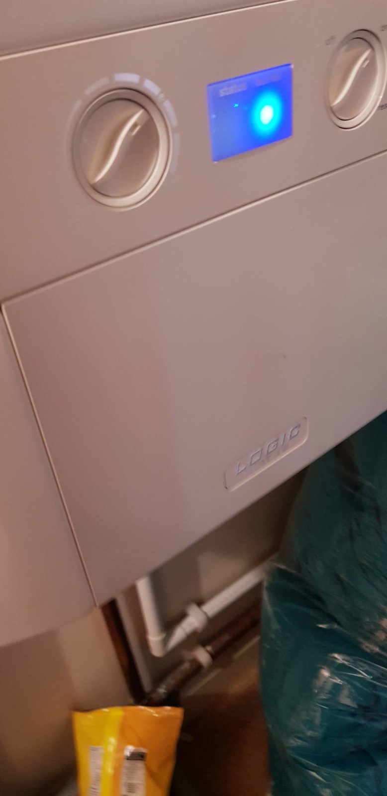

Hi all,
Can you please help me identify the setup in the attached pictures?
Is it a system boiler + cylinder, or is it a regular boiler + electric cylinder or something else?
I apologise in advance for the bad quality of the provided images.
Thanks.
You have an Ideal logic system boiler with an unvented HW cylinder, the cylinder is heated by the gas boiler and are usually very efficient, its a decent enough system very common in new builds
