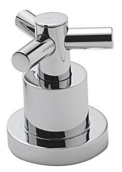

I cannot believe im asking this question as im pretty good when it comes to stuff like this. However, on this occasion im stuck.
I have one of those waterfall taps for the bath controlled by two independent taps. The tap is leaking and i assumed changing the washer would be job done and browny points for me...HOW WRONG WAS I!!
I have attached a pic of the tap in question. I know you release the top cap protecting the screw, unscrew the screw but then after, how the hell do i expose the washer. Is this particular tap one sealed unit meaning im unable to replace the washer??
If anyone could give me guidence on this particular annoying question that would be excellent

Do you know what make it is? It looks familiar but I can't put my hand on the details.
K
i have no idea. They were installed 4 years ago along with the whole bathroom, probably some cheap chinese crap.

It looks like something I used to get from a supplier who is up your way, I'm trying to PM you their details but your messages are set to private....

The mechanism - and obviously the washer - is probably under the surface, not inside the bit in your picture.
if its under the surface ive had it. i have no chance of getting to the pipework. I have already began the search for a new single column bath tap which i can mount in the corner of my bath, then cut out the existing taps and cap the holes.
