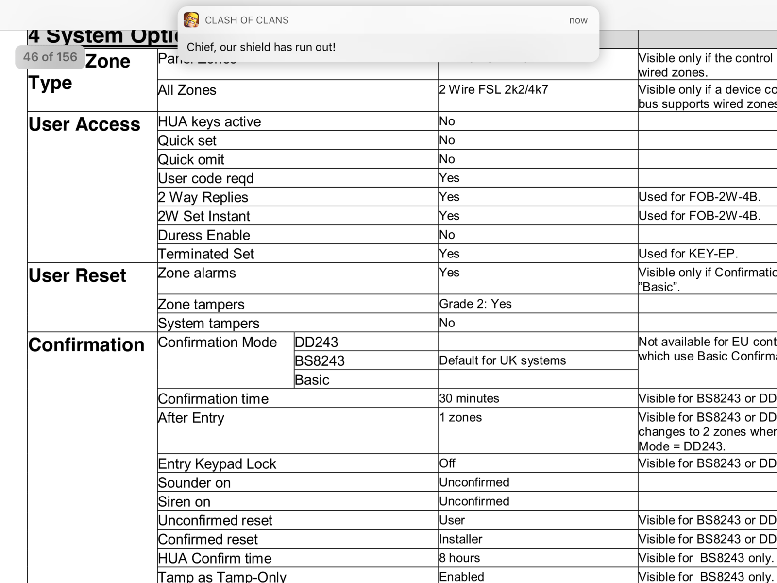

Hi,I am finding that my i-ON 40 burglar alarm is going off randomly (in the middle of the night of course. I only have the user code & not the engineer code. As the battery is a few years old I thought I'd replace it, and then if that does not fix it I'd check the sensors for insects, etc. Can all this be achieved with just the user code (I don't mind if it sounds when I remove the tamper front panel as long as the user code will reset the system after). Any advice will be most appreciated

Hi, the log says Burg Z02 Alarm when it went off on both instances
I don't know which sensor is Zone 2 though. If I undo each sensor cover in turn, Zone 2 will become apparant on the control panel I guess. Will just have to hope that the user code will permit reset. Then I suppose replacing the faulty sensor would be appropriate, unless there is something obvious like a spider or dead fly on it.
Thanks Sparkymarka, using the walk test as you suggested, I have established Zone 2 is the hallway. I guess that means I should open up the sensor & if no obvious reason for failure I should perhaps change the sensor. Is that a straight change out or do I need an engineers code to set it up?
It MAY be programmed for engineer reset in tamper ....your not going to know untill you take that pir lid off , it MAY also be programmed for engineer reset for control panel tamper so it's the risk your going to have to make , go for the pir lid first...
