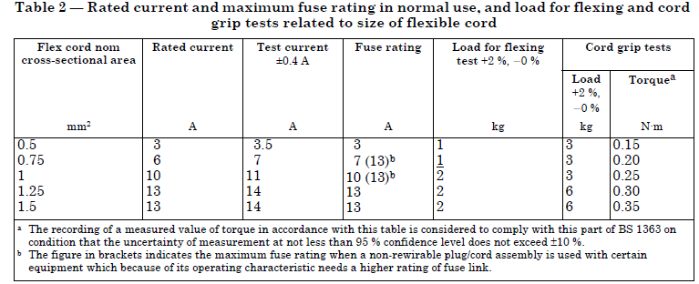

I had an issue PA testing a brand new electric fire for a customer that had a 0.75mm² lead and a 13A fuse in the plug.
I failed it, as the regs say 0.75 flex should be protected by a maximum of 6A, but there is a discrepancy between 7671 and whatever guidance appliance manufacturers are working to. Their rules state that plugs on appliances with a 0.75mm² lead can be fitted with a 13A fuse.

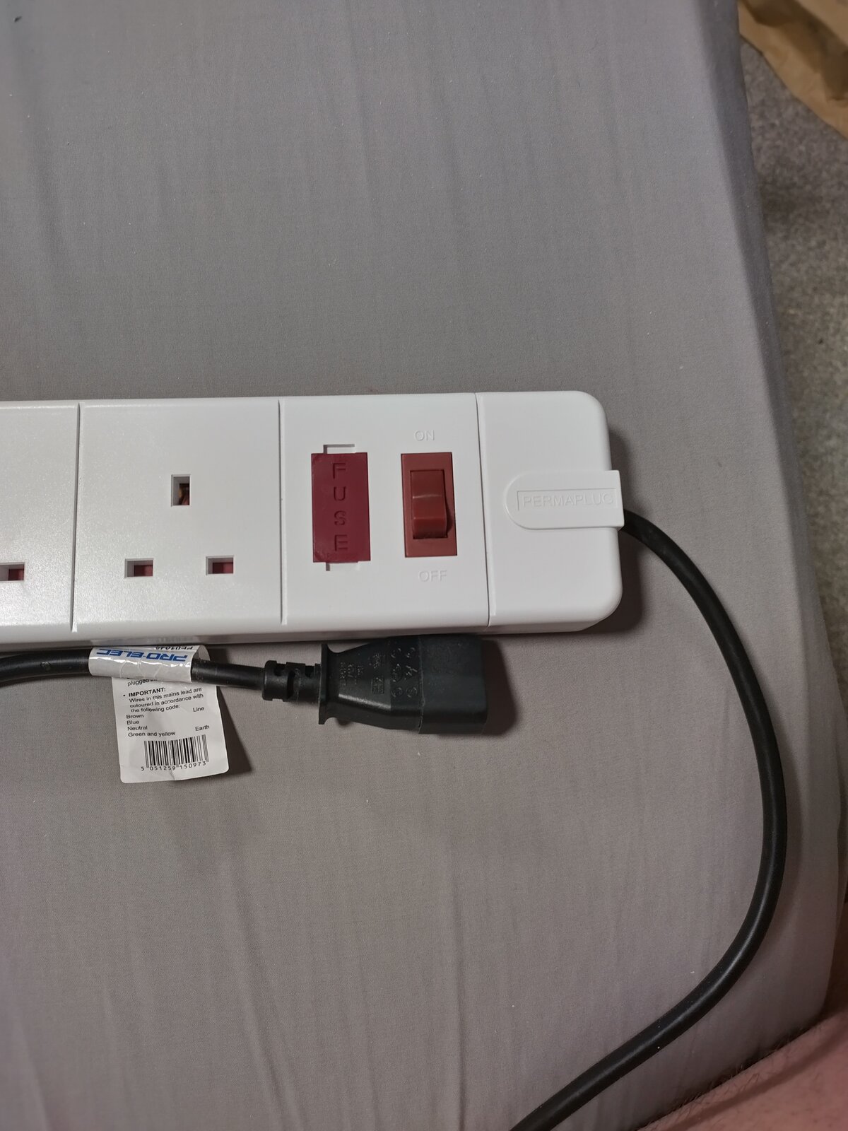

Here is an extension lead I made for use in NZ. I also had a 5m lead to extend the length if necessary and a lead with an (unfused) NZ plug rated at 10A. All the flexes are 0.75mm², so I fitted a 5A fuse in the 6 way.
What sort of 'electric fire' and what power?
If it were part of an electric installation (which I realise it isn't), then BS7671 would say that if the nature of the load was such that it was unlikely to create an overload current (which I imagine would apply if there was just a resistive element and no motors etc.) then no overload protection of the cable is required at all - so a 13A (or any other rating) of fuse would presumably be acceptable (and would provide adequate fault protection).
Which regs are you talking about - BS7671?
Indeed so. Whilst Note (b) doesn't explain what "certain equipment" it's talking about, it looks as if, were your PATesting being done "to BS1363" (which I presume it isn't), and if the plug were non-rewirable, then a 13A fuse protecting a 0,75mm cable might well be OK?
