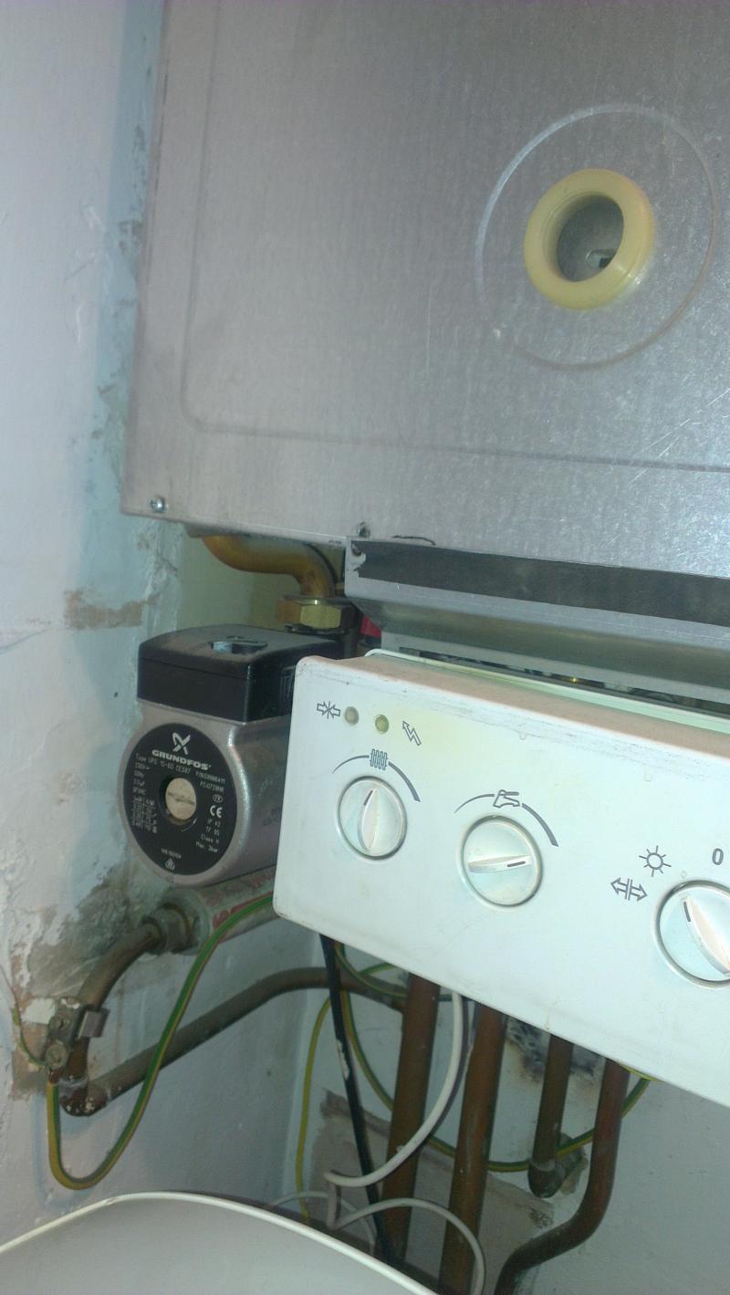

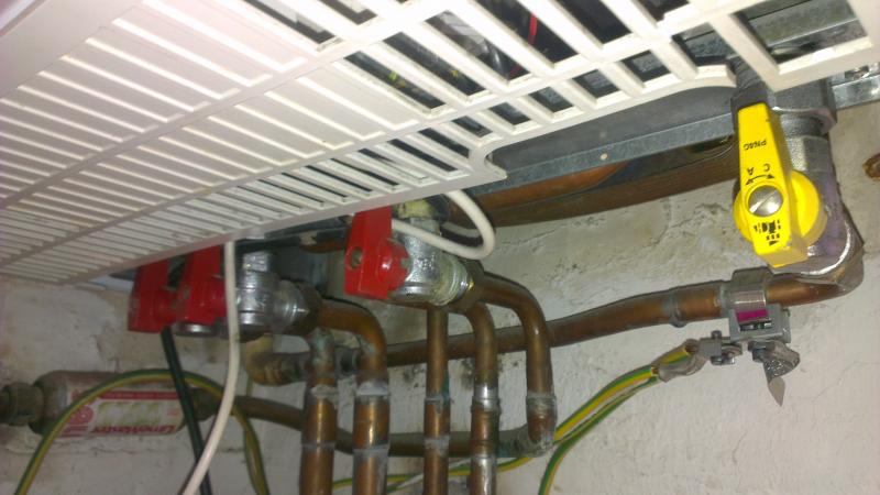

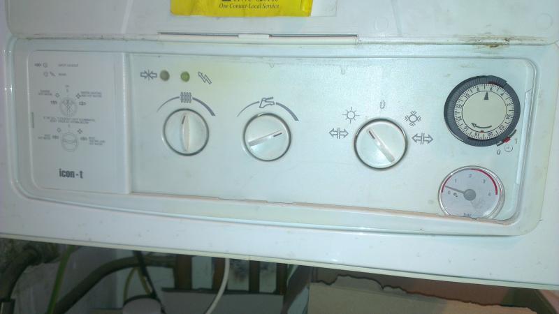

Hello,
Any help with this would be really appreciated.
Our boiler has stopped working. Still has power but the pressure has slipped to under one bar. So well into the red.
I can't find a manual for the model online (an Icon T).
I've attached a few photographs below.
With previous boilers I've had, when the pressure's slipped I've turned the valve to bring it back up and reset it. Always worked.
I can see four valves and have tried each but that hasn't worked.
If anyone has any ideas, that'd be really appreciated. We'll call someone tomorrow (as it could do with a full service anyway) but hot water would be nice today :)
Thanks,
Eoin
U will need to start looking for a filling loop away from the boiler trace/follow the cold water main until you find it
