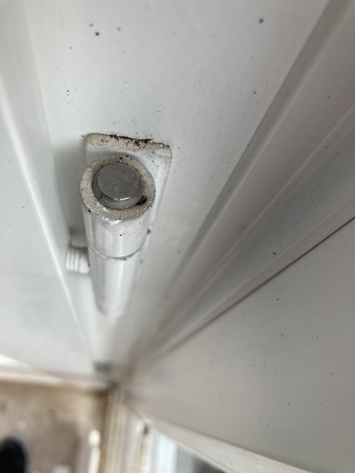

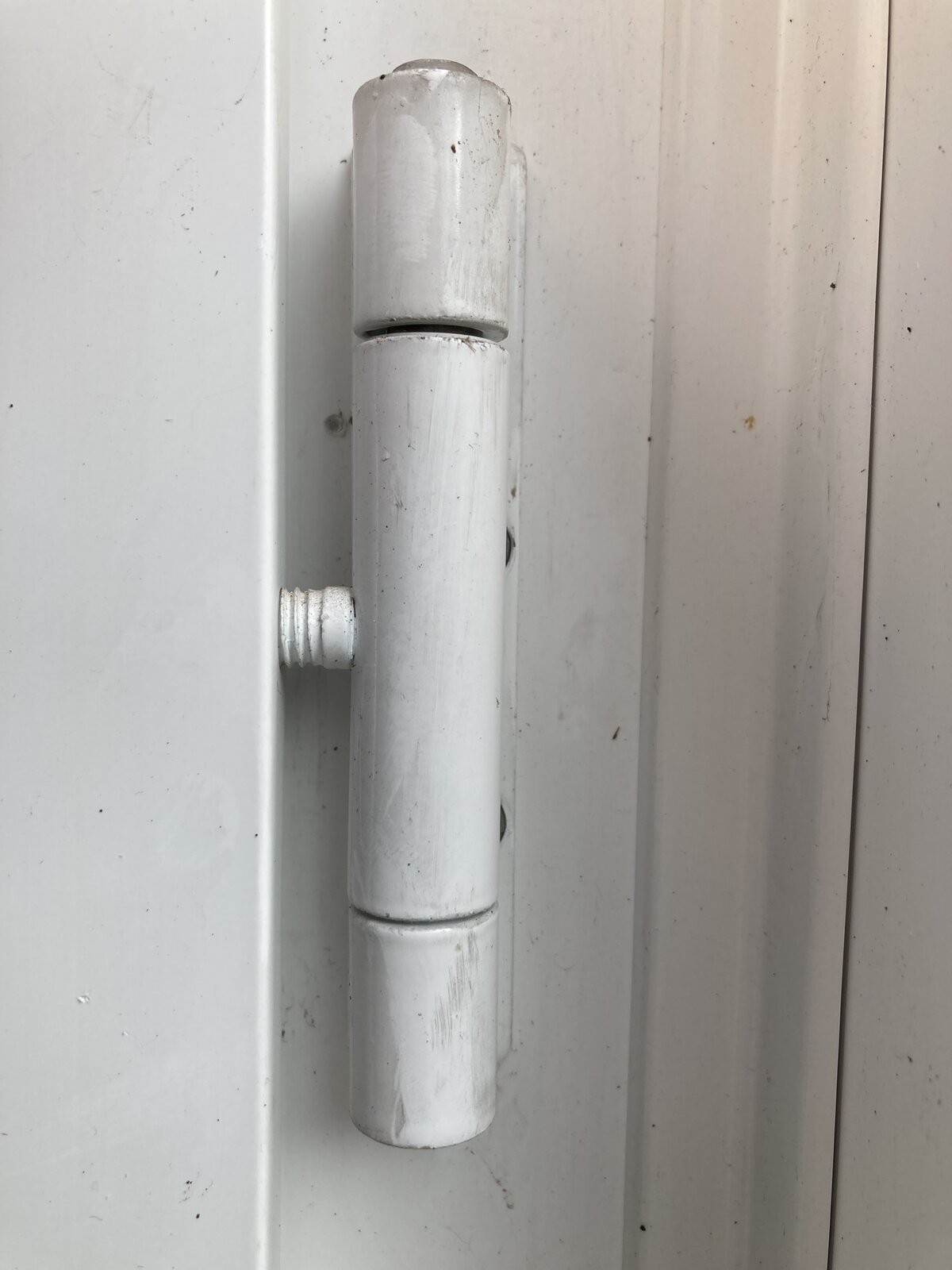

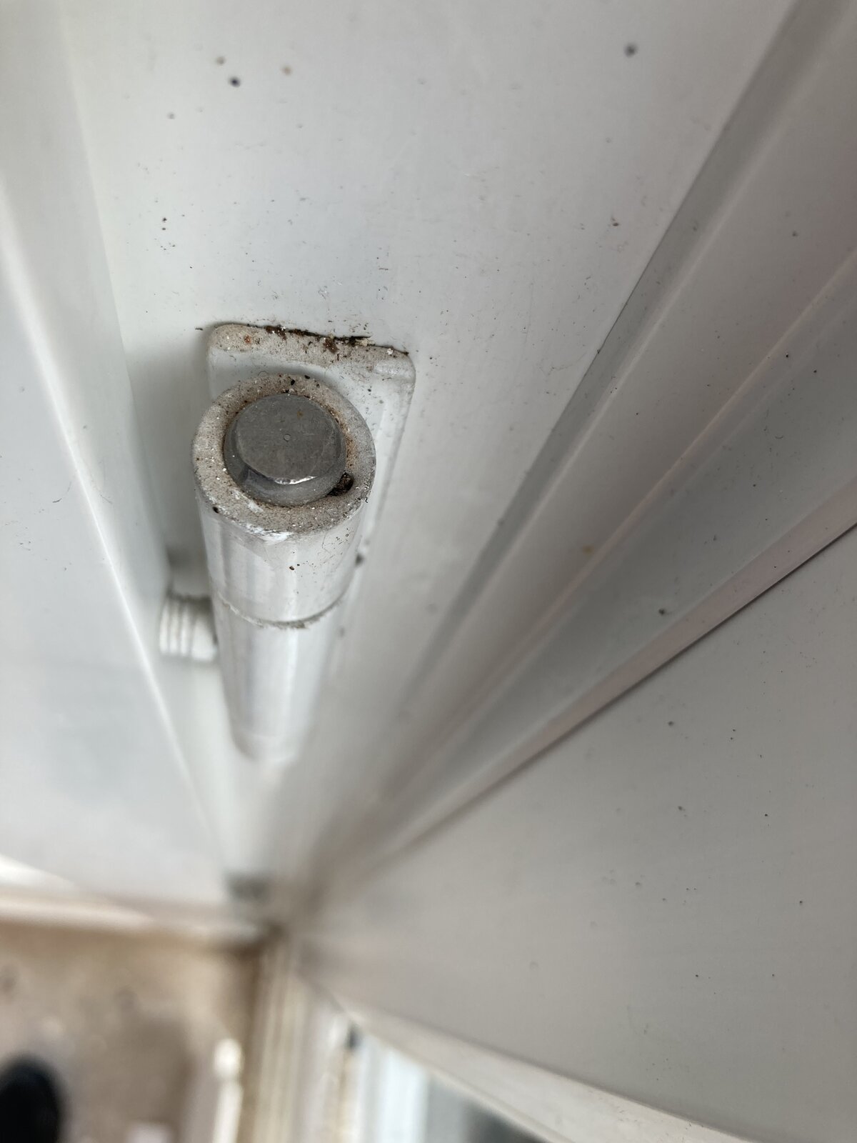

Can anyone help ID this style/mechanism? Need to figure out how to adjust as door lock no longer lines up.
You have to knock the hinge pin up and out and then turn the centre portion in or out depending which way you need to move the door
