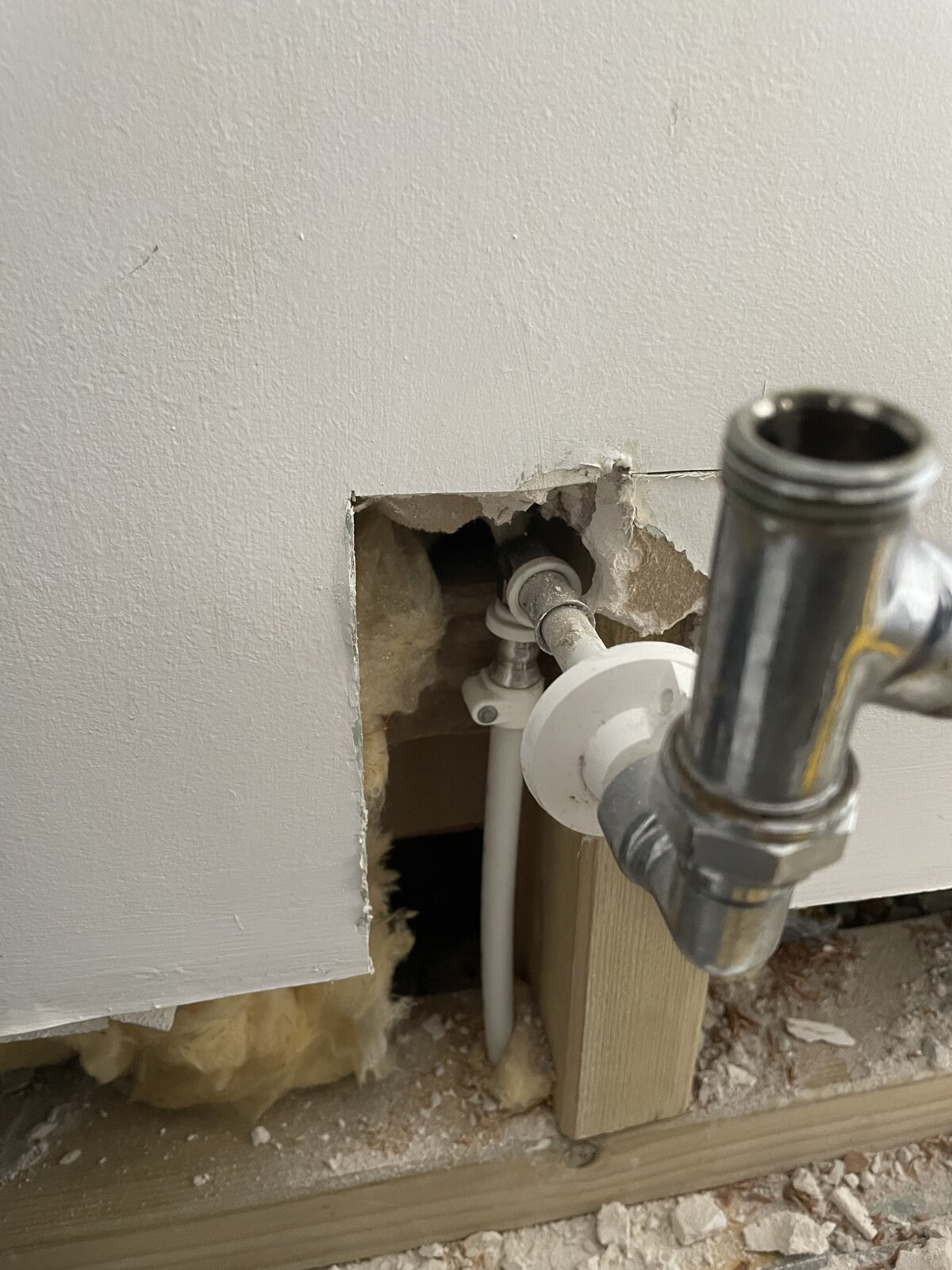

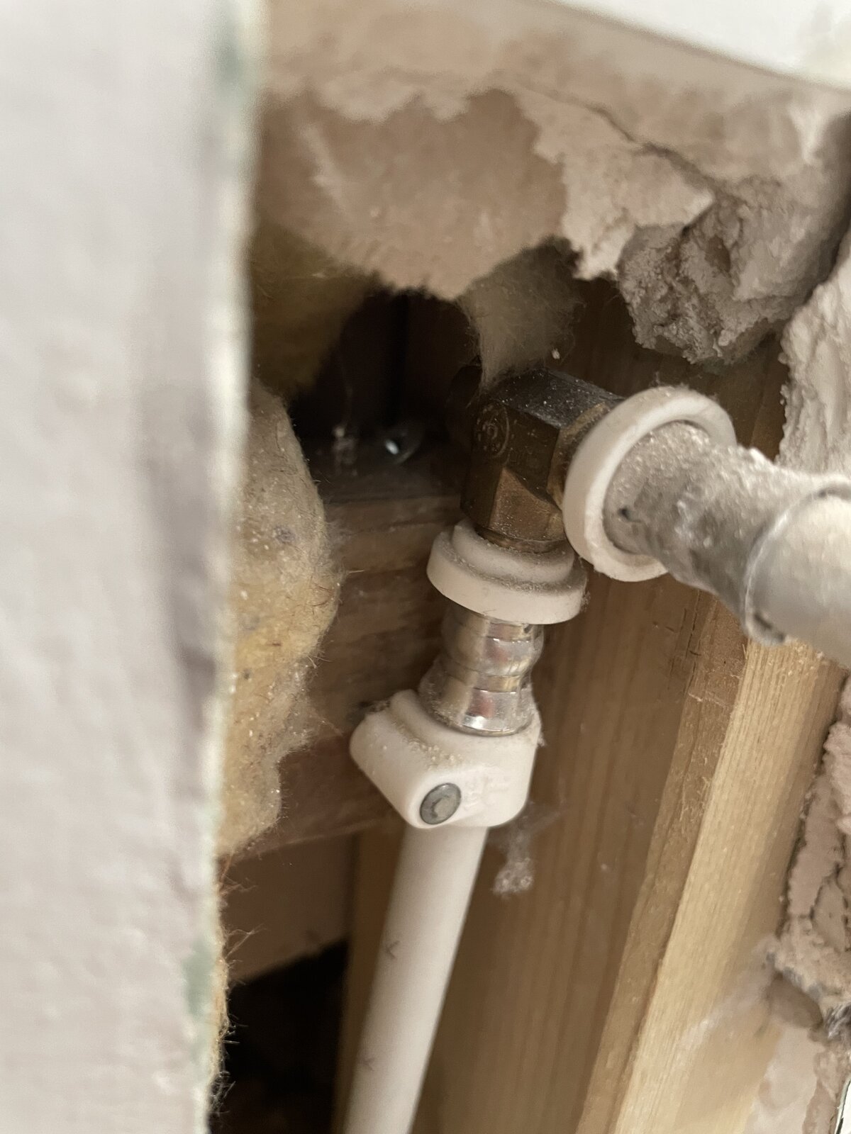

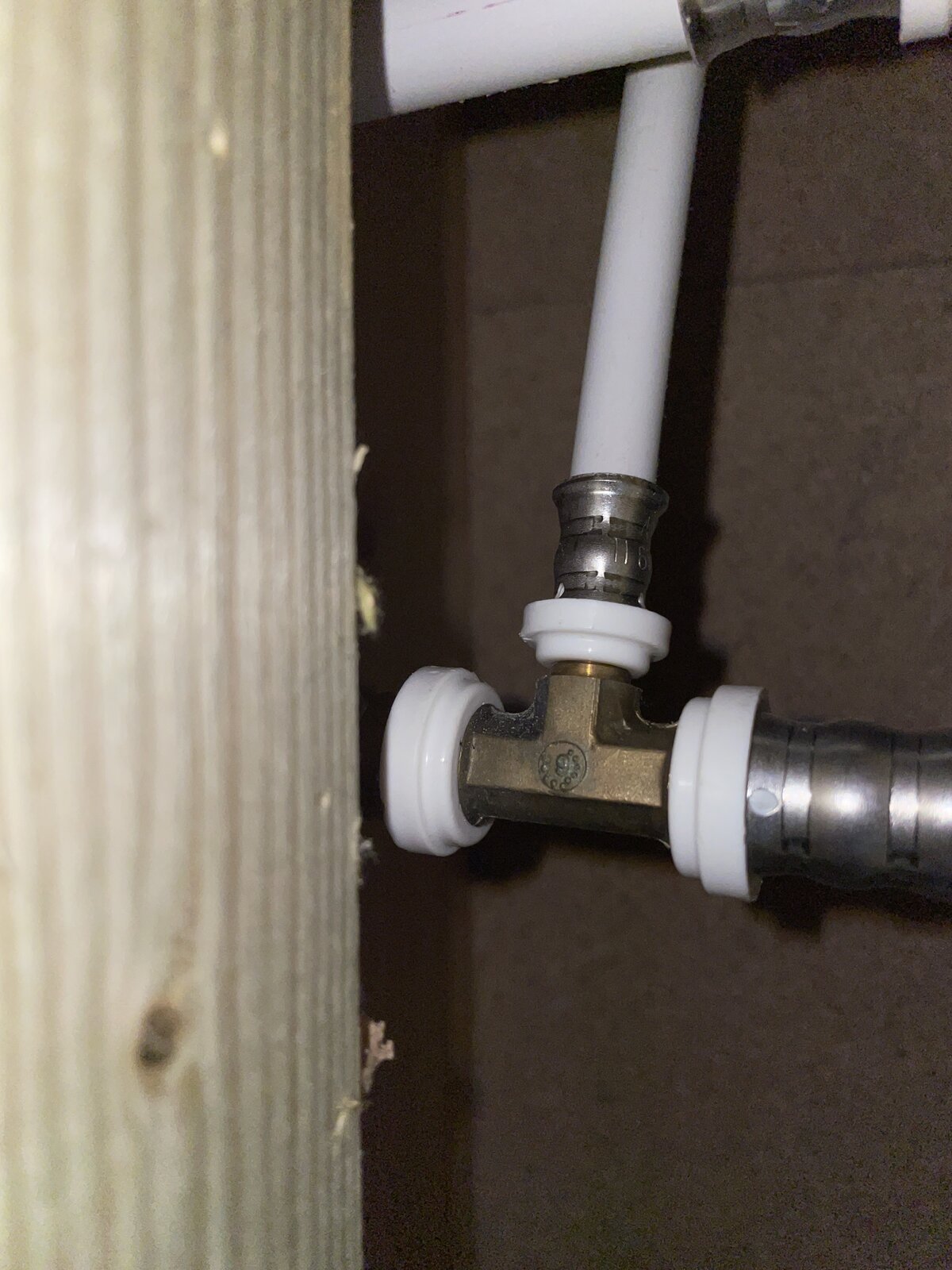

ID push fit brand
19 Dec 2012
10
Kent
Hi, I am in the process of moving some radiators around and I’m trying to ID the brand of push fit connections. They look completely different to the JG stuff and I’m wary about mixing brands. The pipe is 10mm and I have already moved one downstairs that required changing the length of pipe. I did use the JG inserts for that, but getting them in the plastic pipe was a nightmare as it was a super tight fit… Many thanks in advance.
I think those are crimp fit connectors, not push fit. Once you have identified them, you will probably find you need a special tool to fit new ones.
Look like a crimp system and as such will not be demountable, another thing to be aware of is a lot of MLP systems are imported and may not be ”standard” UK sizes, instead of 15mm, 22mm and 28mm you may find it’s 16mm, 20mm and 25mm.
