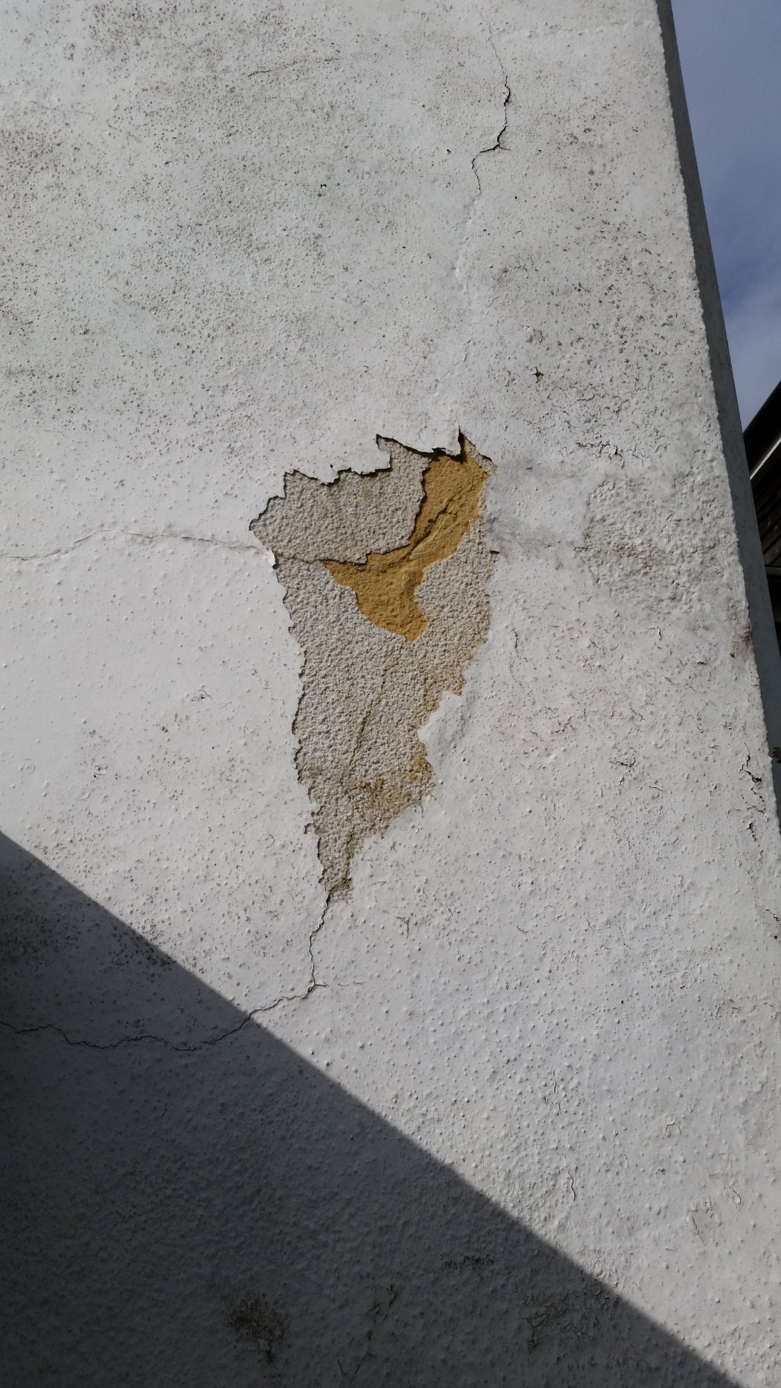

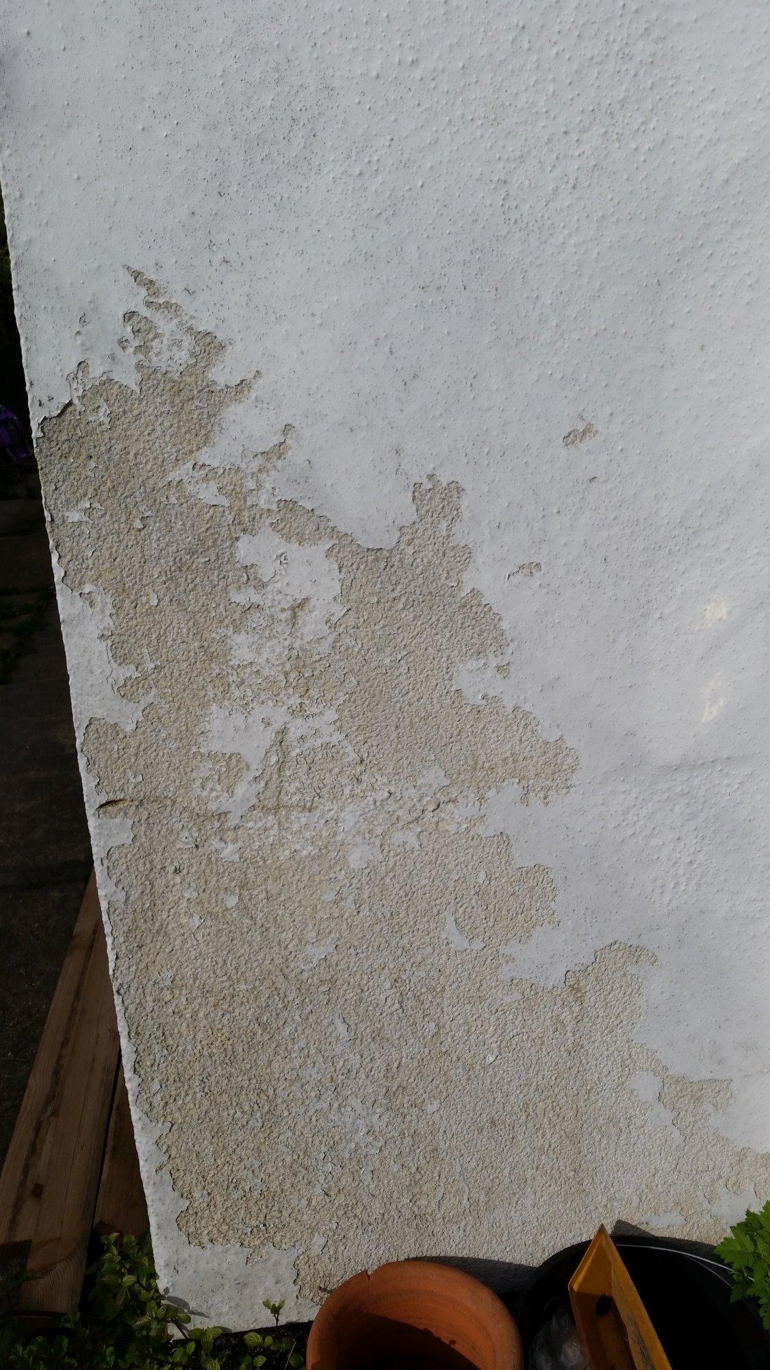

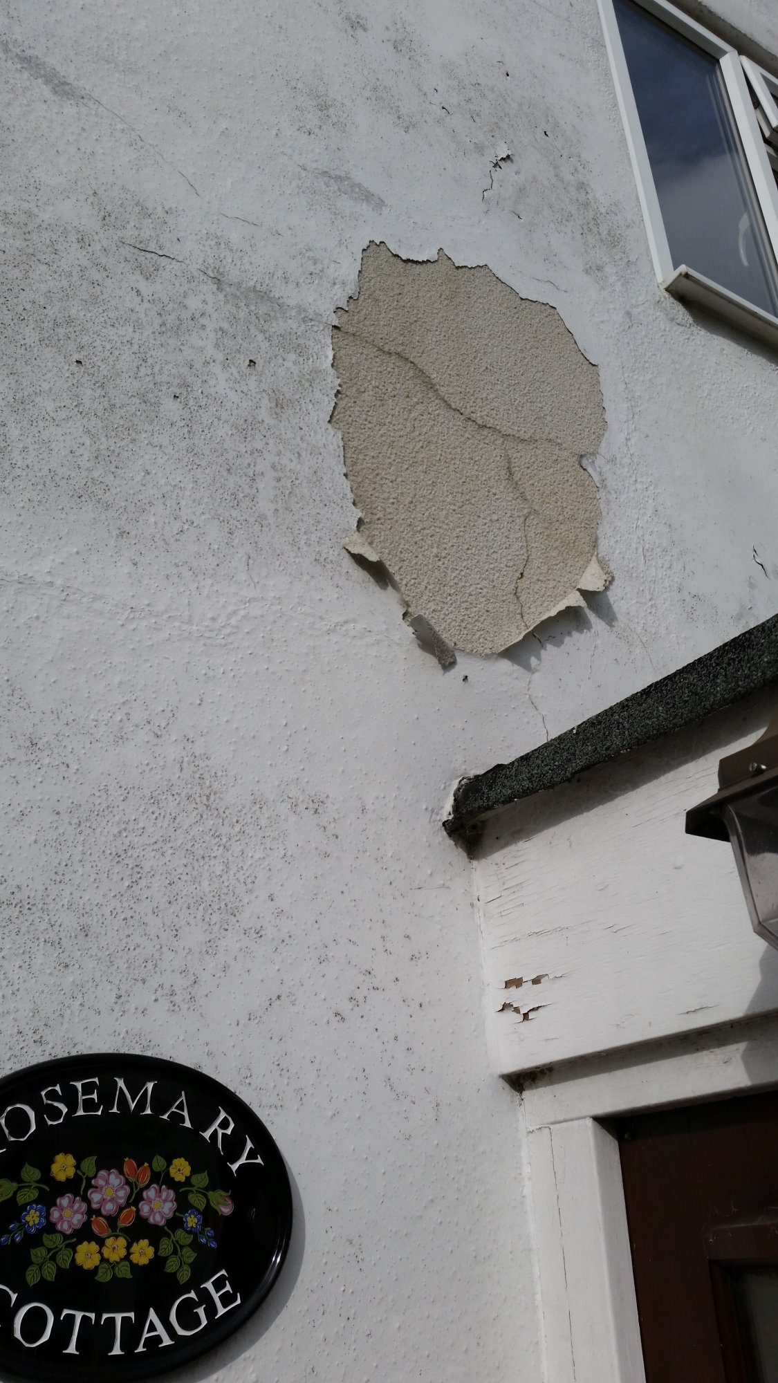

I've got an old house with some internal damp problems and I see the render as a prime suspect. I would like to identify what sort of render it is... as I suspect that the solid brick wall has been rendered with a non-breathable Tyrolean render and then covered in plastic paint.
I've attached some photos of where the paint and render is coming away.
Is anyone able to confirm:
1. That it's plastic paint
2. Whether it's breathable render or not?
It looks like a cement render that hadn't been done properly (hence the cracks) but cement render won't cause problems if there's adeqate ventilation inside, so what sort of problems do you have inside.
OP,
As you noted, there is a plastic paint over a Tyrolean texture.
The Tyrolean was applied to a background that looks extremely friable - what that orange coloured mix consists of I dont know. Perhaps a local render using washed building sand?
There are cracks galore - some of them running from the corners of openings, & some cracking in horizontal lines.
If the cottage is a brick build then the horizontal cracks are following the beds.
Details & pics of the interior damage/cracks/damp might help.
Is the whole cottage brick built, no stone been used?
Are the walls solid or cavity?
A 5/10 possibility is that all must come off to expose the brick surfaces & repair the cracks but it might be possible to simply remove the Tyrolean and with it the paint. It depends on whats happening inside the property?
FWIW: The fascia on the porch(?) is water damaged.
The PVC window has been installed on the face of the building instead of being installed approx 75mm back frm the face of the elevation.
