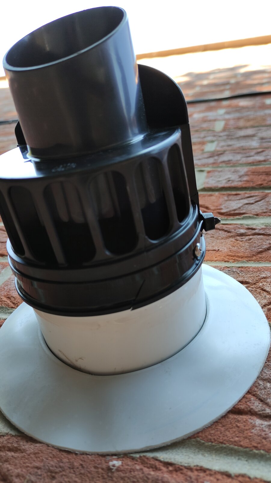

Evening all,
I have an Ideal C24 HE Mini, and the tip of the boiler flue on the outside wall had disintegrated as it had gone brittle over the years. Decided it was best to have a new flue fitted, and understood that the tip of the flue was a part of the flue itself, and couldn't be replaced independently.
Local Gas Safe chap came highly recommended having done work for family, and was very pleasant when he came to do it. He then left in a little bit of a hurry, but had other jobs, so thought nothing of it. Had chance to have a quick look before he left, and it was immediately obvious that the flue stuck out further than the original, so you could see the white pipe behind. I pointed it out, and he reassured me all was ok, so I took his word for it.

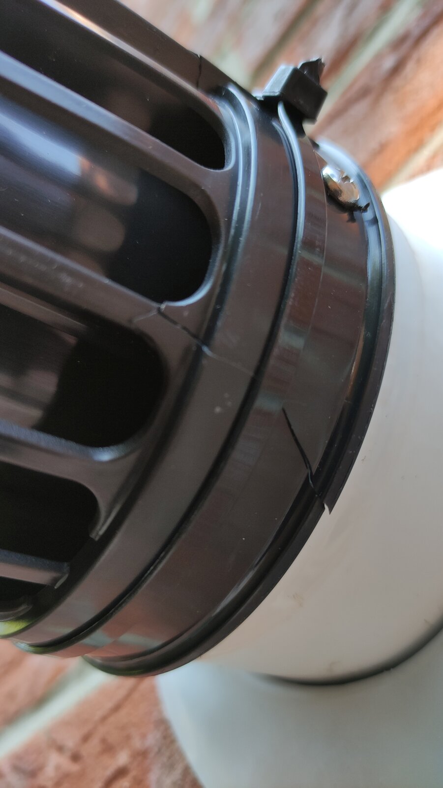

About 20mins later, I popped back out for another look and spotted that some cable ties had been used on the end of the fitting. Basically, the end of the new flue was badly cracked, and he'd cable tied it up and gone on his way, clearly hoping I didn't notice. I immediately emailed him and he replied shortly after saying he would fix it.
At this point, he's lost my trust, so I called Ideal's technical line this morning to query the white flue pipe sticking out of the wall. They were very helpful and said in no uncertain terms that no white pipe should be visible as this part is not weather or UV resistant. I assumed it was just a standard length part, but after lifting the lid on the outside bin later that evening, I found the end that had been chopped off. He'd obviously cut it wrong and hadn't bothered to re cut it.
He's contacted me to say that he has sourced a new tip for the flue and he will fit it this week. Alarm bells are ringing however as I'm sure that I have read that this part is not replaceable independently of the flue. Can anyone confirm please? I don't want to end up with a bodge job.
Credit where credit is due, he's offered to fix the end of it, although he obviously thought I was stupid and wouldn't notice, which has insulted me a little. I have requested that the length of it is also corrected and am awaiting a response, but I'm positive that this needs to be done.

Yes the terminal can be replaced, it's only a couple of screws holding it in place, but the flue does need to be cut to the correct length. Normally it's a black weathering collar on the outside too, not a white one. He might be best off buying a complete new flue and starting again
Finally came back to do the job properly. Or not. To break the flue free, he had to hammer and chisel the cement from around it. As I suspected this has damaged the new flue pipe visible on the inside. Not the end of the world, but not happy with it. In addition, you can tell that the terminal is different to the original. He's fitted a Baxi flue terminal to the end of the ideal flue. Again, it 'fits', but I could have done that my self and the point is I paid for a proper job.
Spoke with the manufacturer again who said it's not right. Spoke to Gas Safe (didn't report him at this stage) and they said it's also not right as you shouldn't be mixing and matching different manufacturer parts. You can see where he's had to chop the internal pipe in the flue to make the terminal fit.

Your man needs to admit his error, buy a new Ideal flue, & cut it to the correct length, it's really not difficult.
There should be no white on show, & it must be an Ideal flue.
Yup, don't see what his problem is. It's not rocket science for a seasoned installer to fit the flue correctly, it's just about making the right measurements and cutting properly. Is the flue at an easily accessible height?
Also trying to remember with the Mini HE but I'm sure Ideal's standard flues have the plastic flue terminal fitted inside the outer flue. There are 2 holes on the outer flue and plastic lugs on the terminal pop out into those holes to hold it in place rather than it's screwed on. Someone may be able to confirm for the Mini HE though and if they're still available?

That is the flue is have fitted on a Logic, Logic plus and vogue boilers. terminal in OP’s post does not look familiar
Actually, the more I look at it, the one in the pic look like a Vokera flue TBH. Only one I can think of that has a screw/rivet though the terminal. Either way it's not right and TBH if that's what he done then I wouldn't be having him back. You can't use other manufacturers flues, it has to be right.

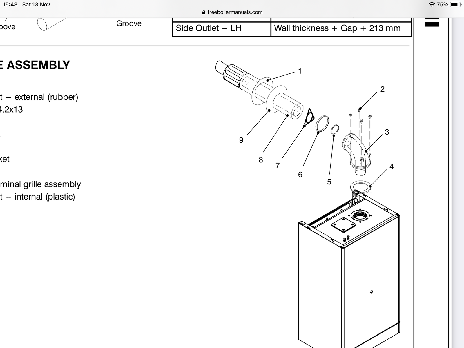

Suspect inner duct should be alloy, not plastic. Terminal too, would that not need to be alloy as heat from the heat exchanger may well melt the plastic terminal; while picture above does not indicate that, might be prudent to check with Ideal.

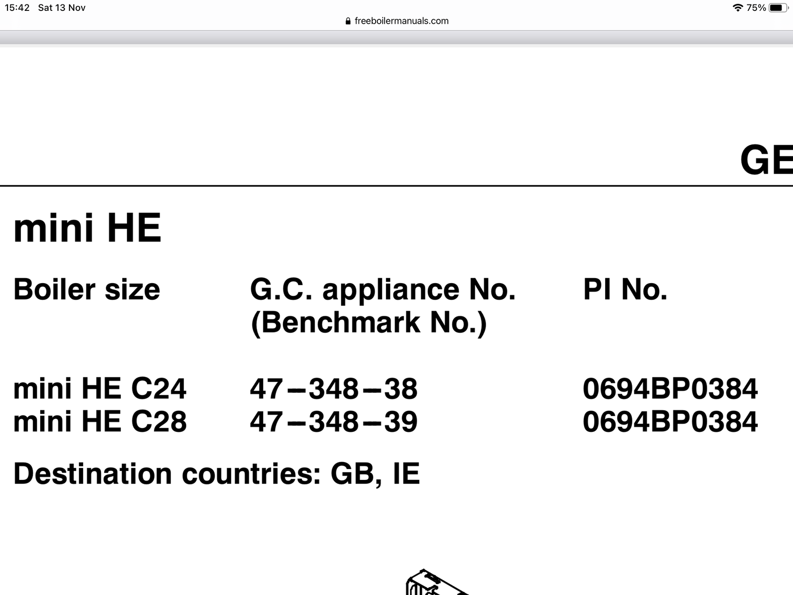

Other screen grab is boiler and GC number, OP check if the number is correct as per label on your boiler

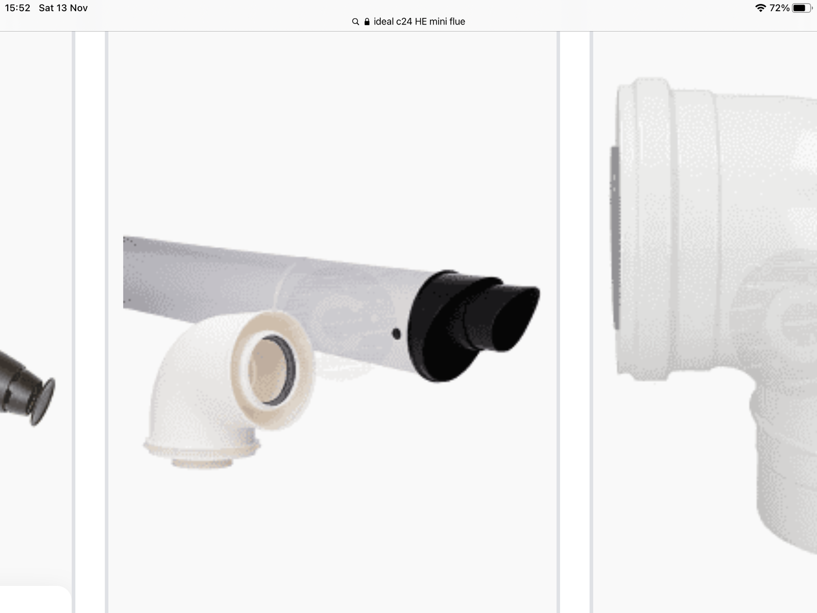

screen grab show picture of flue that is proper for the logic and Vogue

The number on the boiler is 47-348-38.

@ DP, where did you get the exploded flue diagram, I use the free boiler manuals site too, great resource, never seen those though. Bet it's staring me right in the face. :whistle:
Google searched the boiler installation manual and then the flue for that boiler
Screen grabbed Mr Central Heating offering for said boiler flue
