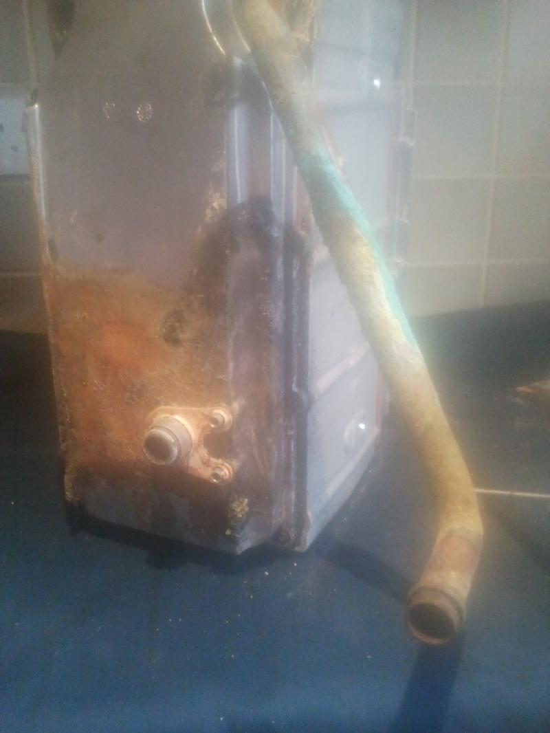

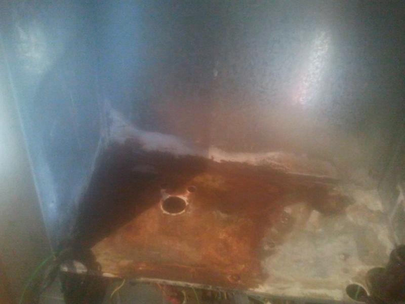

Check the thermistor is clipped to the pipe properly and that it's not corroded/damaged etc... If the PCB sees the overheat stat is reading 90C but the thermistor is reading below 70C it assumes there's a software fault thus giving LE.
I had this just a couple of weeks ago. The heat ex had leaked condensate water onto the thermistor which meant it didn't go out of range but it did give an inaccurate reading, tricking the PCB into thinking that itself was faulty!
This is the offending Isar piece of s**t
I've never seen LE be anything other than a PCB or, rarely, this.
What else can LE be?
