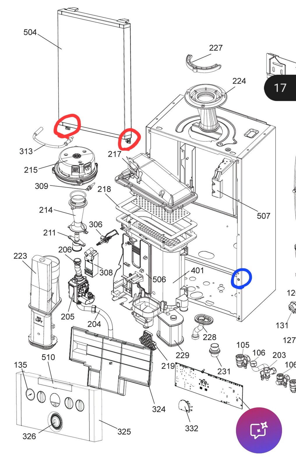

I have an Ideal Atlantic 35W boiler, which although new in 2022 wasn’t fitted with a thermostat. I’d now like to fit an app based one.
Ideal Heating say I need a Halo Combi Thermostat 222142 and a Smart Interface 227156. I assume that’s their own kit and I wonder how it compares to Hive/Nest/Tado?
What would I need to get if I didn’t want to use the Halo one? Thanks
Thanks. I was worried that Atlantic wouldn’t be compatible because I read it was a basic boiler but the manual mentions Opentherm so I’m guessing it is. I’ll look at all the reviews.
Unlike many modern boilers, the wiring of the Ideal can be accessed from behind the control panel, without having to remove the boilers front panel.
This allows a competent DIY'er to install a stat without needing an RGI to check it afterwards.
It also supports OpenTherm, so you can benefit from better control of the modulation, without being stuck with a Halo.
