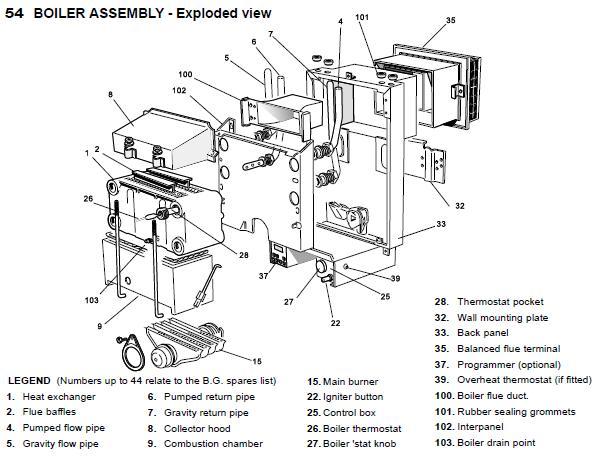

I have attached an exploded view of the boiler basically the BG engineer came to the conclusion that at the point where the boiler thermostat enters the heat exchanger, this is clogged with scale/sludge and hence the thermostat cannot sense the boiling water in the heat exchanger.

- Have someone replace the thermostat and heat exchanger if necessary.
I notice to heat exchanger has a drain plug on it - to what extent can I open the casing of the boiler and drain this myself? (I'm not a CORGI registered, so my gut feeling is that I can't do anything to the boiler).

I may be misusing the term pumping over. In normal operation there is no water flow into the feed/expansion tank. When the boiler boils over, there is a sudden gush of boiling water/steam into the expansion tank, and it is this that the British Gas engineer believed was caused by a blocked heat exchanger. He seemed to think that the thermostat capillary tube could have been blocked/scaled up, which was preventing it from detecting the temperature in the heat exchanger, if this makes sense?

Alistair, It does after all sound like a temp related problem and I guess the only way to prove it is to drain and remove the heat exchanger and investigate further. It may well be a localised blockage but very hard to pinpoint exactly where. There's a good 3 hours work to remove and replace one of those exchangers. Depending on the findings it may not be economical to repair your boiler. £5.5k is rather high, but of course we don't know what the quote contains. It does sound like the system is clean and if all you need is a boiler replacement then £2k is about what a privateer would charge.

It is possible that the thermostat is broken (I don't think anyone else has suggested this) maybe I've missed something that has ruled out the 'stat.
I was thinking that. I have seen it before.
