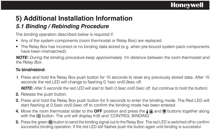

You've got a working Isar!? That's a novelty...although an L-code with heating is a bit suspicious, it might be about to revert to the standard Isar condition of "broken". Is it definitely just a continuous L, or does it alternate between L and another letter/number?
What make/model programmer do you have? If you don't know, can you take a picture of it, and also of the receiver by the boiler, and post them here?

The Thermostat is a Honeywell CM921 Wireless 1 Day Programmable Room Thermostat
Sorry for initial confusion and hope this helps?
The Receiver (see photo) says Sundial Systems on it?
Receiver needs re-binding. Turn control stat to off. Press and hold the button on the receiver until it flashes once per second, then release your finger. Then hold down the up and down arrows at the same time on the stat, and press the back button all at the same time. This is Inst mode. Then press ok after 10 seconds
Then turn it to on and put temp up and green light should be on and no red light. Follow that to the word and that will fix your problem

Don't take the batteries out of the programmer, that'll just confuse things - it won't make it turn off, it'll just leave the receiver in the last mode it was told to be in, and eventually make it lose its binding information. If the last signal said "turn on" then it'll stay turned on

@muggles @Alex10 :cool: Many thanks to you both - the information you supplied was very helpful in re-binding the Thermostat to Receiver. I have repeated the steps given, everything flashed and came on when it should(y). Unfortunately, the heating is still on and won't turn off:eek:(n). Hence, I need to contact a local heating engineer to see if they can help and won't charge me too much:rolleyes:!
