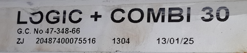

Have a Ideal Logic 30 (Combi Boiler) with "PCB Fault" on screen (photo below).
No hot water for anything.
Manual gives no indication.
Photo of serial number below.
Anyone ideas?
I gather the "1304" means it was manufactured in 2013 on the 4th week of the year.

Thanks for your help guys
Phoned Ideal; was difficult getting through but got there eventually.
Spoke with Ideal engineer.
He said is there is no commonly known part on the PCB that fails.
He suggested re-cycling the power at the wall. He said it can be an incoming power supply problem. I phoned the guys in the flat afterwards, they did that, and everything now all good. The fault has cleared and they have hot water again.

PCB Part number = 175939 (yours may be different)
and that there is an additional part called a "chip card" that is plugged into the PCB which controls output and that for a model "30" with serial number beginning "ZJ" the chip card
Chip card Part number = 176403.
