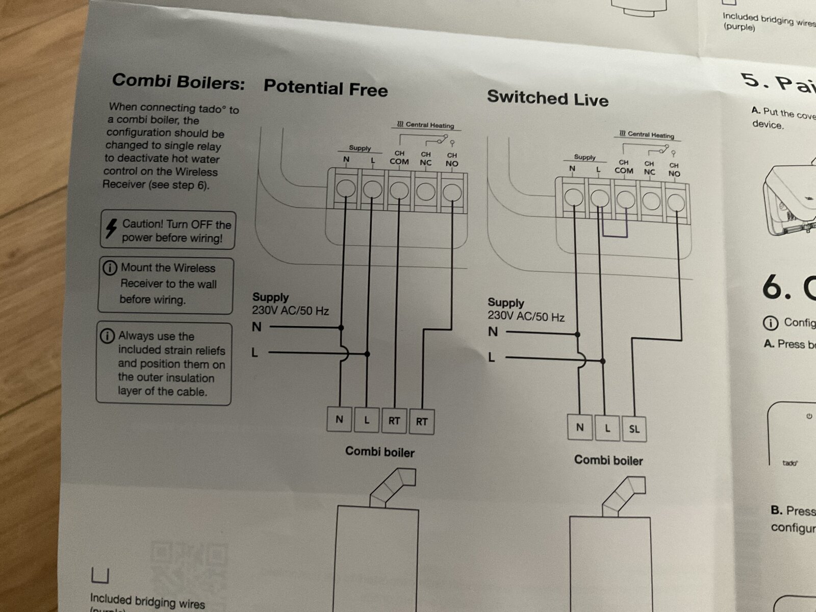

Hi I have a logic esp1 30 and trying to connect a Tado smart thermostat to it but can’t work out if this boiler is potential free or switched live, had A look at the wiring diagrams and I think it is switched live but Tado support can take 2-3 days to reply, I wired it up as potential free into the boiler stat terminals as diagram A and CH com and CH no
but the boiler won’t fire for heating so asking if anyone on here can help before I do anything else

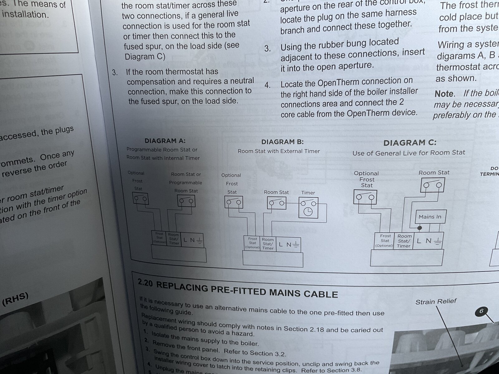

The answer is in the diagram you posted.
One side of the room stat is connected to 230V L shown in red.
When the room stat calls for heat the same 230V L is applied through the room thermostat to the 'Room Stat / Timer' terminal, so it is 230V and not voltage free as you correctly figured.
Probably the easiest way is to connect it is to wire the two Room Stat / Timer terminals directly to CH COM and CH NO. Plus of course the 230V to N and L for its operating power. [One of the 'Room Stat / Timer' terminals will be a permanent L anyway and the other the switched live - unfortunately Ideal don't make it obvious which terminal is which] Do it this way and it doesn't matter which way around the terminals are connected. Do it as per diagram C and it does matter which of the two 'Room Stat / Timer' terminals are used.

No, you didn't understand correctly. My reference to the wiring link was to explain how your boiler was controlled using 230V mains. My apologies for confusing you. My suggestion for the wiring was:
CH COM goes to one of the Room Stat / Timer terminals
CH NO goes to the other Room Stat / Timer terminal
Which is what the last diagram I posted shows and exactly what TADO have said.
Add of course the mains 230V supply to N & L
If your boiler has some inbuilt time control, you will of course need to set it to be permanently 'on' otherwise it will stop the TADO working. Although the Salus it replaces could have been the programmable version that doesn't need a separate timer.
