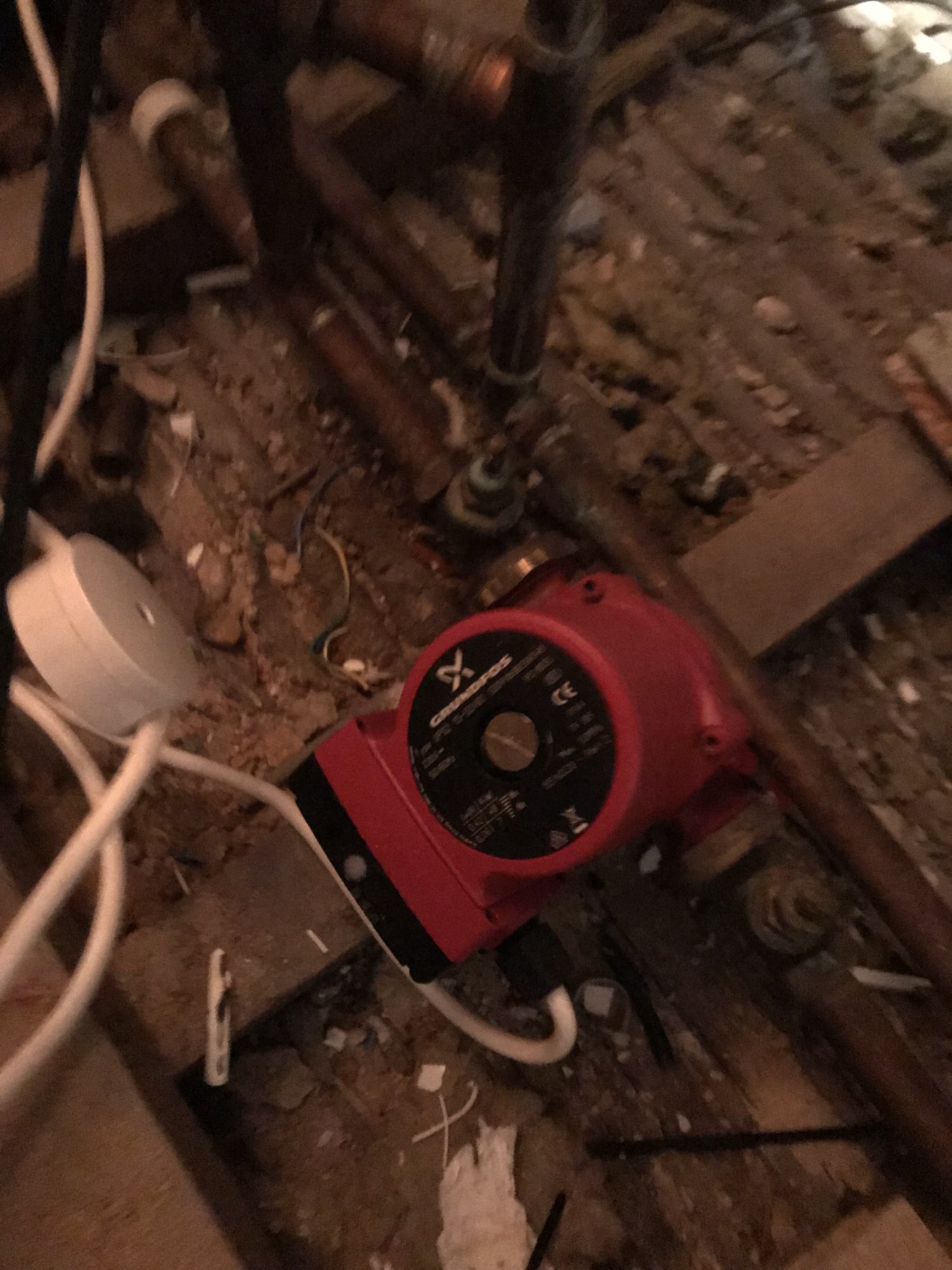

Hi All,

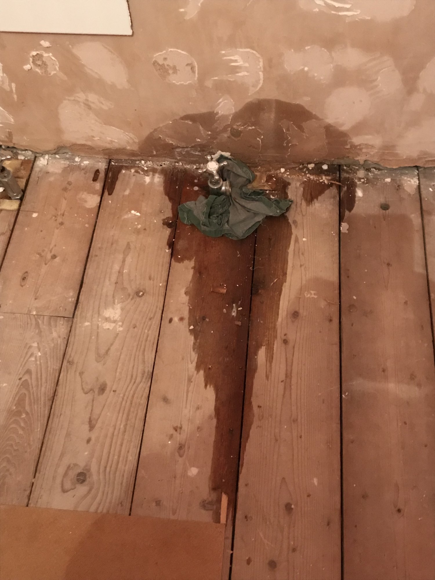

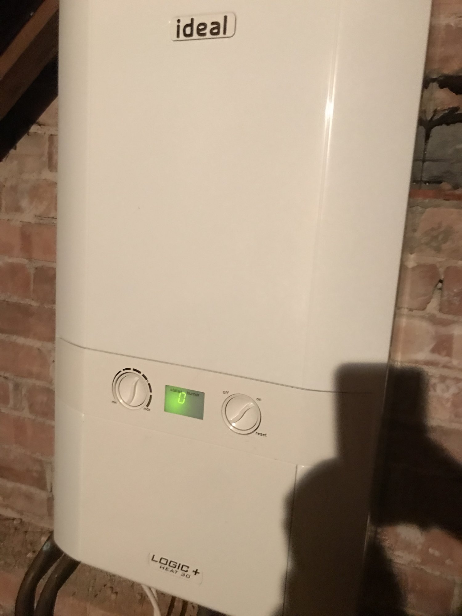

I’ve got Ideal Logic+ Heat Only Boiler system, we are in the middle of refurbishment and the bathroom has just been gutted. Since this the boiler is coming up with a error, FD - No water flow/pressure I believe.

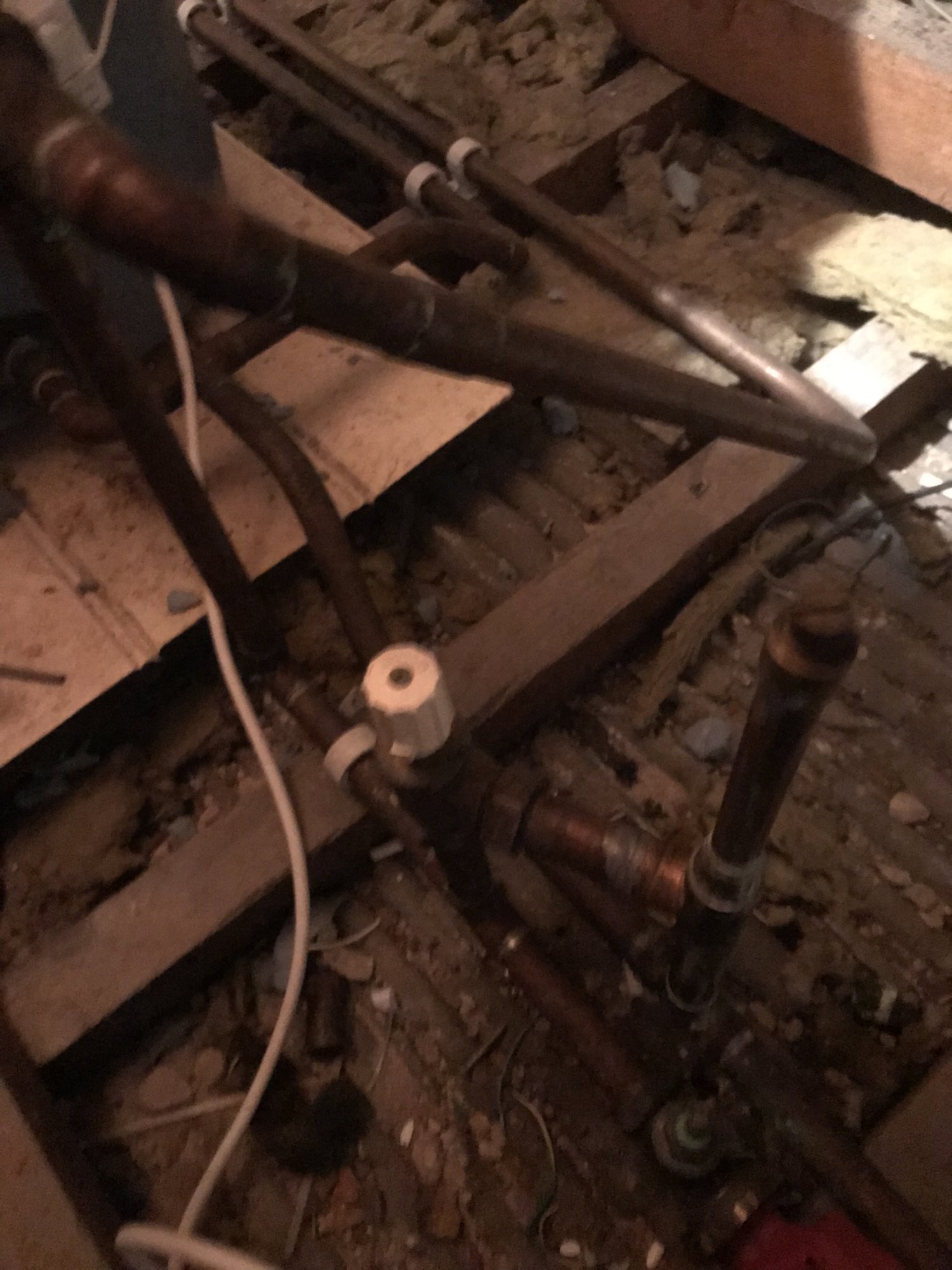

It seems one of the trvs on rad that was removed has been leaking, it’s now been tightened up but I’m under the impression the boiler needs topping up and maybe air lock removing, not sure of what to do. Hope the pics help.
TRVs need capping with either decorator cap in place of the head or with blanking cap on the valve as they tend to let by.
Edit: your pump is incorrectly oriented too.
