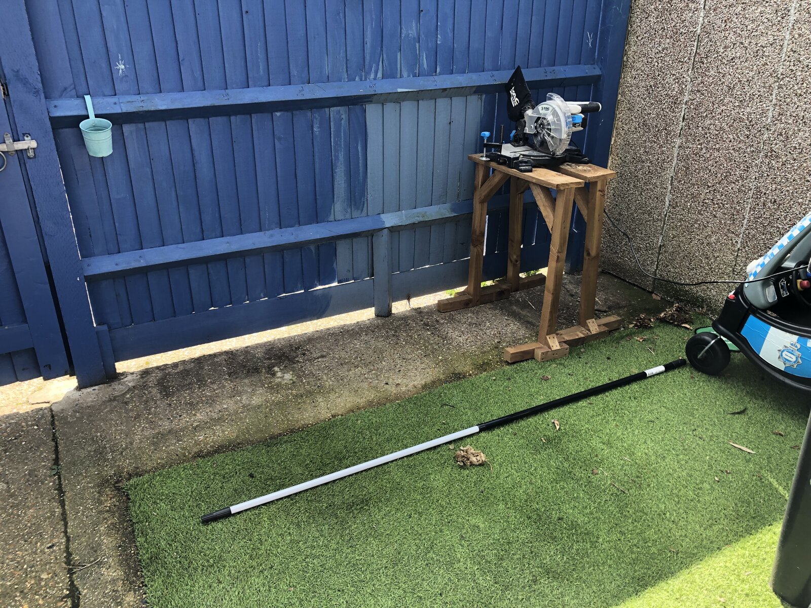

Hello
so picture below shows the gap, and rough layout of the shed, the rest of the area is 8ft x 12ft where I can use this as an outdoor workshop. The shed/storage/work shop will be 78inch wide, 6ft high and 3ft depth.
the gap underneath is essential if no cap, the water run off puddles…
is it slopping towards the fence and whats beyond the fence ??
yeah, there is a slight slop, I live on a hill, but the bit of the hill I live on has been cut out, so I live on a wedge removed area of a hill, but its all slightly slopped so water runs and doesn't puddle.
The area underneath the grass, is actually a car port, and behind the fence, is a drive away type area, where it leads to people garages or car ports. which again is slightly slopped, and is a big space, room for 15 car ports or garages + turn around space.
ok i think i am misunderstanding this ???
its not house to fence roofed shed just an area 3x6ft under a carport type structure near the fence ???
