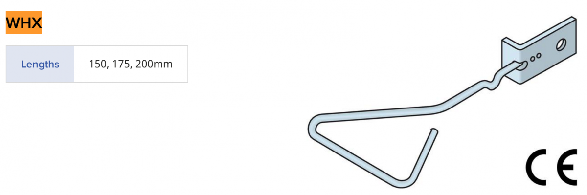

Fish tail ties on edge, or a vertical timber on the edge of the new blockwork so that you can fix to the new blockwork and the existing wall.
Like the idea of a vertical timber fixed to the new block edge and the existing wall.
Cheers
So the wire bit of the tie goes in the mortar joint and the plate bit screws onto the existing wall?
Yes the plate bit onto the corner, so hook the right angle on and screw to the face of the wall then mortar in the wire
