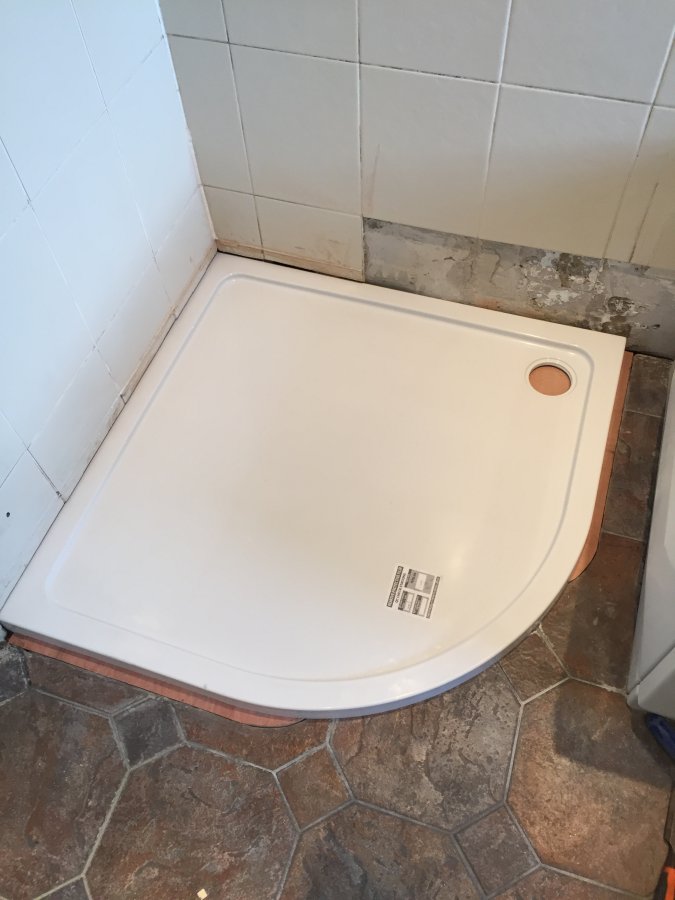

just replaced a defective pentangle shower tray with a stone resin quadrant tray 1000x1000mm (radius 550mm).
The old tray was fitted butted against the tiles (which went to the floor), and not underneath them, so it leaked.
I have cut away tiles so that new tray slides underneath.
I now have to deal with exposed floor ply to left and right of tray where it doesn't cover the outline of the old tray.
Customer wants a white trim but it needs to be about an inch wide and has to 'form' around the radius of the tray.
I have a couple of ideas but this involves layers to build up the thickness.
Any of you good ppl have any suggestions or know of a bendy strip that will do this in one application?
Many thanks, photo below...
