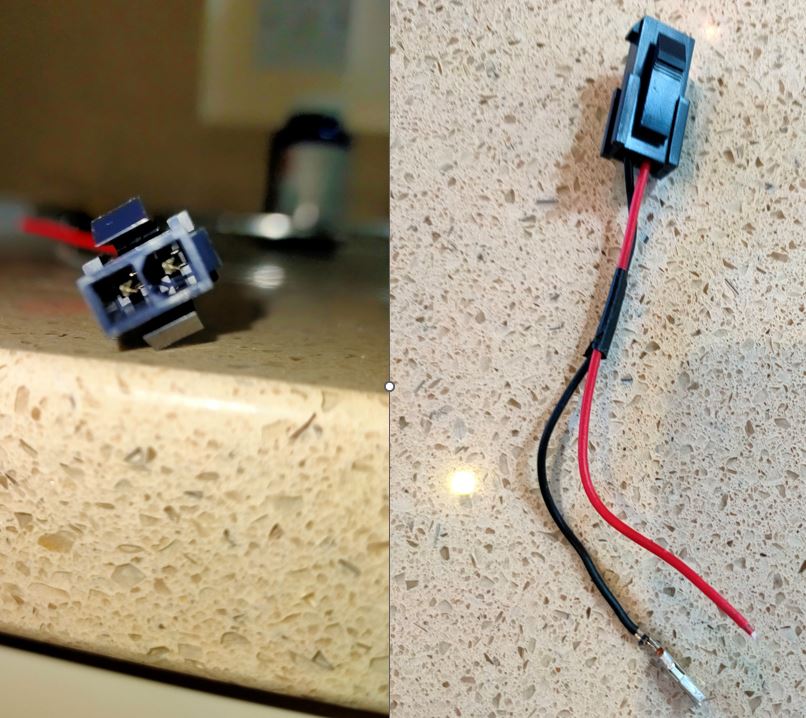

Hi all,
I urgently need to replcae this connector, which connects the fan on a icemaker in my Beko fridge. Please can someone with the knowledge tell me what it is so I can go find one, many thanks. It has short wires ending in a small diameter circular crimp connector.
does the end with the crimp connector push on to a pin on a board? And did the red cable have a crimp terminal like the black cable? A pic of the terminals that it used to be connected to would help. There a hundreds of circular crimp connectors!
There are hundreds of similar types..
Are you just wanting to replace the single missing contact, or the whole thing? The contacts are usually sold separately.
If it's the whole thing, you'll need to know;
The EXACT dimensions, especially the distance between the pins. Some are metric, some imperial, and the 0.1 inch imperial is 2.54mm which looks nearly identical to the metric 3.0mm!
The shape and size of the pins
The shape(s) of the pin housings. Notice that one is square and one isn't
The type and position of the latch mechanism.
This is similar but not quite right https://uk.rs-online.com/web/p/wire-housings-plugs/2332804
If you look through here, there are loads https://uk.rs-online.com/web/c/conn...ngs-plugs/?pn=1&applied-dimensions=4294882771
if it does push on to a pin on a cct board could you just solder the wire directly to the pin?
